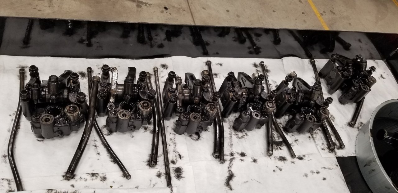

    Does anyone have a push tube straightener I can barrow?:D
    Every wrench I know loves looking at carnage from failures. Share some of your photos of failures here for all to see.

  3. daf105paccar
    6,564
    7,294
    Apr 15, 2012
    What engine was that?

  5. Goodysnap
    Goodysnap Road Train Member
    3,818
    9,310
    Jul 12, 2017
    That is a MX13 EPA13- 520K miles
    Anyone want to comment on the root cause of this failure?
  6. spsauerland
    spsauerland Road Train Member
    4,296
    10,892
    May 31, 2010
    West Harrison, In
    I am guessing RPM was north of 3,000 RPM.
  7. daf105paccar
    6,564
    7,294
    Apr 15, 2012
    Circumstances off the failure?
    (truck parked? driving? going downhill? )

  9. jason6541
    jason6541 Road Train Member
    2,425
    5,368
    Mar 5, 2012
    Omaha, NE
    #### I put a million miles on my Paccar without a hiccup. Over revved or overhead was just done and done improperly
  10. Goodysnap
    3,818
    9,310
    Jul 12, 2017
    I wish I knew. I would say your closest guess is "downhill". I will tell you that all injector tips are in-tact and there is no evidence of oil in the CAC/plumbing.
    My write up stated- Engine cranks but will not start and the unit was towed in of course.
    I find when these things happen more often than not people tend to play dumb.
