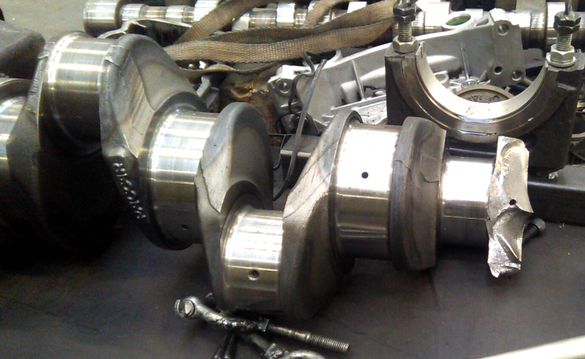

    I don't know the history of this. I saw it at the truck shop where I go for dyno testing.

    Just in case anyone didnt notice it on @KVB s post.... paccar doesnt use any counterweights on the crank.

    Pushbroom: Is there a reason for no counter weights? Pistons must be featherweight?

    Less rotating mass. Flywheel is a bit heavier to make up for it. Paccars rev quick because of it

    I thought the purpose of the counterweight is to offset the weight of the swinging rods and up and down motion of the pistons?

    Well considering they have been doing it for quite a while with no issues.....
    More then one way to skin a cat.
    If you really wanna get worked up the new camshafts are hollow tubes with pressed on lobes:)

    SDP that had a recent rebuild. Determined there was an abnormally in the rod which fractured in two starting from the oil feed hole. New long block and back together.
