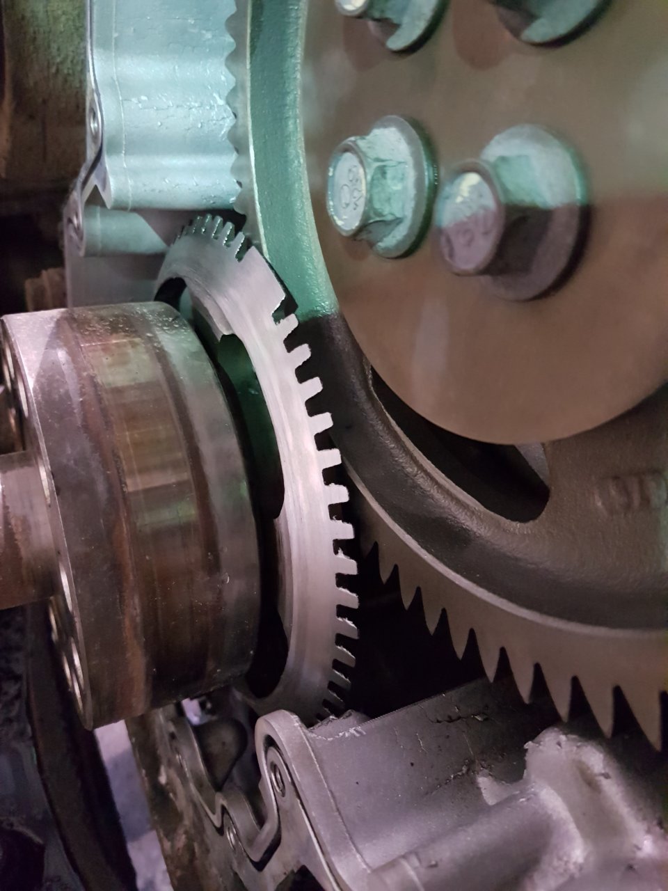

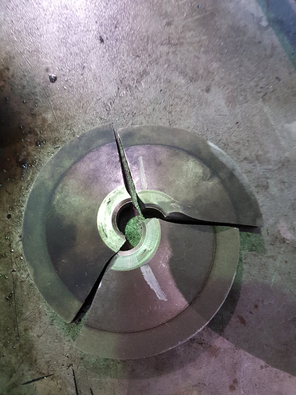

    Old style injector gear washer split and fell down into the tone wheel of the crank shaving it to a point. Tone wheel suprisingly still read so new washer and off to the auction. I got called out to cut one hole on it, came in for pressurizing. Only reason they found out the front washer had split.
    We always cut all 6 holes, however in this case customer wanted to patch and signed a paper indicating so. Had to cut the hole extra deep to get it level with the others.

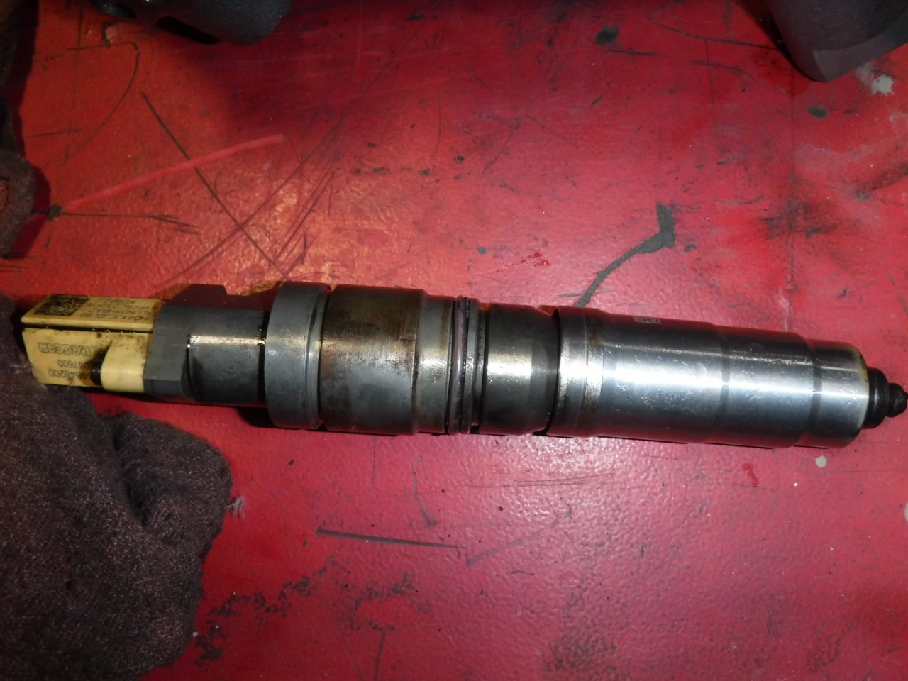

    Definate possibility with the tip blown off.
    What else is wrong? You will likely not know this unless you are familiar with the engine.

    I see what looks like burn marks on the body, near the tip. Injector seats leaking?

    The cup is on the injector and is supposed to stay with the head.
