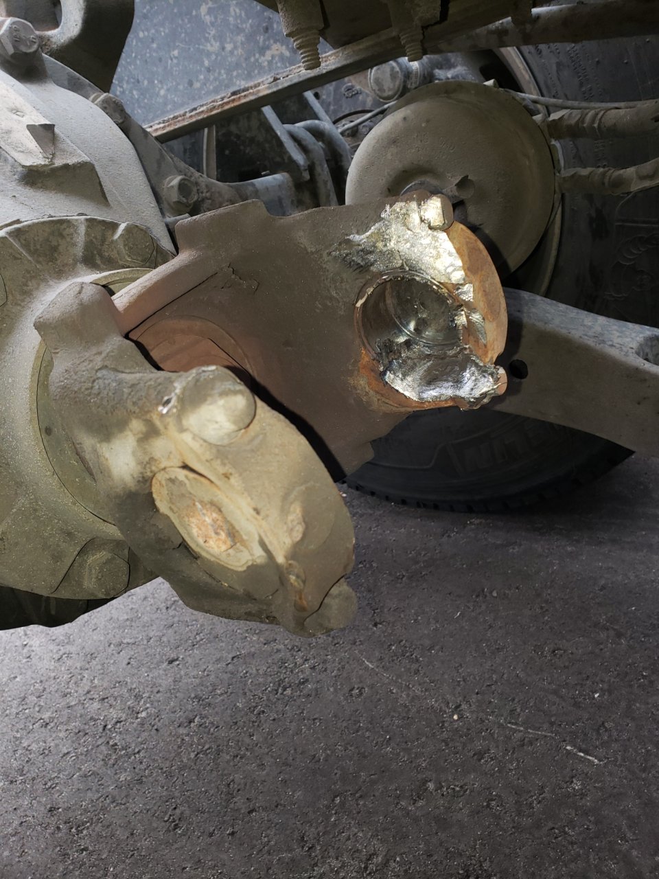

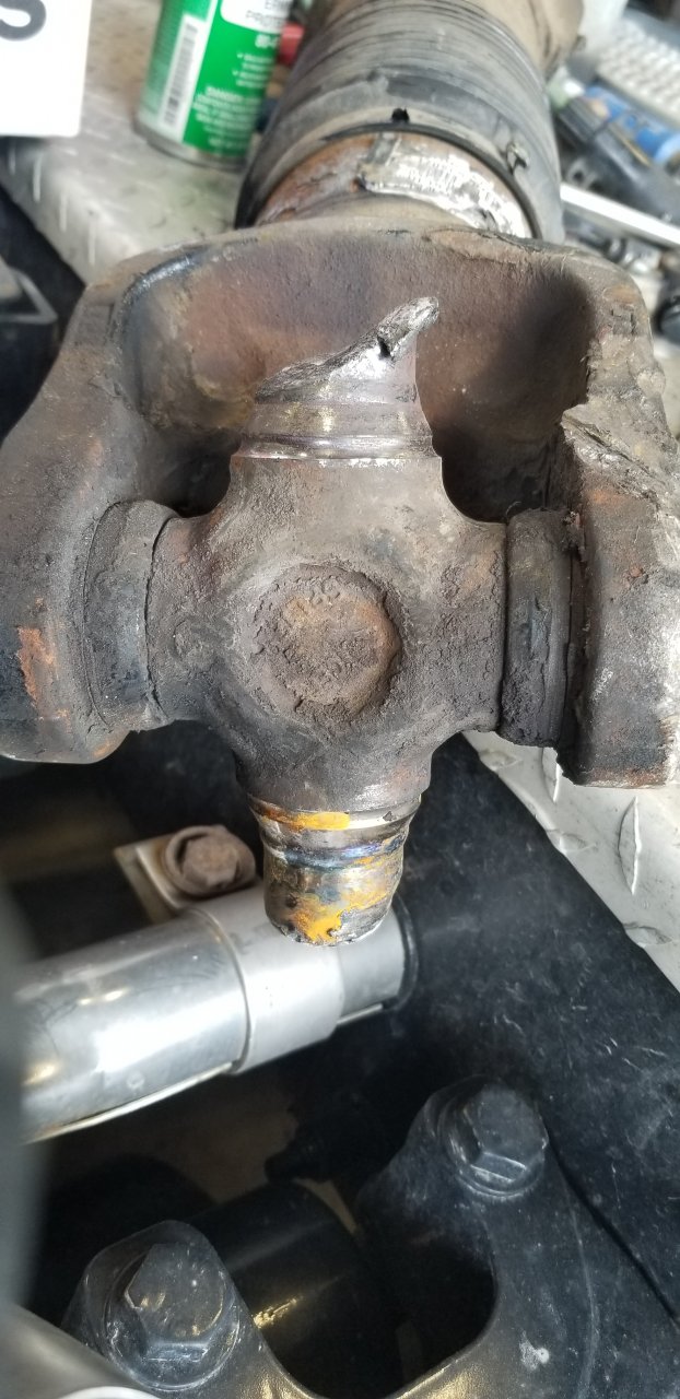

    For you young bucks this is what happens when you skip greasing a u-joint during a PM.
    Make the driver wish he brought a clean pair of draws with him on this day. :eek: 20200529_075943_resized.jpg 20200604_090041.jpg
  5. AModelCat
    29,759
    165,342
    Yup. Somewhere in the woods at the bottom of highway 63 in Alberta there's part of an interaxle shaft out of a Western Star vac truck. It exited the truck and was never found. Bye bye yokes, air bags and other parts.

  6. 062
    062 Road Train Member
    6,351
    34,023
    Oct 20, 2013
    Driver felt that for awhile. If it was ignored or ignorance is the question.

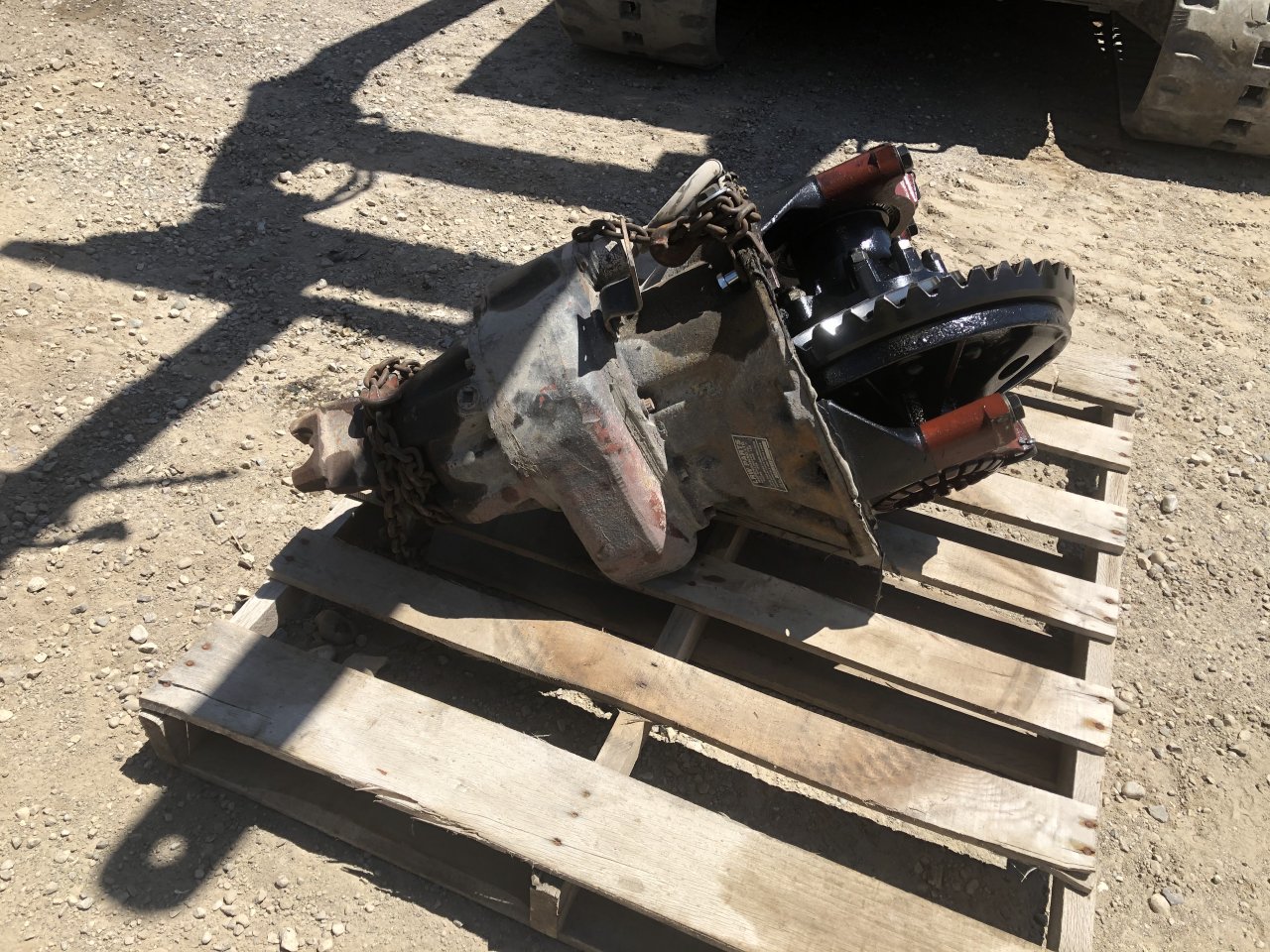

    While this doesn’t show broken pieces, (it’s inside the power divider unit) the driver was going up hill with a loaded dump truck. o_O
    Shifted a gear and boom. Something broke. :eek:
    What’s :mad: my boss is that this is the second time the unit has been out since it was rebuilt last fall after breaking.
    We do not know yet whether this is driver error (only 2 weeks of driving since getting his license) or the abuse the previous driver did to this truck last year.
    Previous driver only worked spring, summer and fall with our company before getting fired for wrecking dump truck parts.

    90% of trans and diff failures I see are either shock load or running out of lubricant due to lack of Preventative maintenance.

    Goodysnap: at least this time the diff had clean 8 months old oil.
    So we’ll put this as driver abuse.
    Unless the 425 3406B is too powerful to be a dump truck engine.
    Uses a 15 speed tranny.
