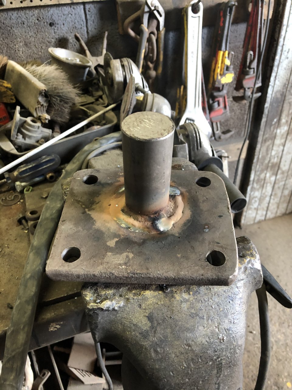

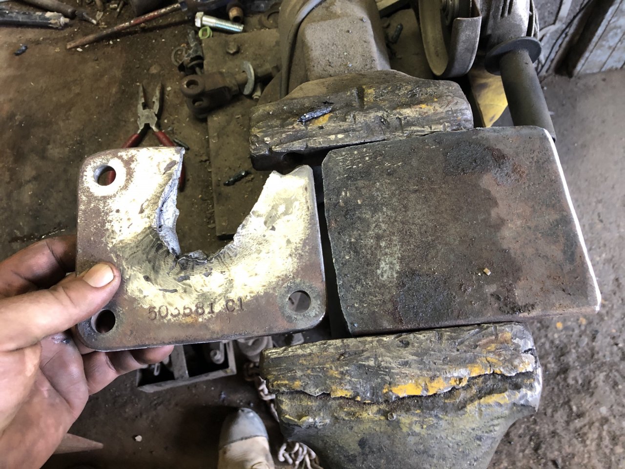

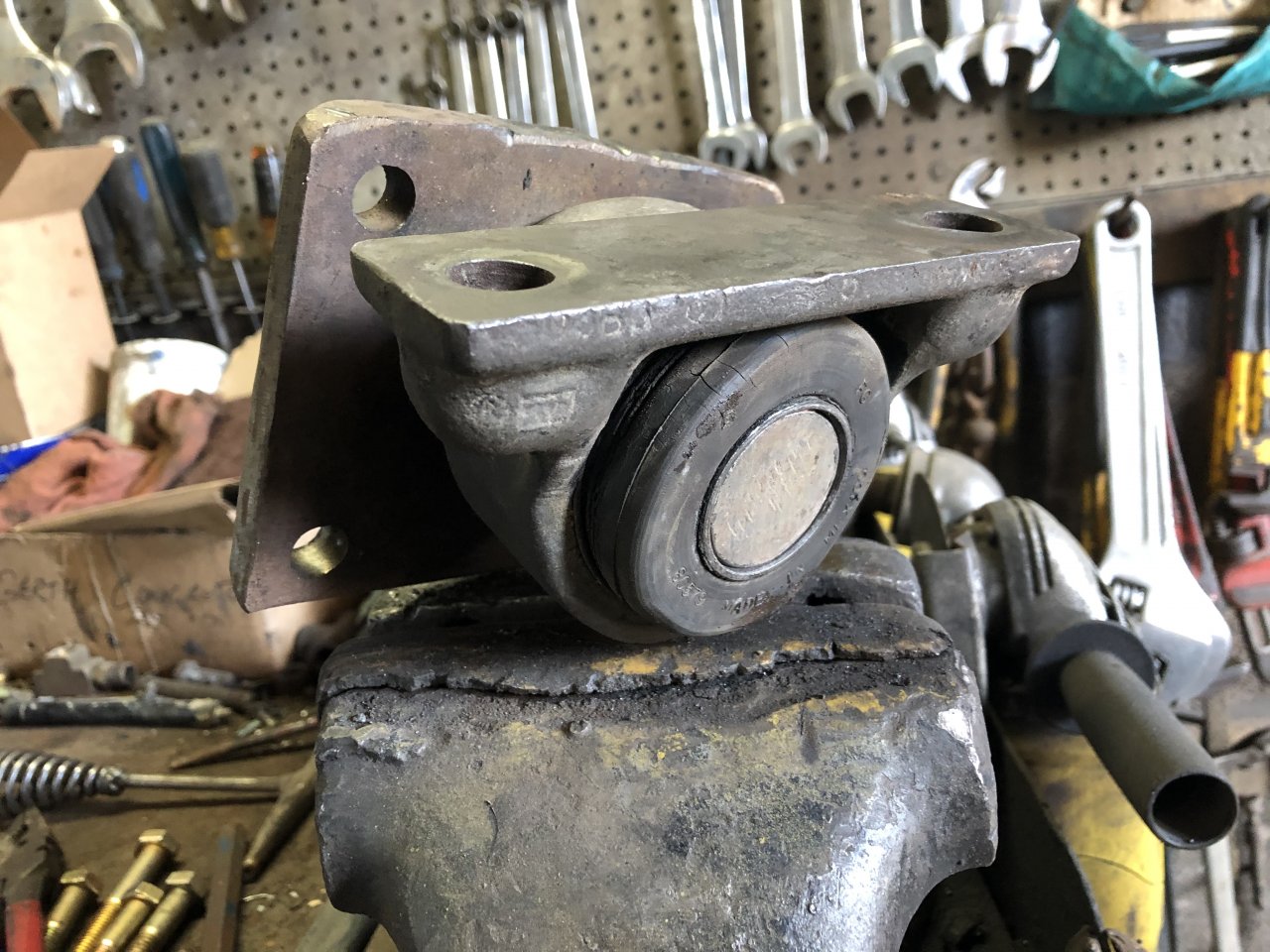

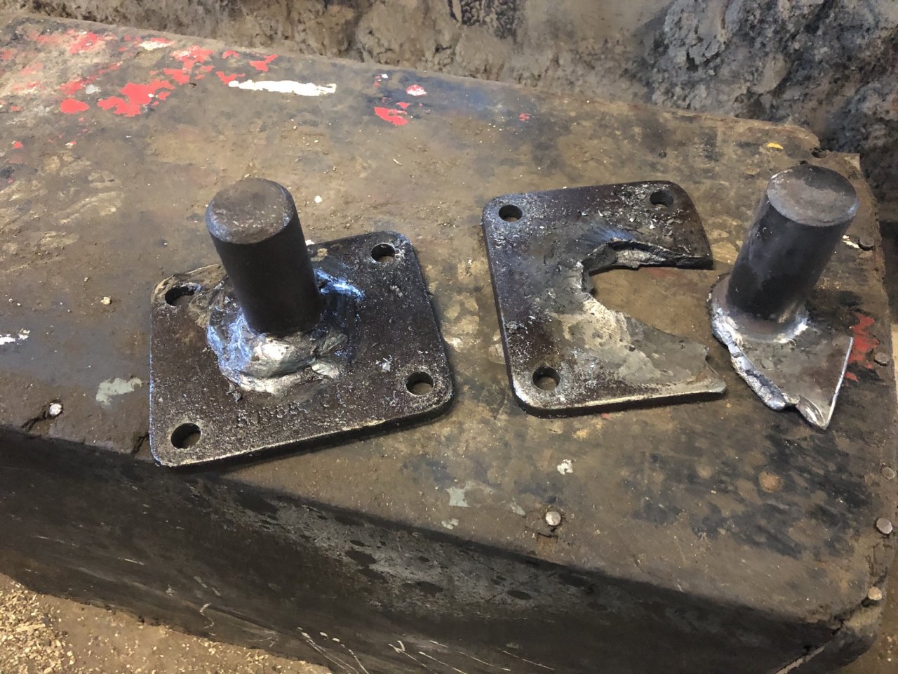

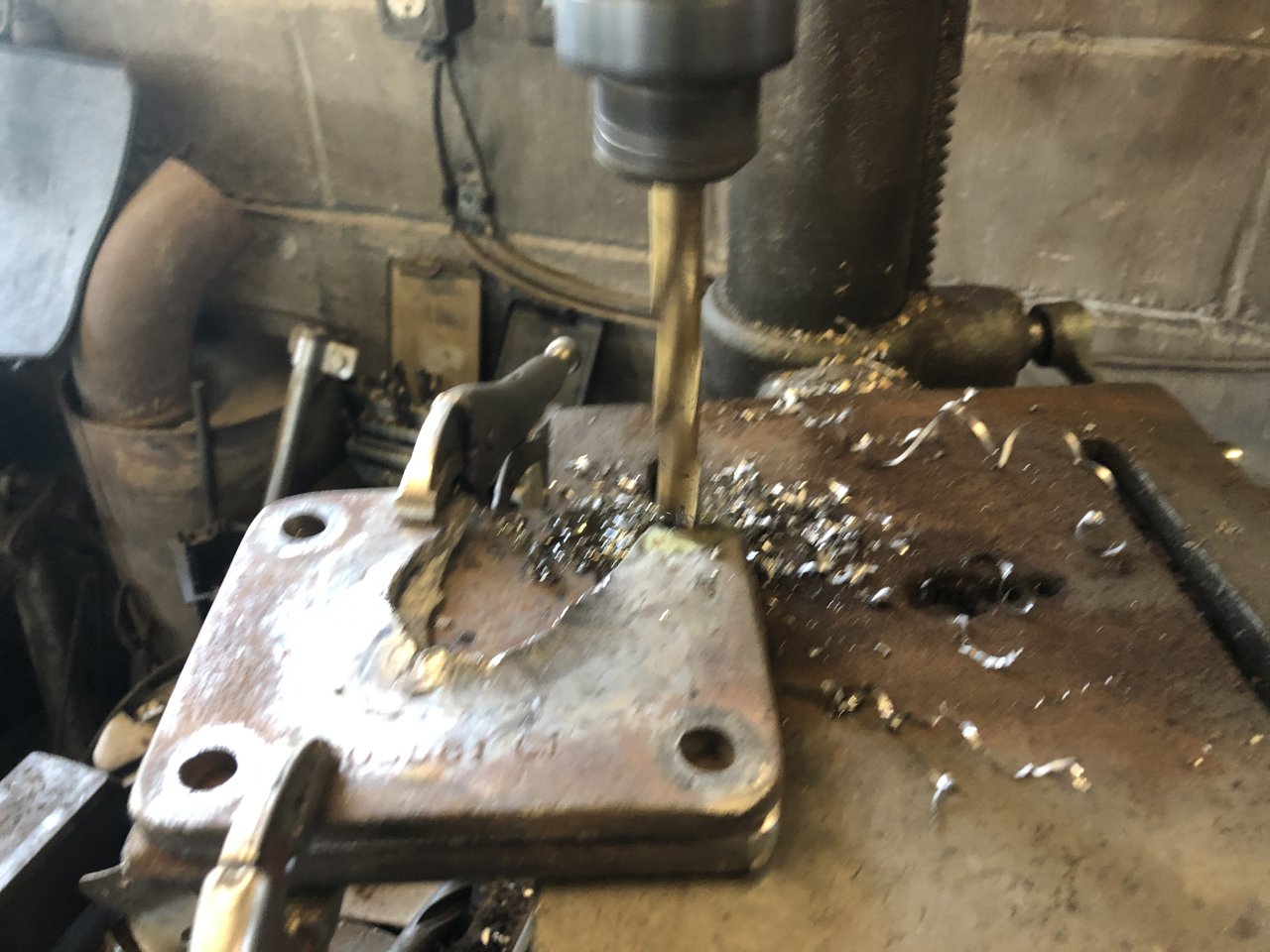

    Well, the international dump truck returns to the shop. Welded engine mount broke. Engine flops down in the frame rail and lands on the bottom part of the rail.
    Clutch no longer works as the linkage is being pulled, keeping it released.
    Both mounts have been welded at a professional shop as it’s heat treated.
    First was the driver side, welded that one, got a few loads done, then passenger side breaks.
    Welded passenger side. Got 2 more loads, the driver side breaks again.

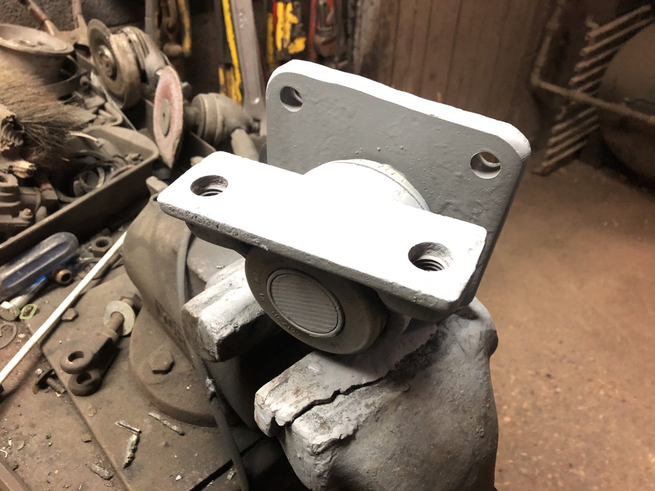

    That’s it. I’m making my own mounts.
    688BCE4D-A2D7-4879-A59E-AC4020497FEF.jpeg 9D2976D1-6DC7-4316-B55F-B286C212046E.jpeg DCC4B9BE-C655-41AF-8E5C-ECDD81BED2AC.jpeg D97633B1-6CAD-459C-955C-057AB31963A5.jpeg AF18A2CD-A33A-40F0-B799-DA3DB131875F.jpeg
    So far, this time I road tested the truck.
    I was not able to before because the truck was needed ASAP.
    Drove a hour. No issues, backed up a steep hill, worked the clutch and bump the throttle while the truck was loaded up with 21 metric tons of sand.
    No feel of play from the transmission, all good.
    Drove for the first time today hauling for a customer. Nothing broke. Finally.

    Heavier plate. I would double the thickness or as thick as you have room for.
    650cat425 and Shawn2130 Thank this.
  9. Shawn2130
    Shawn2130 Heavy Load Member
    896
    1,900
    Sep 20, 2015
    Southern Ontario
    The plates I used are thicker. I think 5/8 thick.
    The original mounts was around 1/2” thick or thinner.
    I was worried about going too thick and having clearance issues. But these fit perfectly. Holes were perfect. No modifications required. Just bolt in both the first time.
