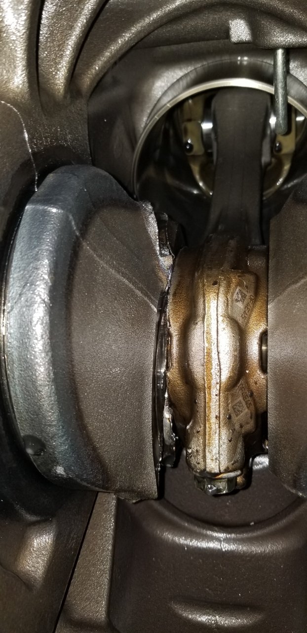

    Still running but bangin' pretty hard
    Broke in 2 places.....behind #2 Rod and Behind #3 Rod. #3 maincap bolts loose.

    That’s a Paccar engine

    Yes. MX13-17
    If it makes you feel any better we just finished a ISX15 in-frame. The main idler gear fell off the front geartrain. Yes as in all the bolts fell out!!!!! Broke half the rockers in two. 435K on the clock with no repair history and regular service's. Some things just happen and to that we say.......?????? Oh well. Fix what's in front of you and move on.
    This one pictured above will get a complete engine under warranty.
