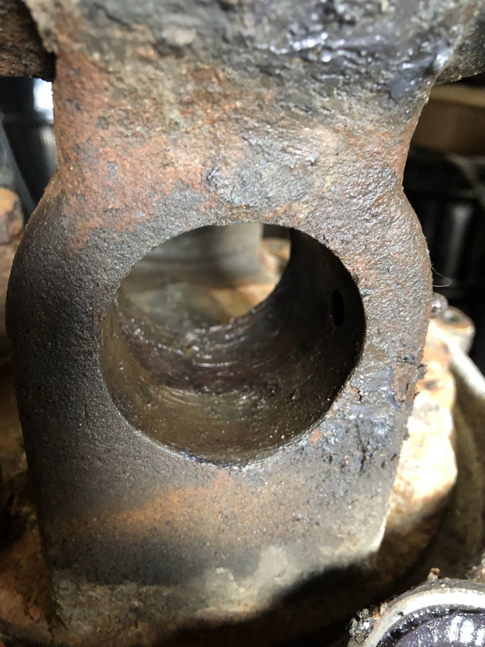

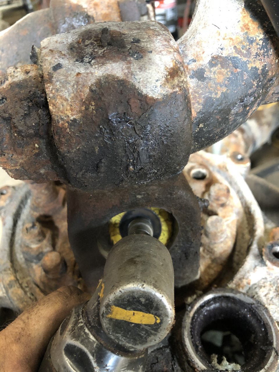

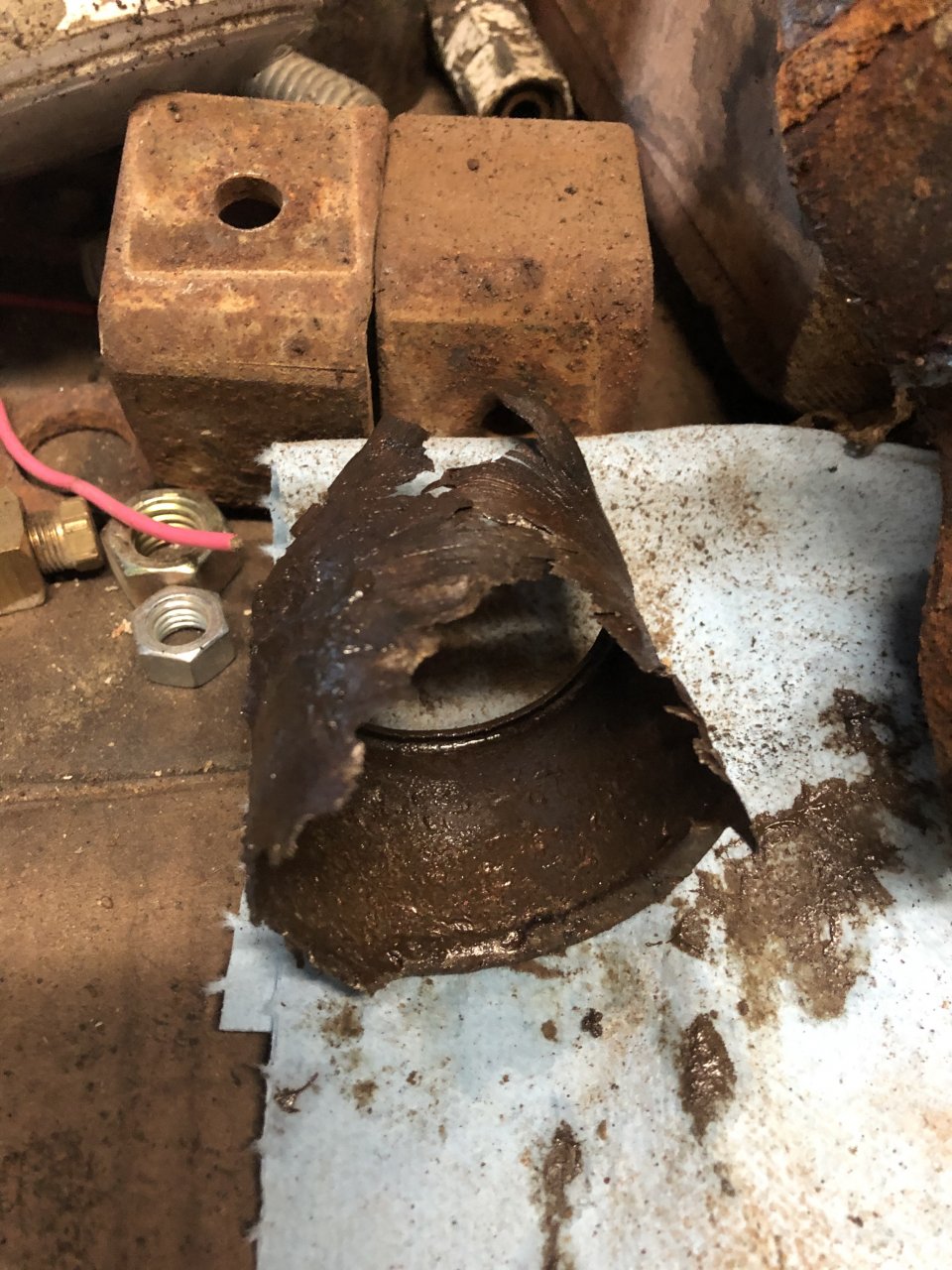

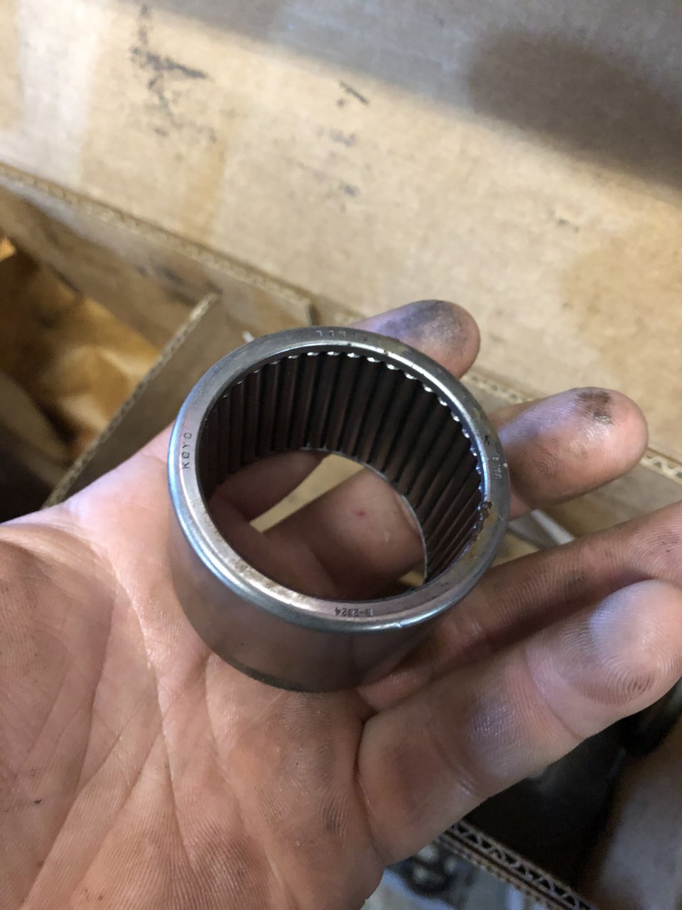

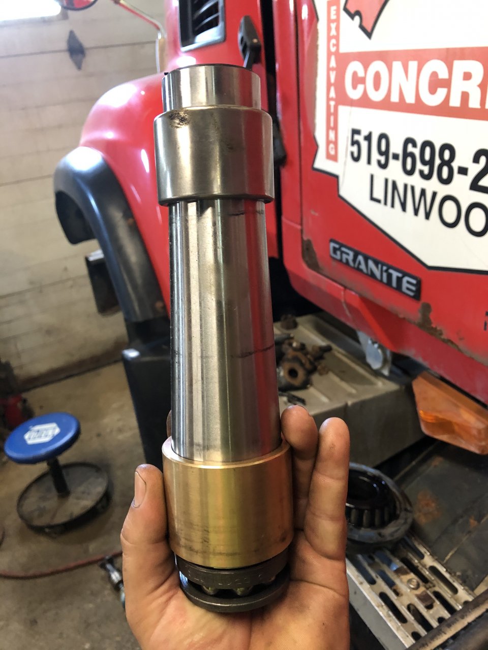

    The Mack dump truck came in for both front wheels looking like it’s squatting under a overload.
    After jacking up and using a pry bar, the wheels wobbled at the king pins....
    First picture is the destroyed needle bearing.
    Second is the new needle bearing and the third is the complete assembly.
    92F6A07F-471D-47A0-B149-341C0602BB48.jpeg 74652975-CB3E-4EB3-B763-C30CCD7A7B0E.jpeg 05374A52-238C-414D-AEB1-5E6D8AE96265.jpeg

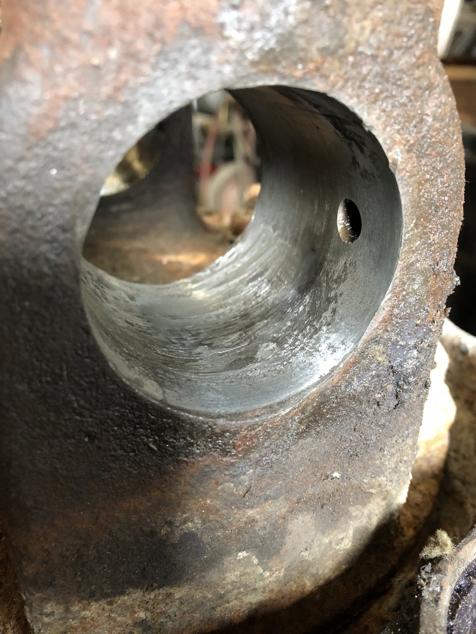

    The needle bearings ground themselves almost to powder size and gouged the bore pretty good.
    Some sanding and honing after, the new bearing fits nice and snug.

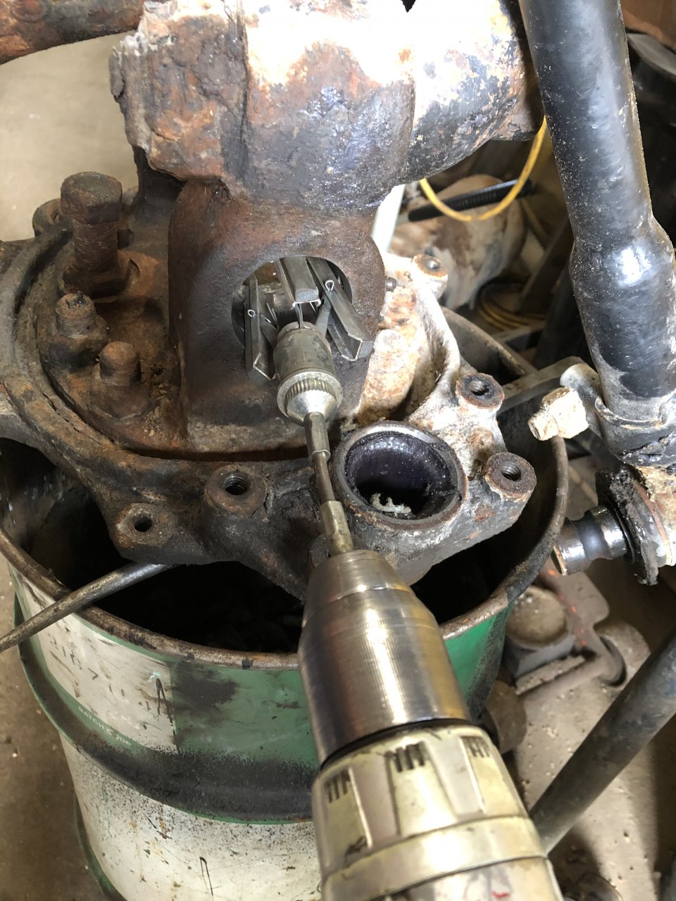

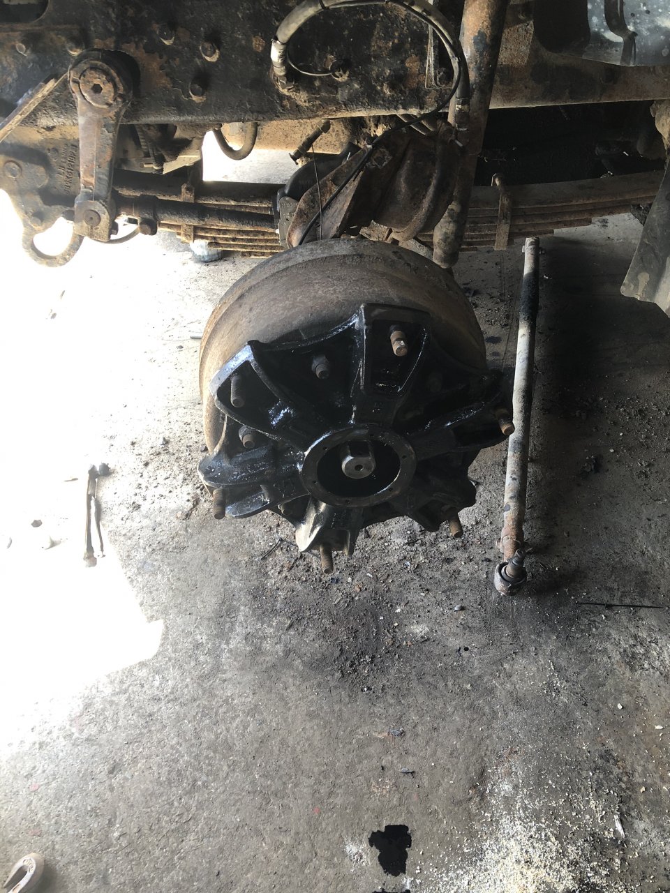

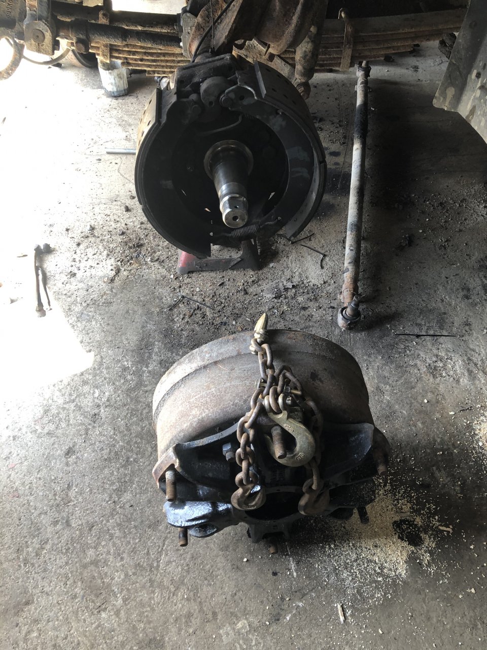

    Then some heavy lifting....
