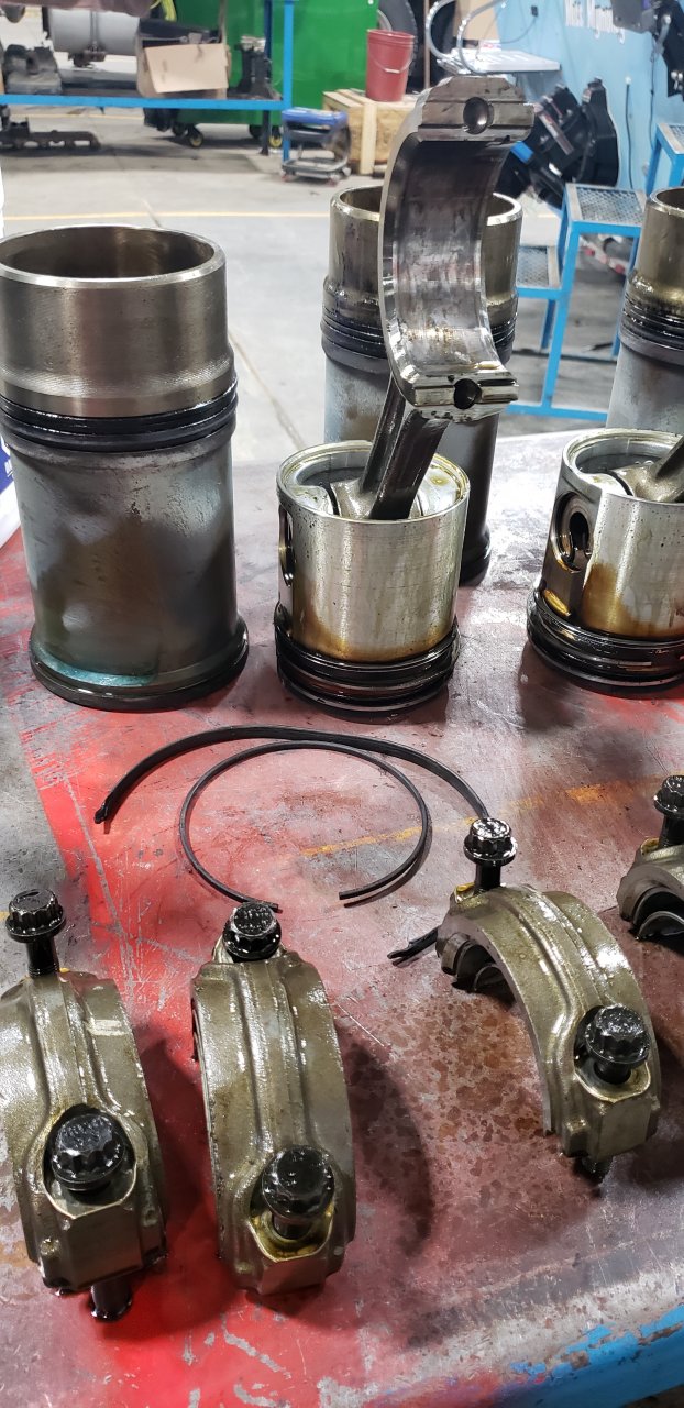

    We’ve had 2 MBE900’s taken apart. Both thrown into the scrap bin after it was determined it was too expensive to fix them.

    Looks like a Dt466. An older 1 if its a 2 valve.
    Here was the inside of ours...
    Broke a lifter retainer. This is a newer maxxforce Dt 20200916_065350.jpg 20200916_065350.jpg 20200916_065350.jpg 20200916_065710.jpg 20200916_065725.jpg

    Sure is. This is the lil brother of the 466 the 408.

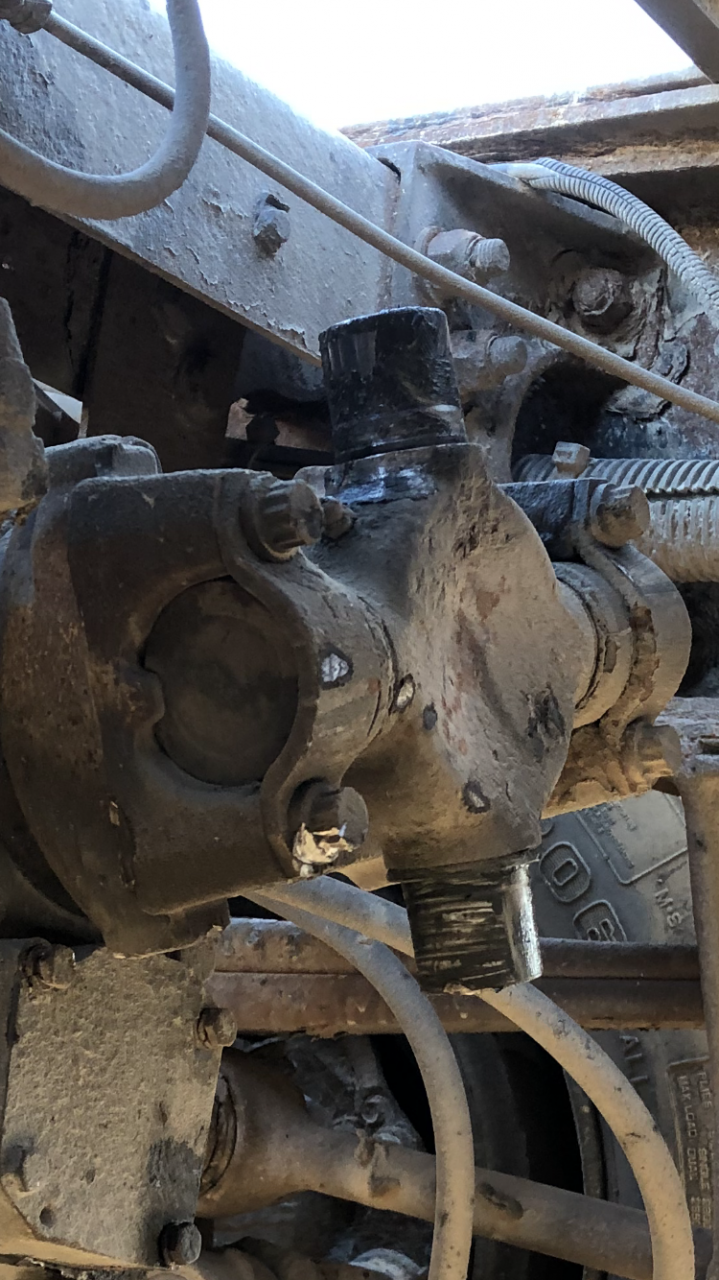

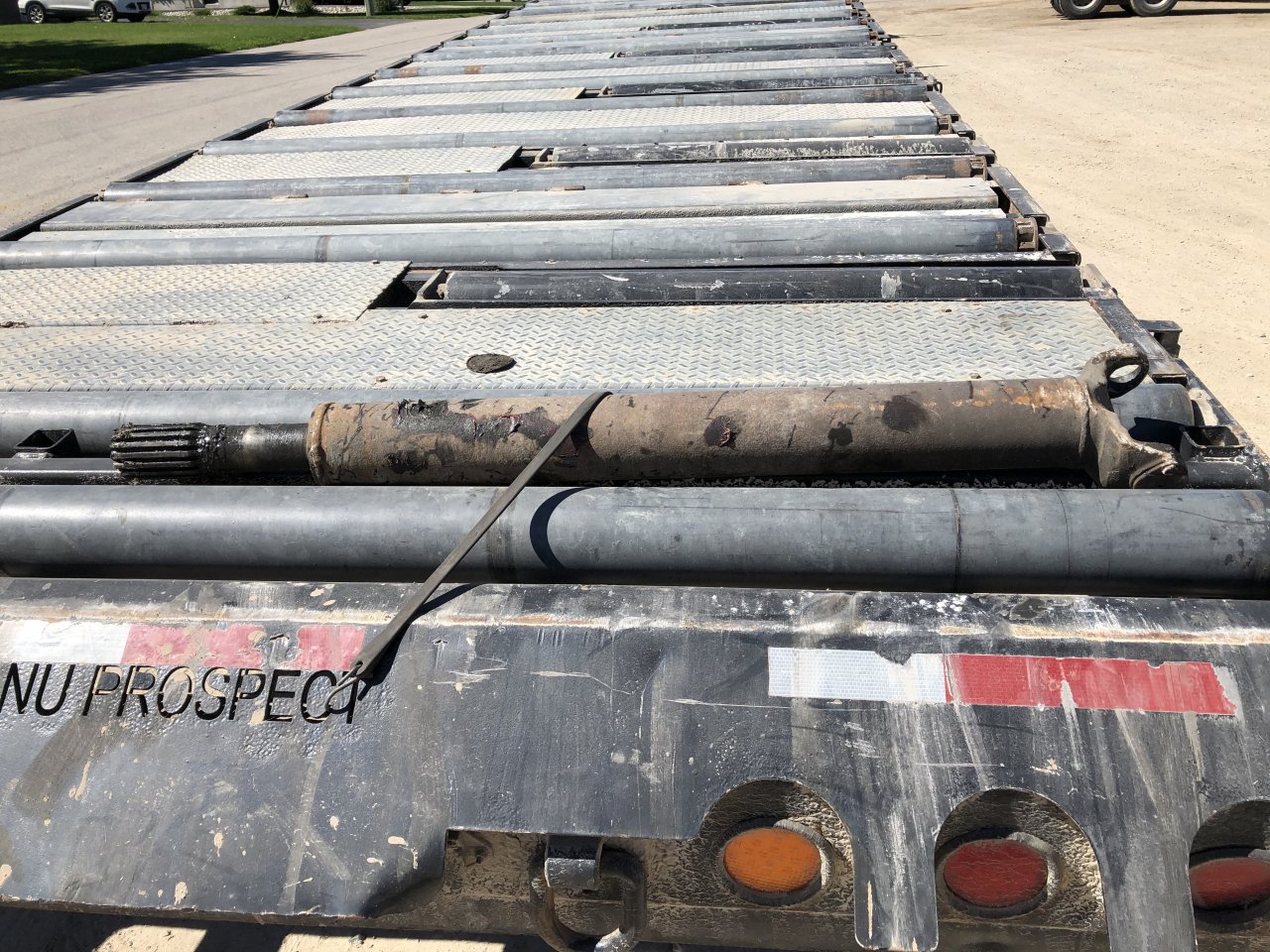

    I’m sure this was a huge click click boom....
    One of our employee’s truck dropped this while hauling a truss trailer.
    He said he was speeding up, shifting gears, then boom....
    Drive shaft rolling away....
    Was towed to our shop.
  8. AModelCat
    29,771
    165,483
    Looks like the same grease it left the factory with! :eek:
  9. Shawn2130
    Shawn2130 Heavy Load Member
    896
    1,900
    Sep 20, 2015
    Southern Ontario
    That U-joint is only 2 months old.
    Not sure what the guy did when he installed it in his Dad’s truck after the last one snapped.
    I’ll be inspecting it tomorrow. Apparently the 2 bolts came out and one cap flew away.
