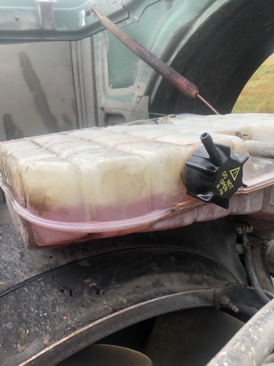

    Before I become apart of the click, click, boom thread, what would be causing my coolant tank of become over pressurized? I replace the relief cap, not overheating at all, not loosing coolant, just way over pressurized

    What engine? If its not blowing coolant out how do you know its over pressure?
    2 likely possibilities - air compressor or cylinder head gasket. Need more testing and by pass the air compressor to confirm the good or bad news. Air compressor being the good news. Head gasket failure can likely lead to overhaul real quick like.

    I’m sorry for the little information. It’s an ISX 2250, that I had to delete. The coolant only blows out of the relief cap. I’m not making oil, no white smoke out the stacks, and still runs just at normal operating temperature. Could the coolant tank have failed or is not not likely?

    Always bypass the compressor coolant first to be certain. More likely a dropped liner IMO. Sorry.....
