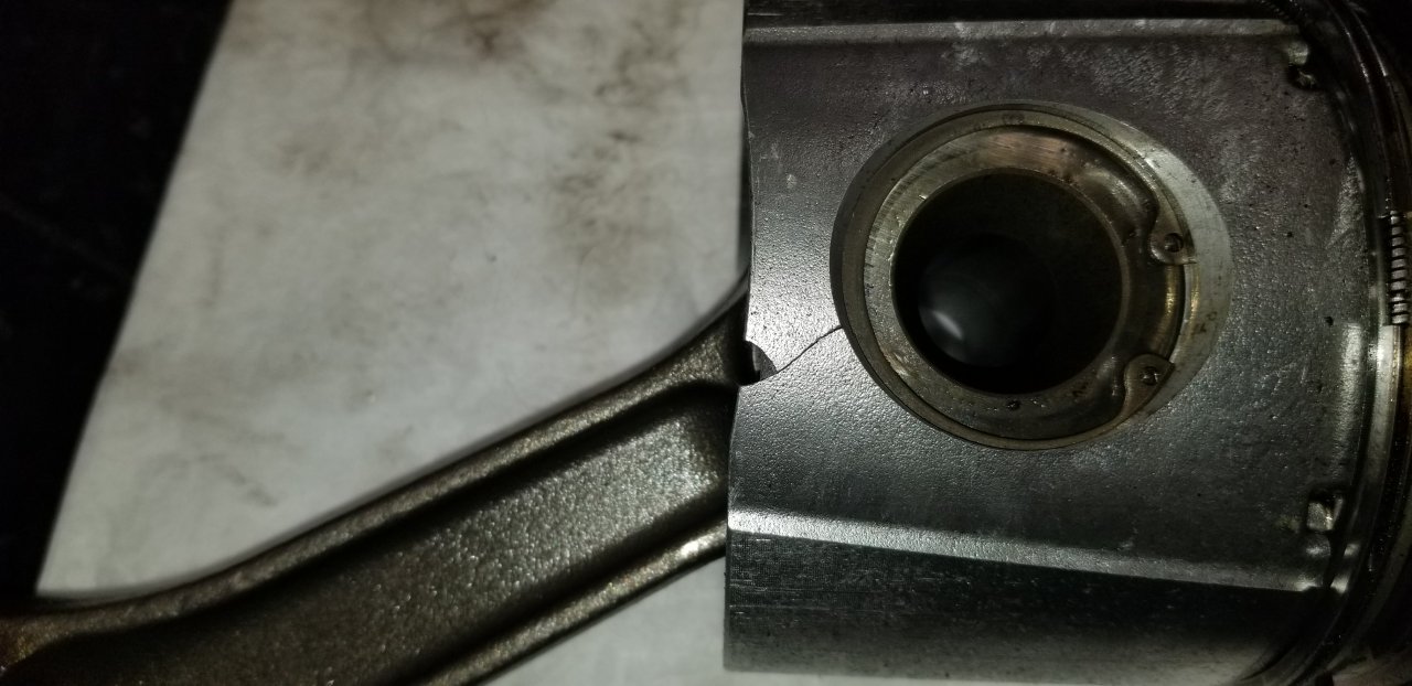

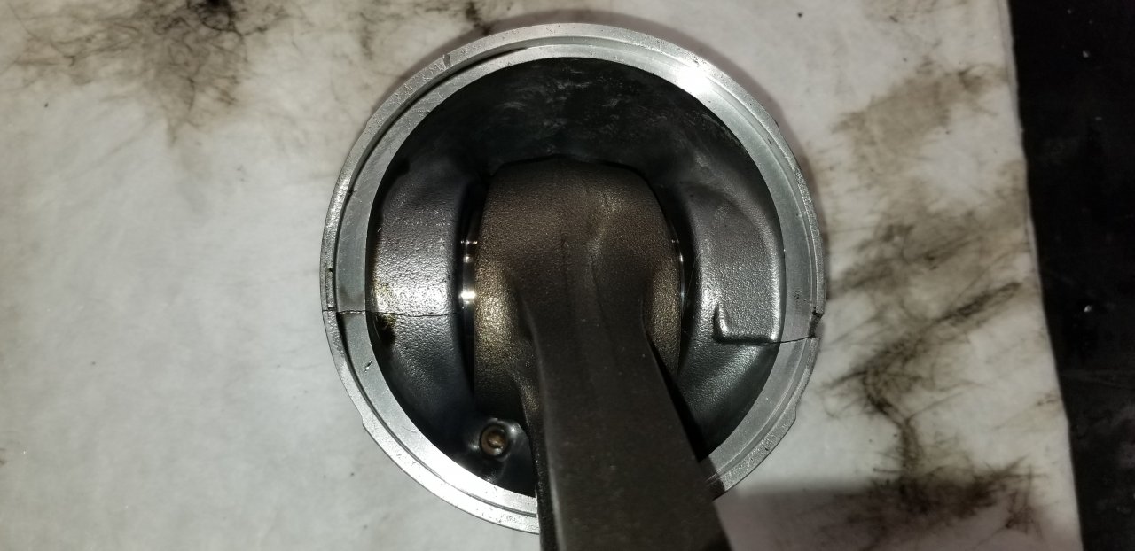

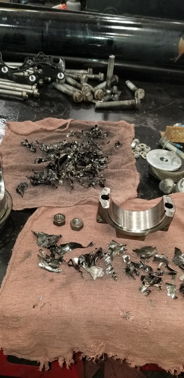

  7. Goodysnap
    Goodysnap Road Train Member
    3,791
    9,229
    Jul 12, 2017
    #6- Cummins ISC CM2150

  10. spsauerland
    spsauerland Road Train Member
    4,296
    10,891
    May 31, 2010
    West Harrison, In
    Excessive regens catch up with that one?
  11. Goodysnap
    3,791
    9,229
    Jul 12, 2017
    Yea Im not sure. This thing was towed to us about 4 years ago with a supposed fresh overhaul, but a CNS. We rebuilt the fuel system and its been a money pit for the cutomer ever since. One thing after the other every year.
    Note the heavy fretting on the connecting rod cap.......it was tight. But no doubt the hammering of the rod broke the piston.
    Still running and had decent oil pressure too.
    Too bad a drop ins gonna way exceed what this old girl is worth.
