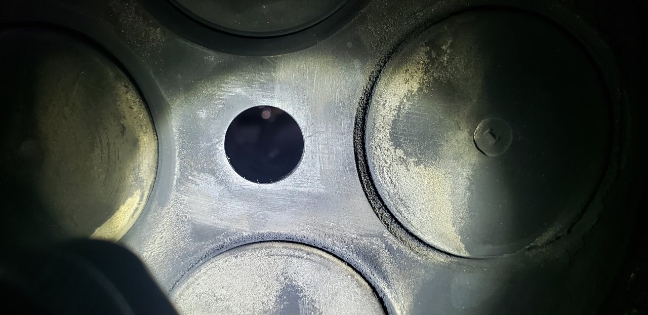

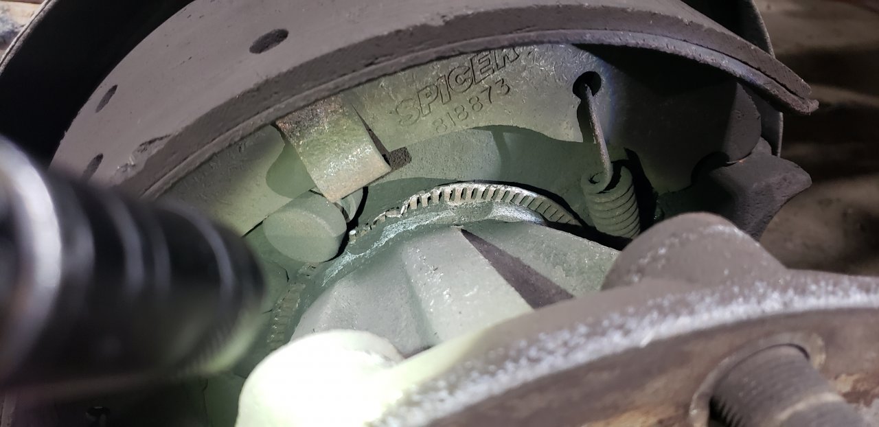

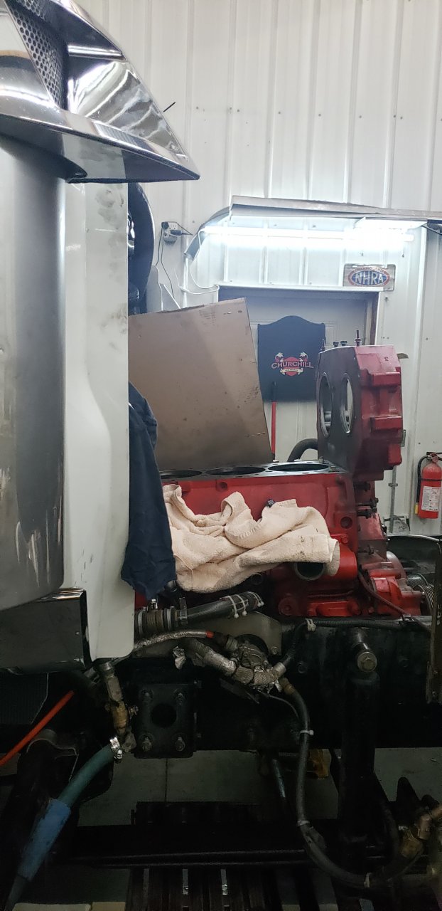

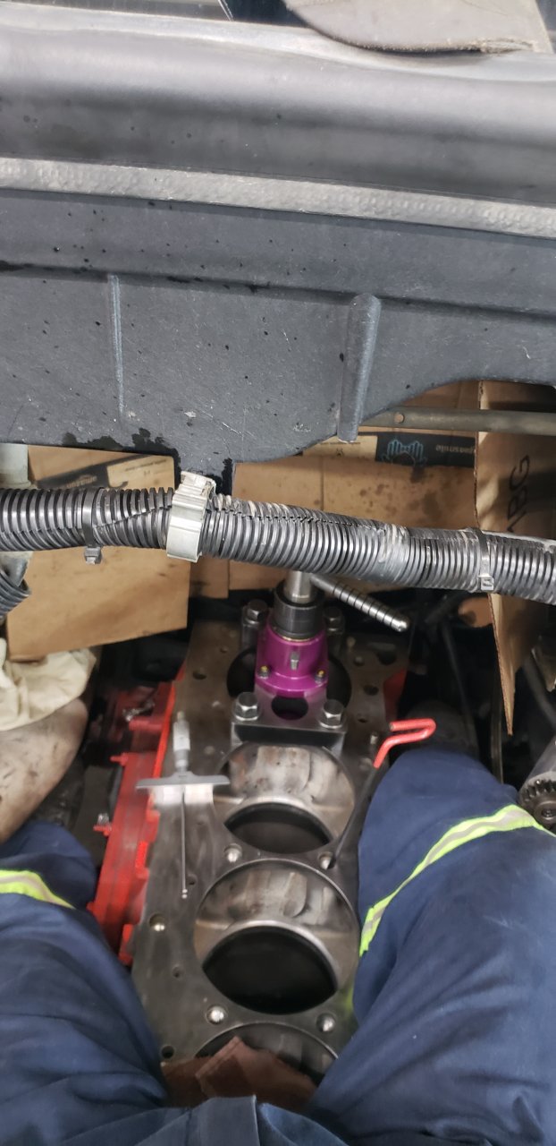

    Machining counterbores on a lonestar. Worst model out there for engine work.
    20201126_093150.jpg 20201126_083258.jpg isx head cracked out from the injector hole
    Brake hardware fell off and ate the tone wheel
    Flint1, 650cat425, Shawn2130 and 6 others Thank this.

    That looks amazingly bad to do. You gotta be seriously bummed out when those trucks show up. Some of today's internationals can be so difficult to repair.

    Seeing you use the Monaco counterbore tool group, they I'd share some information and story here! They gentleman that cut the counterbores for me has been cutting them around my area since the 80's. I can remember being pre-school age and he cut a Big Cam in a 359 Peterbilt for lower press fit liners in my garage (was my Grandpa's at that time)!
    Just so happened before he came out, I was killing some time so I watched the latest Paccar Power train newsletter. One of the topics was the Monaco counterbore tool group is now approved for cutting the MX counterbores after being "not Paccar approved" for some time. John had the back story because he knows and talks to owner of Monaco tool Joe. Joe is in his 70's and a stand up guy. He has warrantied a tool for me and paid shipping. Paccar's beef with first tool Monaco had is it wouldn't cut the the relief out that is part of the ledge. Here is picture for visual Screenshot_20201205-222552.png
    Joe designed a cutter bit that that has correct radius and can be plunged back to cut the full ledge. Sent to Paccar and they only had one beef. He set it to cut 0.050" in and they would like to see .046"! That's how picky Paccar is with their engine! Side note when counterboring a MX to raise height back you use a thicker flange liner (0.0016", 0.0098" and 0.0197") by the Paccar way. A 12.7 Detroit Series 60 shim works perfectly too!
