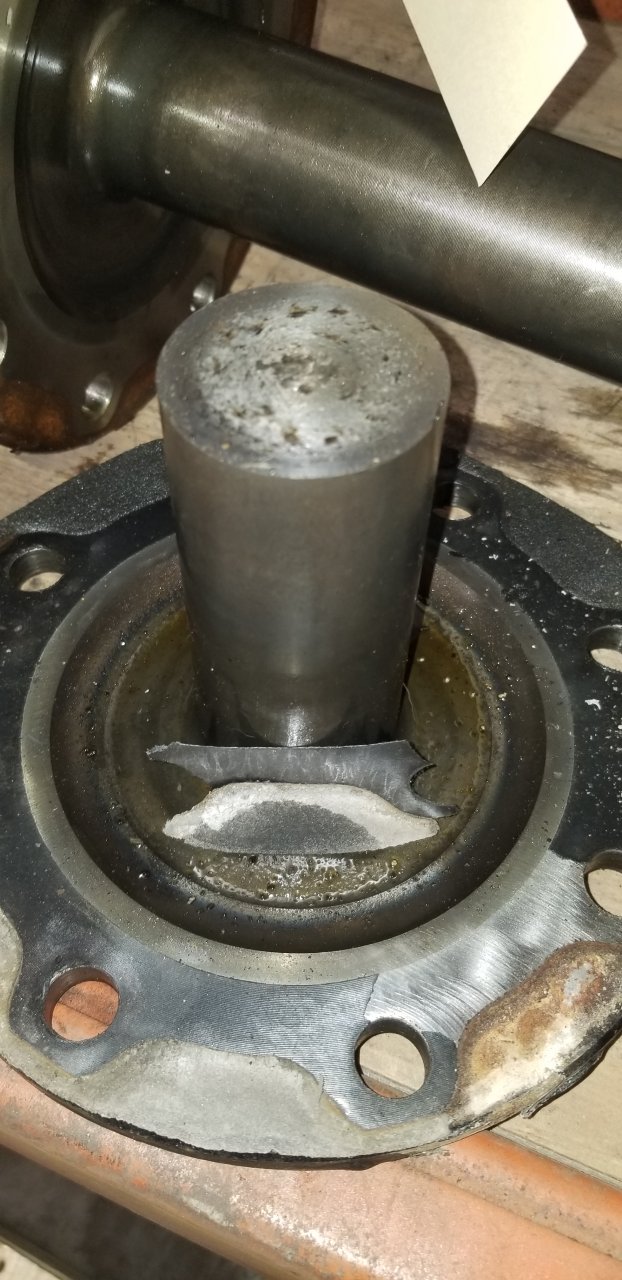

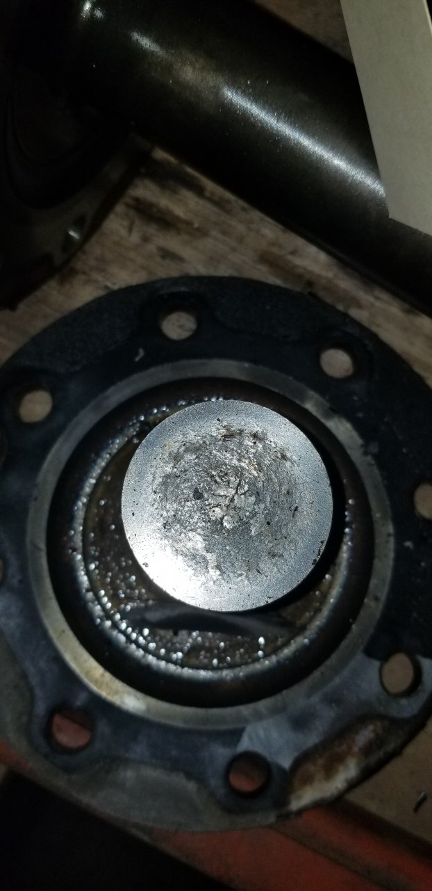

  7. Goodysnap
    Goodysnap Road Train Member
    3,791
    9,229
    Jul 12, 2017
    I am not a machinist, but this driver could be..........
    Never seen one sheared off so clean.

  9. AModelCat
    29,763
    165,366
    Loose bearings or bent axle housing? Looks like a misalignment failure more than a torsional or shock load failure.
    Shawn2130, Flint1 and Goodysnap Thank this.
  10. Goodysnap
    3,791
    9,229
    Jul 12, 2017
    Meritor disagrees with you and Denied the warranty claim as shock load. Wheel bearings were not loose and tis a new chassis with 75K on the clock. No evidence of axle housing damage. This one got a reman diff and both shafts. Splines were quite chewed up on the locking side axle as well.
  11. AModelCat
    29,763
    165,366
    That's odd, typically a shock load/excess torsional load tears the shaft apart with a 45 degree break. Misalignment is usually a cleaner break.
