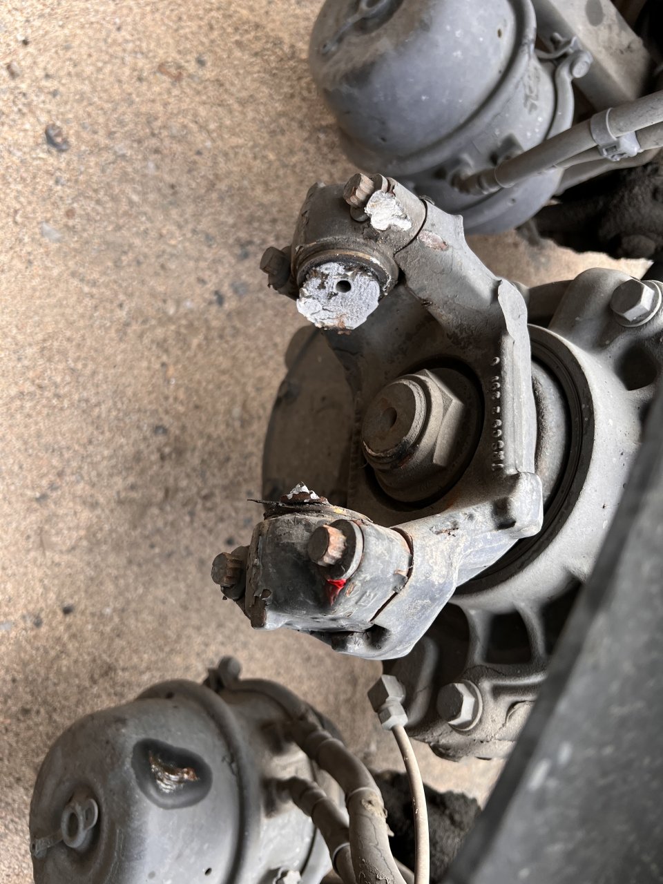

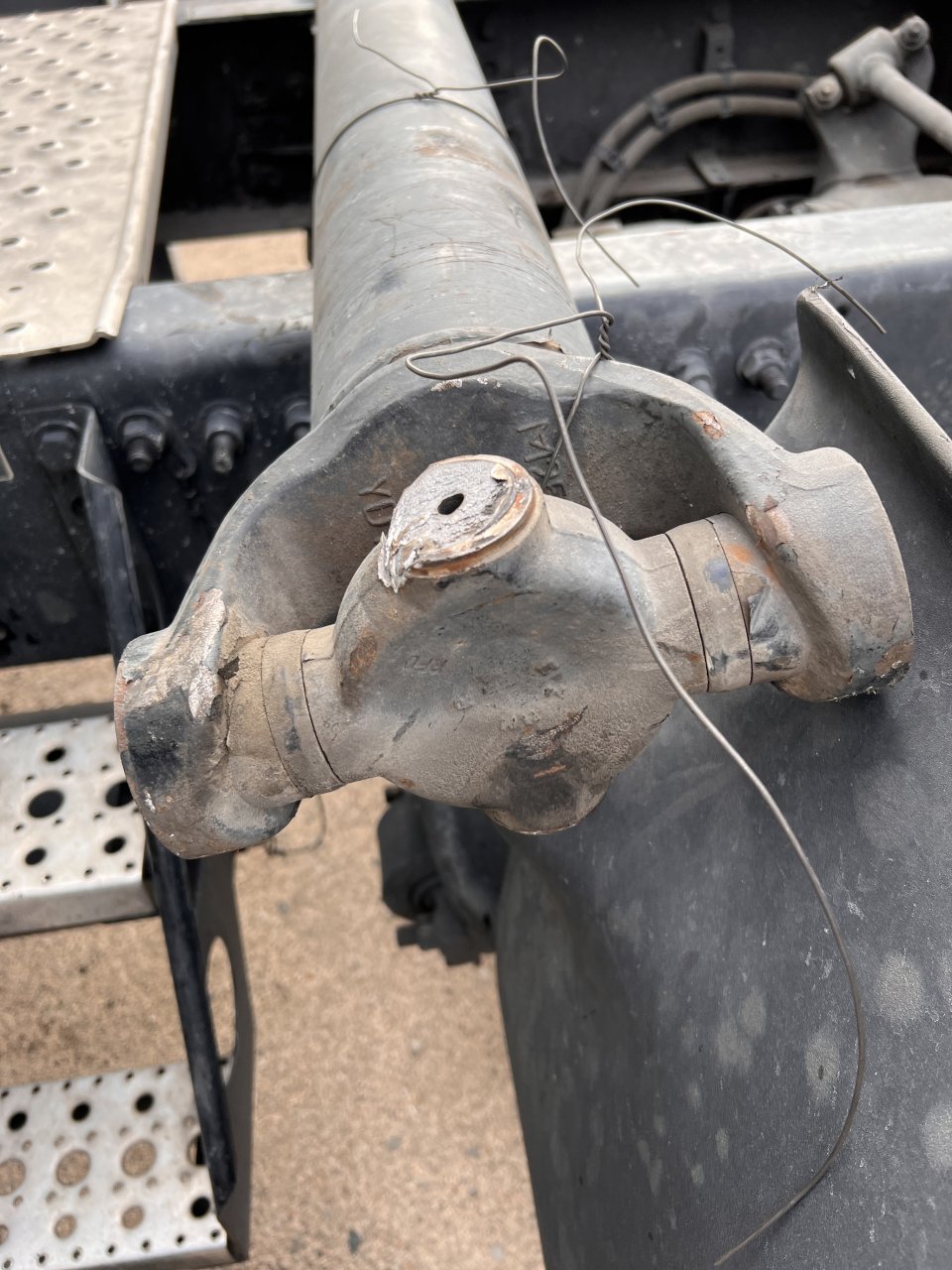

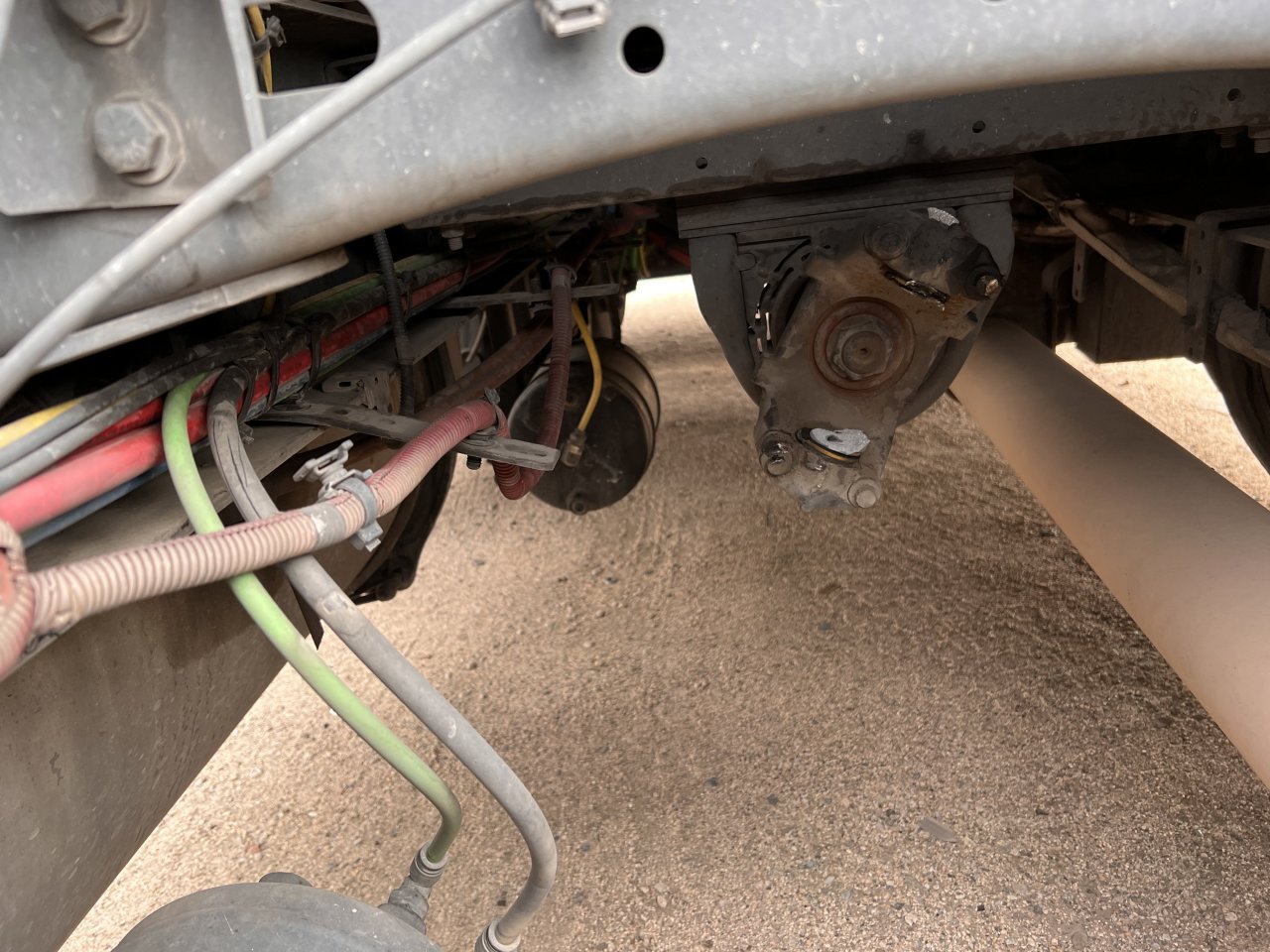

    Driver: “Idk what happened boss, I was tryna slide the tandems with a fully loaded trailer and it just wouldn’t go anymore” 5F139A7C-123F-48CE-894D-216F6CCFB917.jpeg F028FB3D-7814-4DC5-A35D-D05B47199310.jpeg 33BC7C2B-D6F0-48D4-9F69-F787054535AB.jpeg

    That u-joint looks pretty dry.

    I don’t see a grease fitting anywhere either. Must be a total sealed u-joint?
    It does have the drilled holes for grease
    God prefers Diesels Thanks this.

    It's empty! And there's no slung grease on anything under there. Makes me wonder if it's ever been greased since it's been on the truck.

    The zerk faces away from the yoke nut. Otherwise you can't get a gun on it. So if it has one, it's on the other side in the first pic.

    Pretty fine lines along the fracture in the one picture. Usually a shock load you see a very rough and jagged break.
