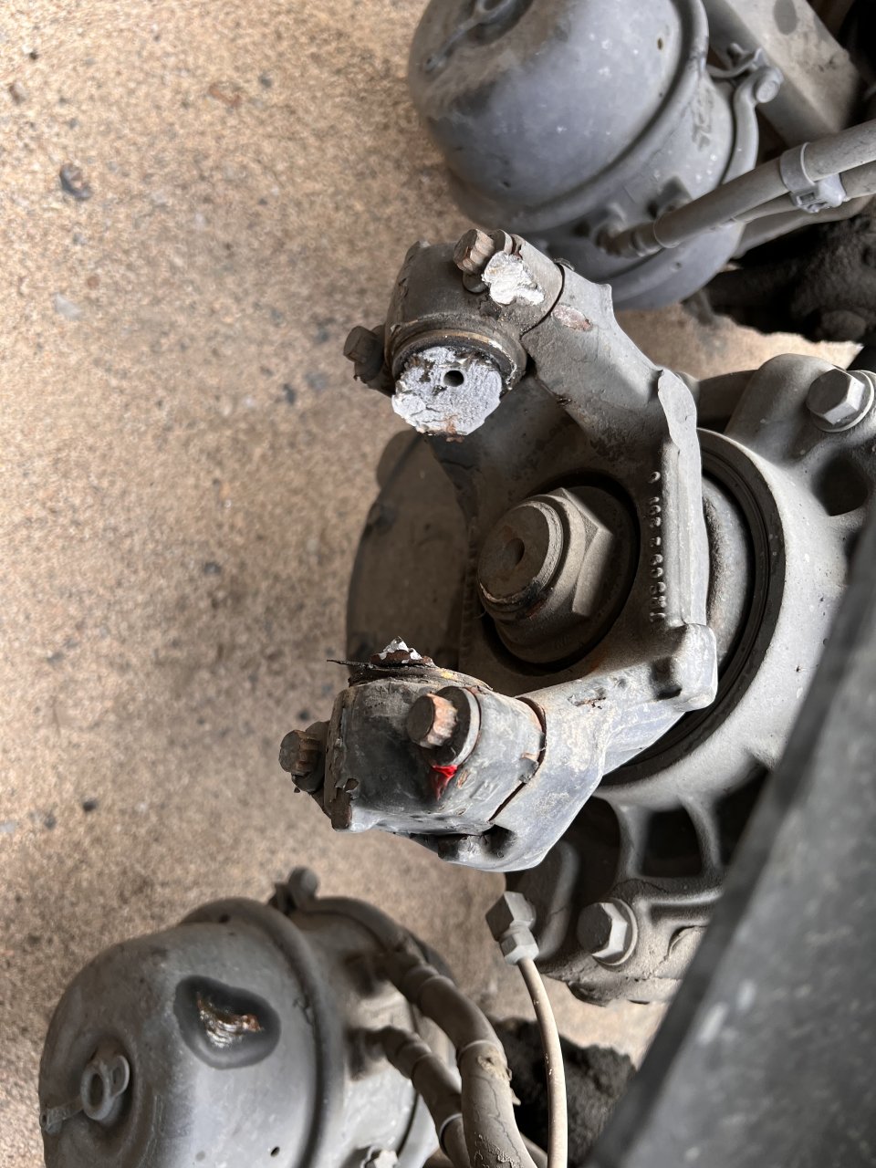

Click Click Boom!!!!!

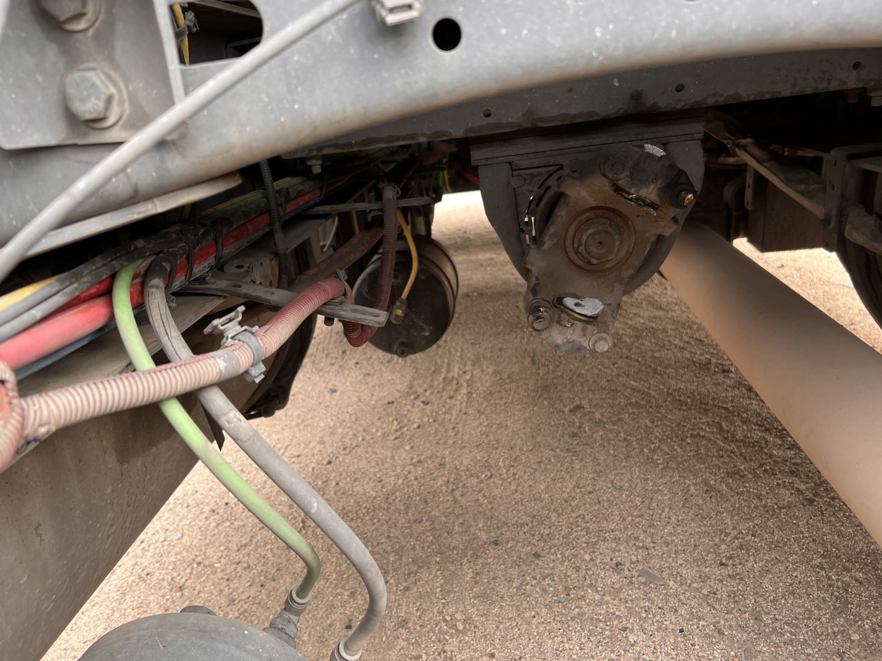

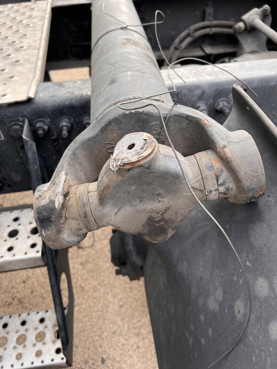

    Probably one of those drivers with auto transmissions ;)
    My father told me of one Volvo driver at a large carrier company he works at attempt to make the truck move. Just kept adding throttle (he forgot to release the brakes).
    Boom! Snapped a u-joint at the company yard. :eek:
    Likely had some explaining to do with the shop boss while his truck got towed to the bay. ;)

    These are sealed u joints no fittings on them

    They’re sealed joints no fitting on them

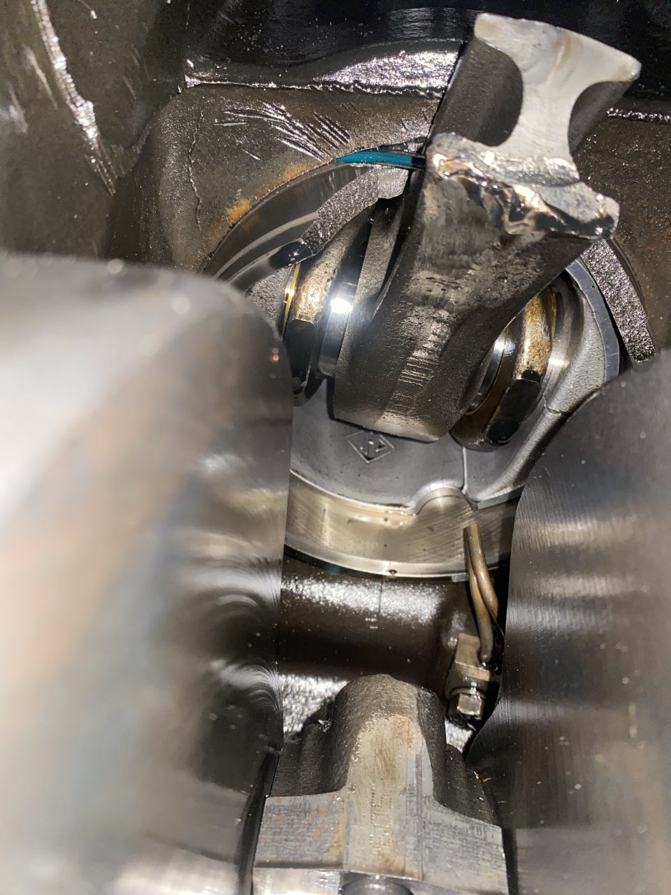

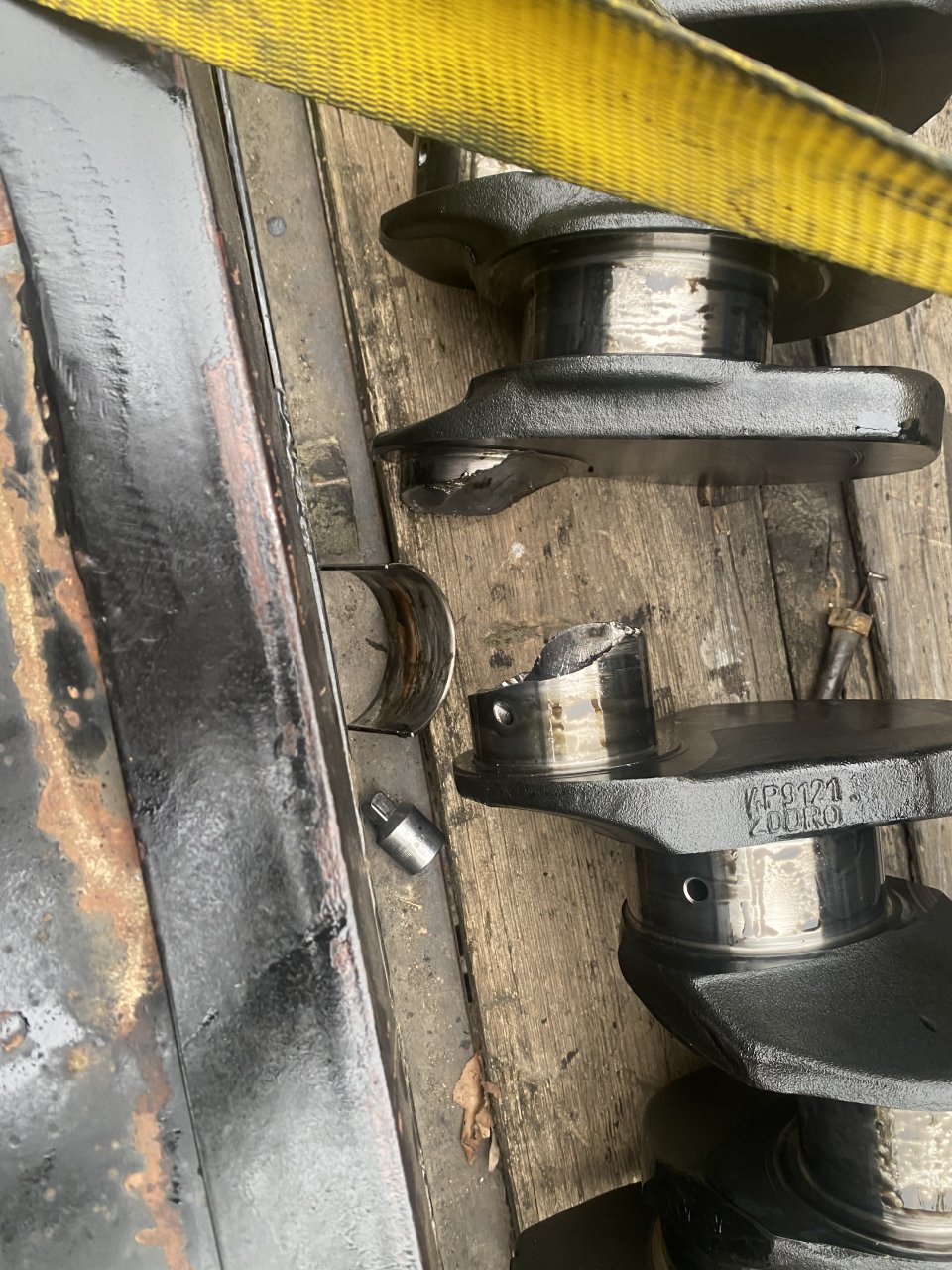

    i actually caught this one before it let loose….it was causing some vibration C776B236-5F63-4163-AD8D-79408230D719.jpeg
    OOPS believe that someone fubbard an over head 317EEF43-DF92-459E-9071-4B759730BD36.jpeg
    Rod bolts are supposed to be longer than this…possible over speed A6F8DDD8-E1EE-4255-BCA2-DBEFA1AE7EB4.jpeg
    Nice and crispy…only the head and a couple rods were reused from this one

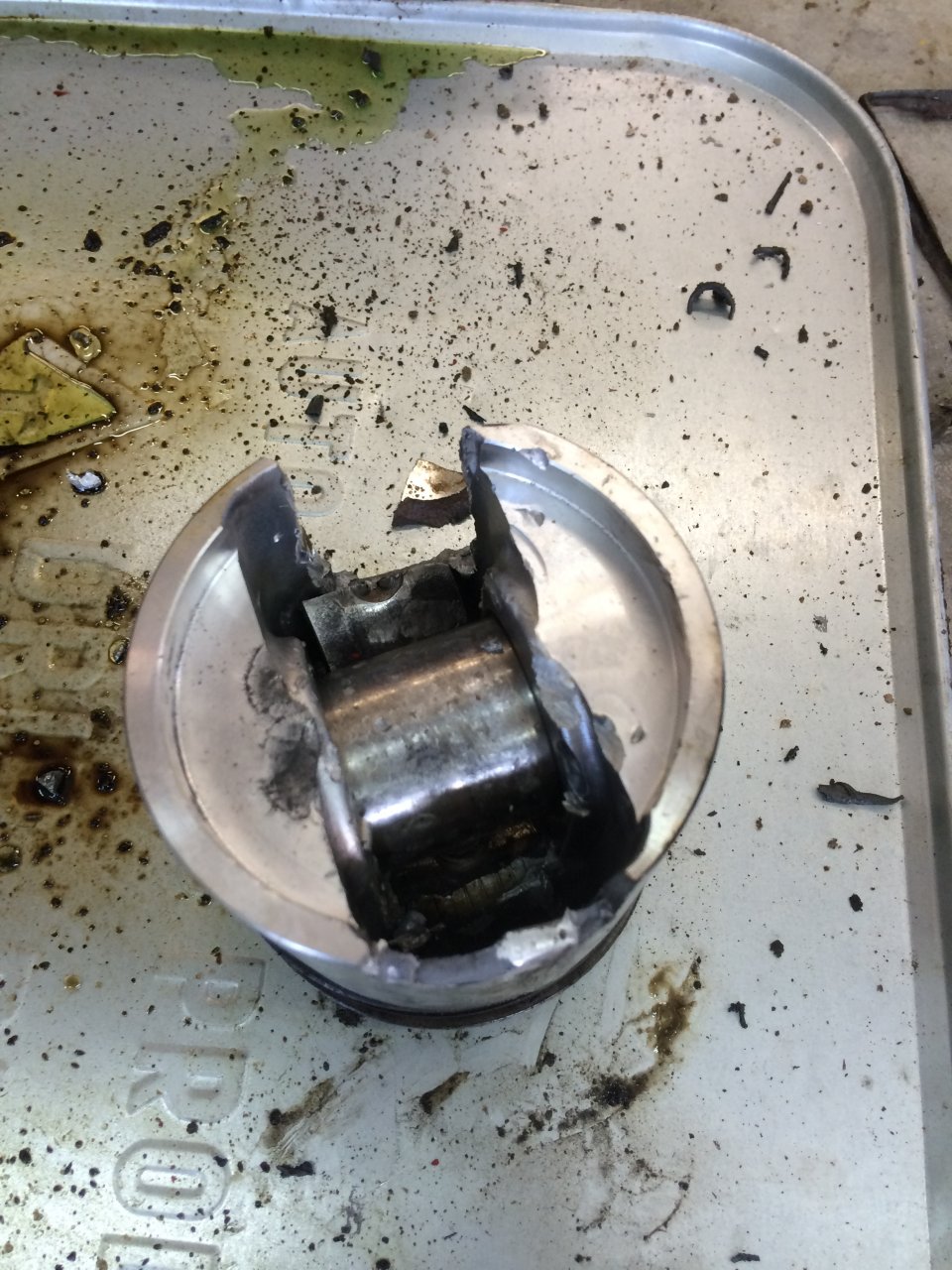

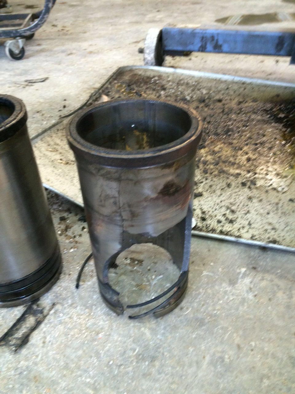

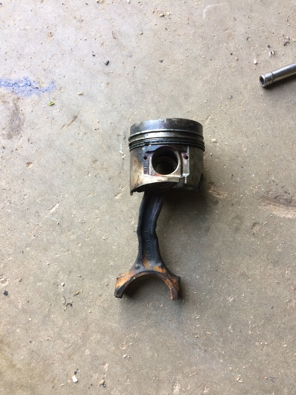

    7406D4A8-3BC7-4307-9502-1017EE0C6120.jpeg 73DE407F-7667-4EED-88C8-A8493A449C8A.jpeg C6452437-A58E-44A6-8F7B-43AF0D0E2632.jpeg
    This engine stopped so hard it half sheared the flywheel bolts
    Had very few hrs on an overhaul apparently they didn’t know you are supposed to line up the oil hole in the wrist pin bushing
    3rd and 8th gear make a grinding noise and the truck won’t move…No kidding

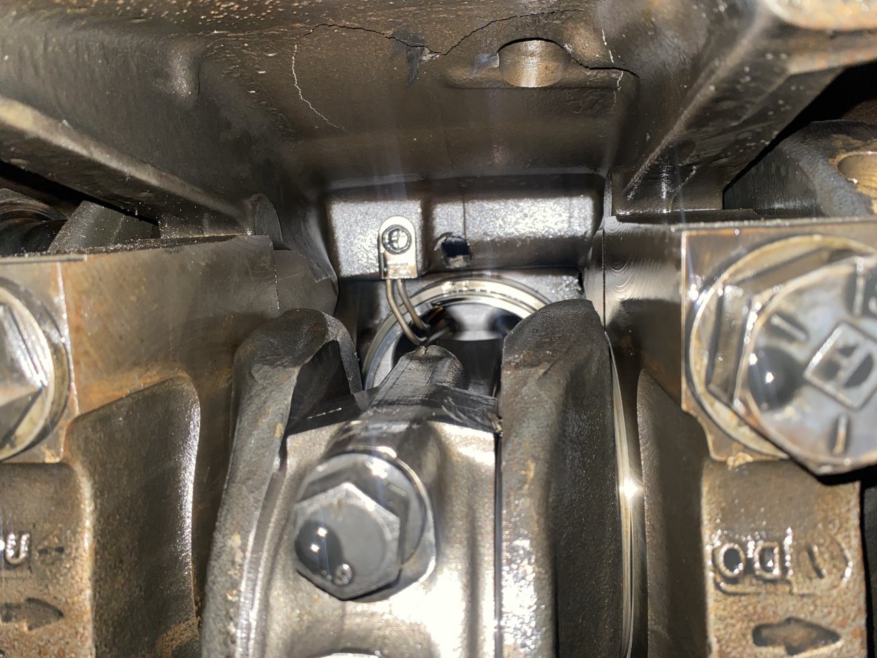

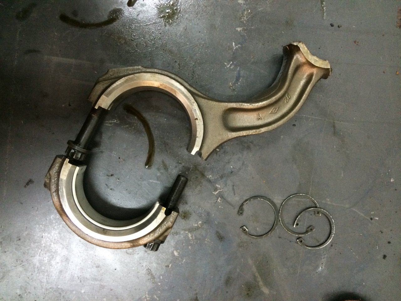

    One I looked at several months ago had a very auditable peck that stopped when I cracked number 6 fuel line. Coasting down hill no Jake when all hell broke loose. Once I got the bottom half of rod off the crank the journal was unhurt seemly. They said it was shut off instantly but did loose oil pressure as he killed it. I figure from debris flying around inside and getting between number 5 rod and the oil galley causing that thumb size hole
    2 months was way longer than I thought it would last. I’m not sure if the rod broke due to wrist pin locking or if wrist pin is locked due to rod breaking. Either way I got plenty to keep me busy
    Got home yesterday and a guy calls me says he wants me to listen to his truck. Drives it up in my driveway.........#3 rod must be a tough sob that’s all that was holding the 2 pieces together.
