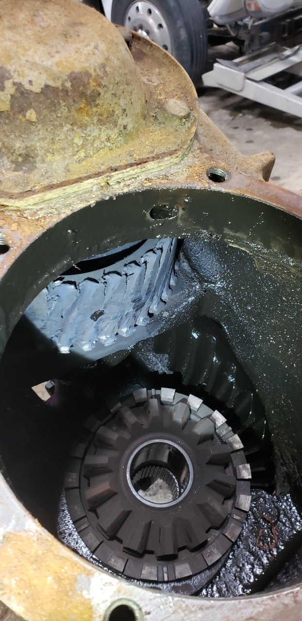

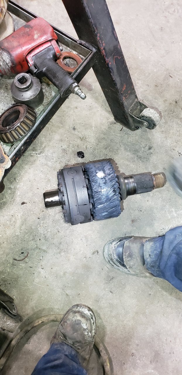

    What kinda rear is that out of and is it a detroit locker on the left of the slick gear? @pushbroom
    And thats a slick carrier bearing removal trick there, nice.

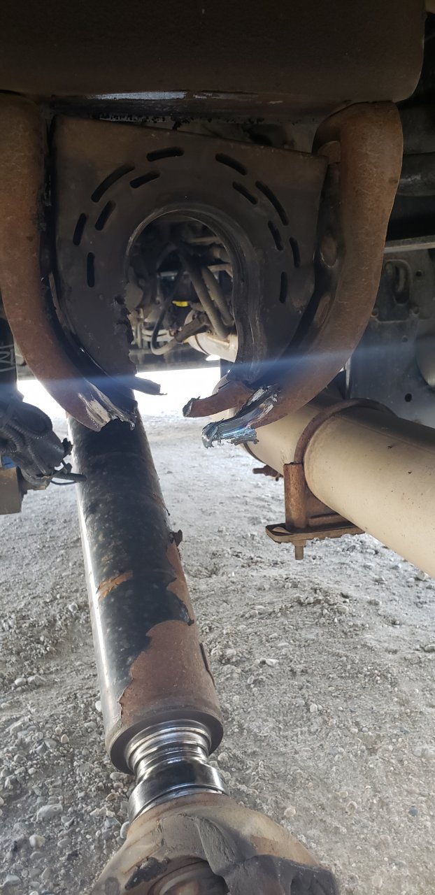

    2 different ones.
    It blew out a yoke seal. Driver had all the lockers on and didn't quit til the truck did.
    wore out, Flint1, spsauerland and 2 others Thank this.
