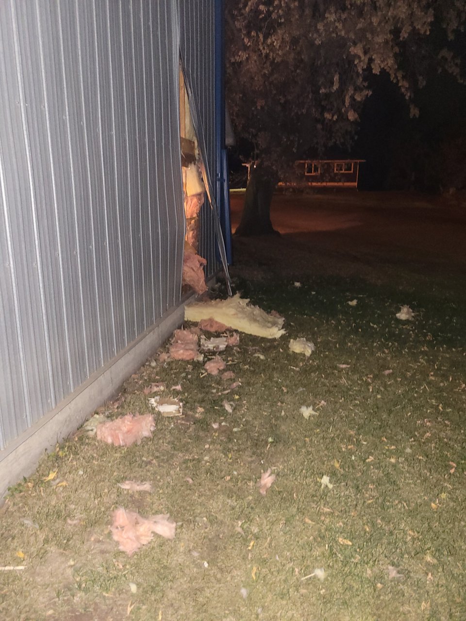

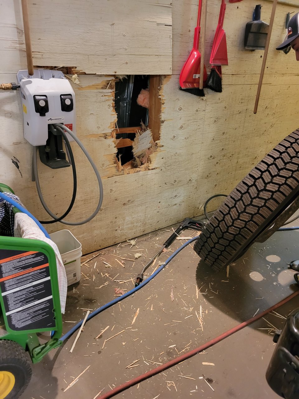

    If you look at the outside wall pic you can see the entire wall is bulged out.

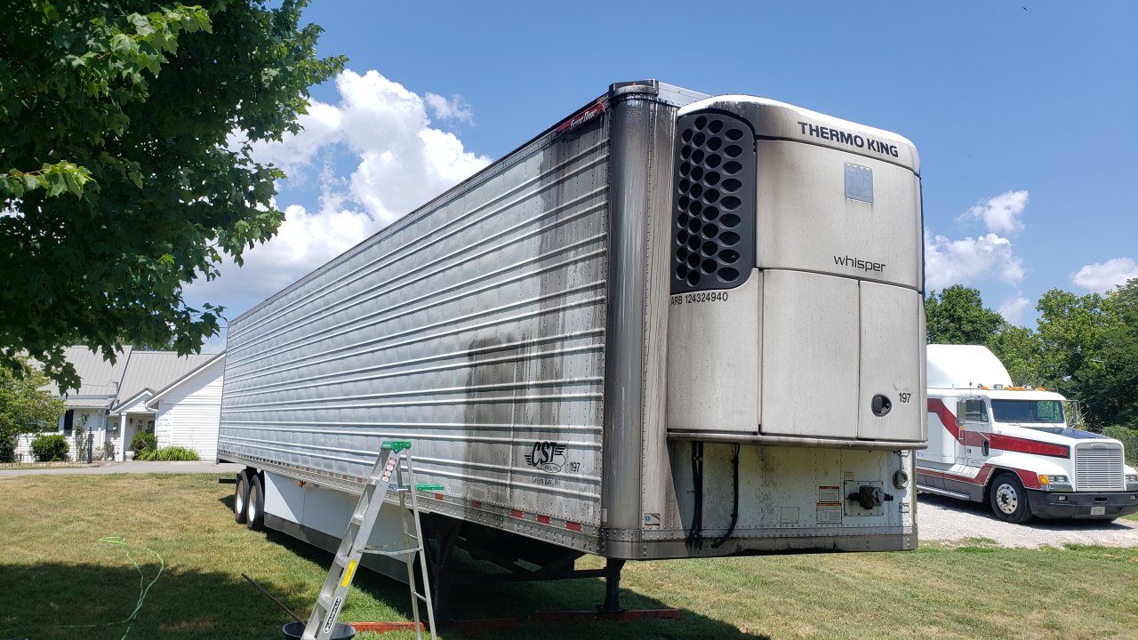

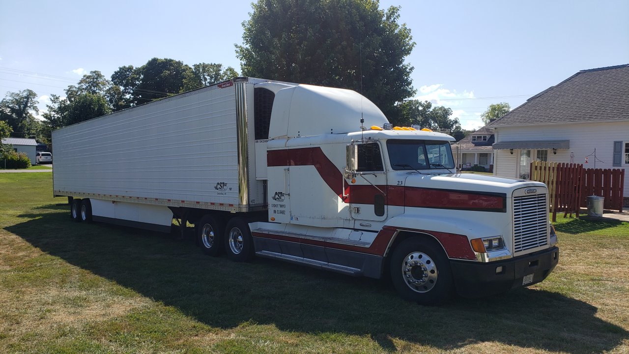

    Somehow I missed this thread. I've mentioned this in other posts in the o/o section. I got some carnage from last spring's turbo explosion, engine runaway, motor oil everywhere... 20220526_153612.jpg 20220527_162705.jpg 20220531_151311.jpg 20220608_161455.jpg 20220608_150553.jpg 20220723_142017.jpg 20220723_161709.jpg
    It cleaned up nice, put a new turbo on, and got it running again but about a month later a connecting rod bearing seized. Several lessons learned from that one. If I had it to do over again the bearing never would have seized and I'd still be driving it.
    I wish I had rolled in all brand new bearings and even cam bearings. Probably replace camshaft and rocker arms too. I didn't and the result of that runaway engine starving the engine of oil is what lead to the seized bearing. Replacing those bearings and camshaft were beyond my abilities and money was tight. I did have the funds to get that done even tho it would have stretched things super tight and wish I had now. I fixed the turbo and a lot of other things myself.
    After I replaced the turbo when the truck idled I could see my mirrors had a little excessive shaking to them. I thought I needed to get the top end inspected and at a minimum valve lash adjusted. I had run it locally for a few weeks seeing how it did and it did fine. So then I book a 700 mile trip to Florida and about 80 miles from my destination the engine seized while idling at a truck stop.

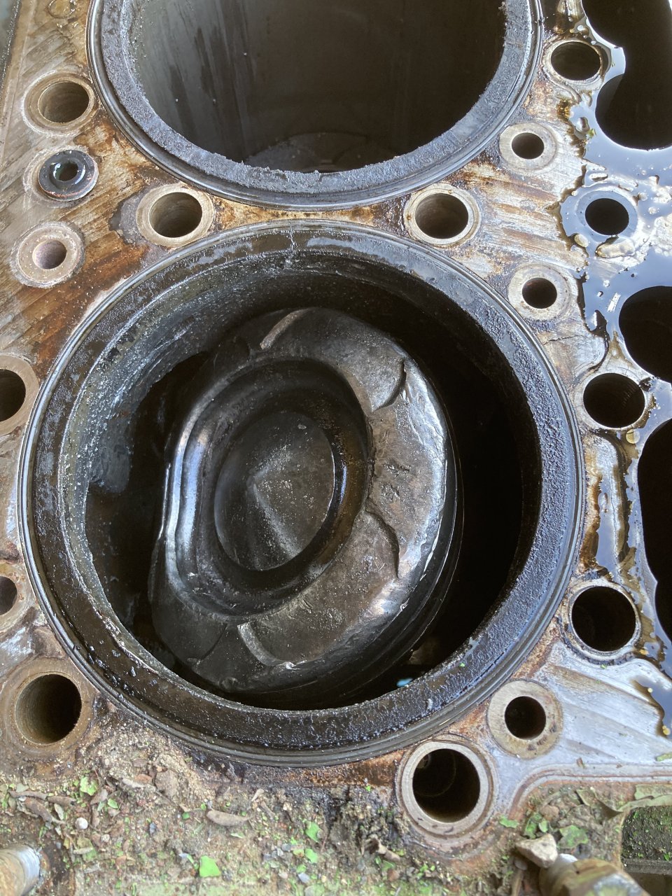

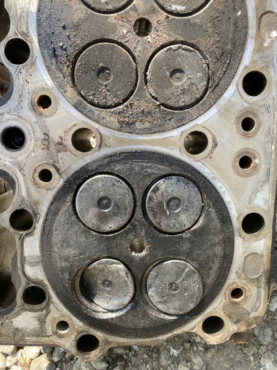

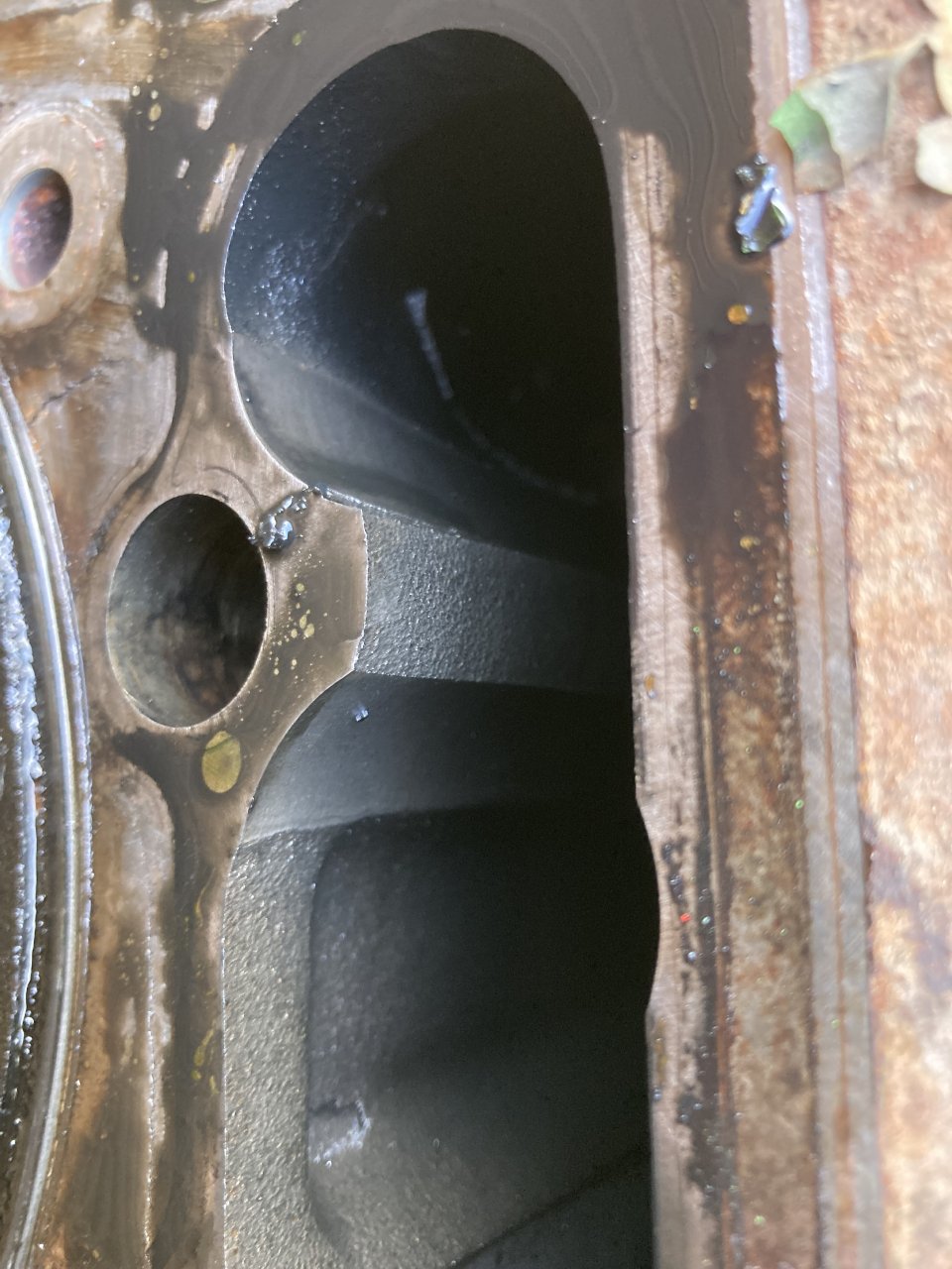

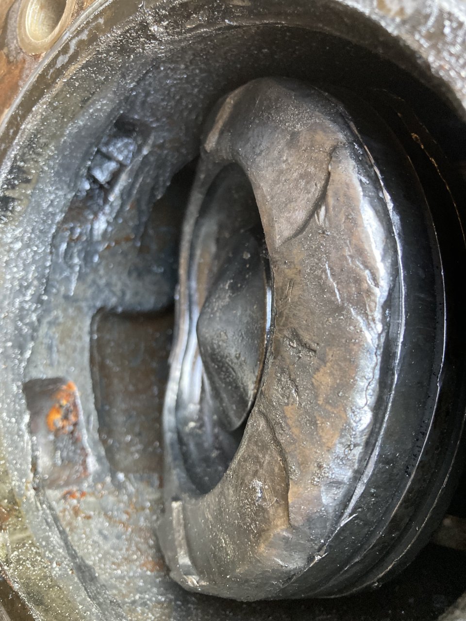

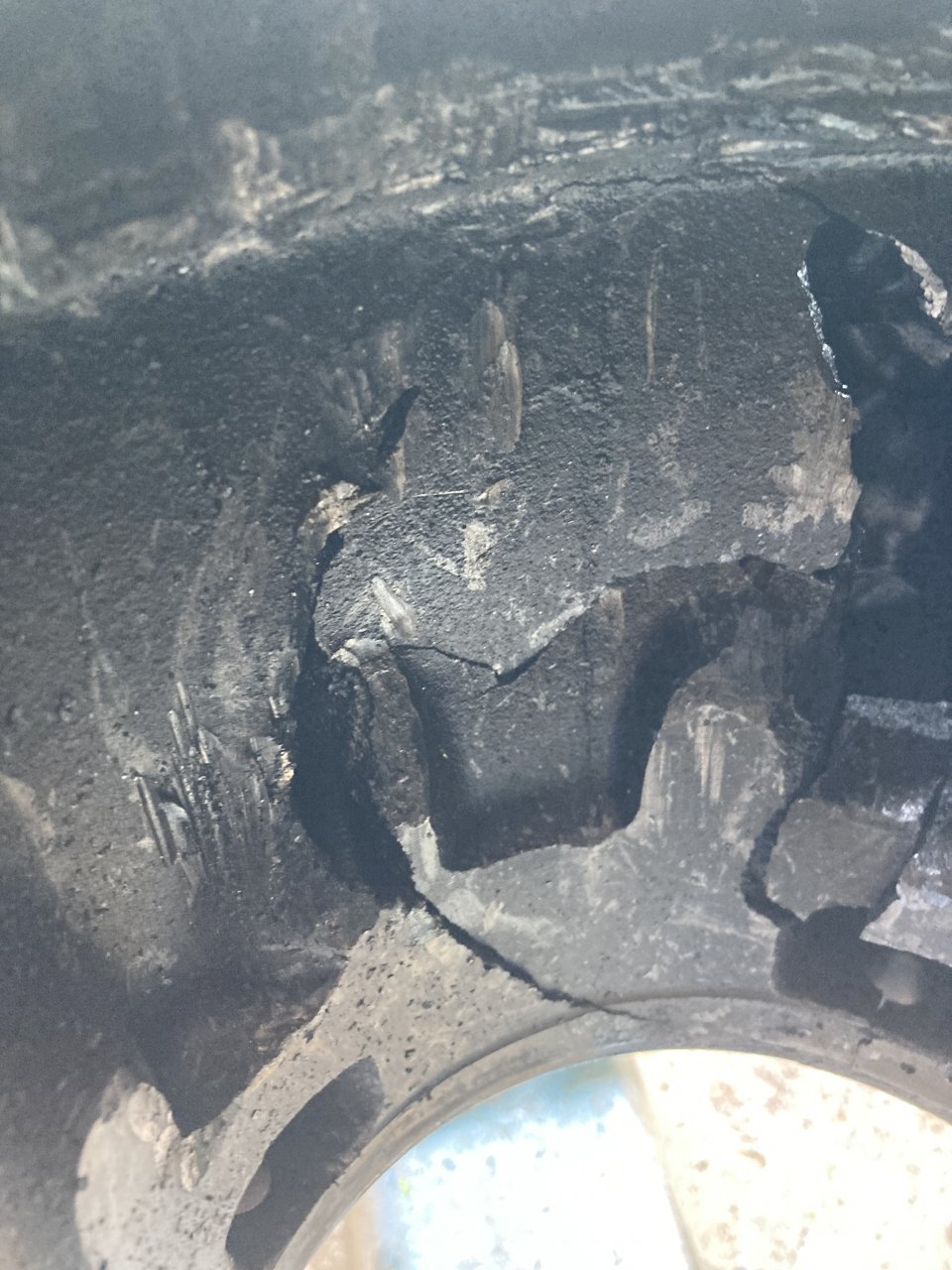

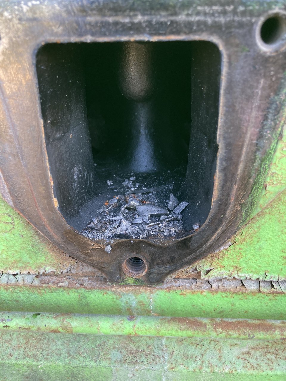

    IMG_5231.jpeg IMG_5204.jpeg IMG_5207.jpeg IMG_5209.jpeg IMG_5208.jpeg IMG_5224.jpeg
    n14 that came apart not sure why at this point except that probably the piston skirt broke. That was number 1 number 2 skirt is galled and stated to crack.

    Eeeewwww! Terrible damage

    That would make me :puke:
