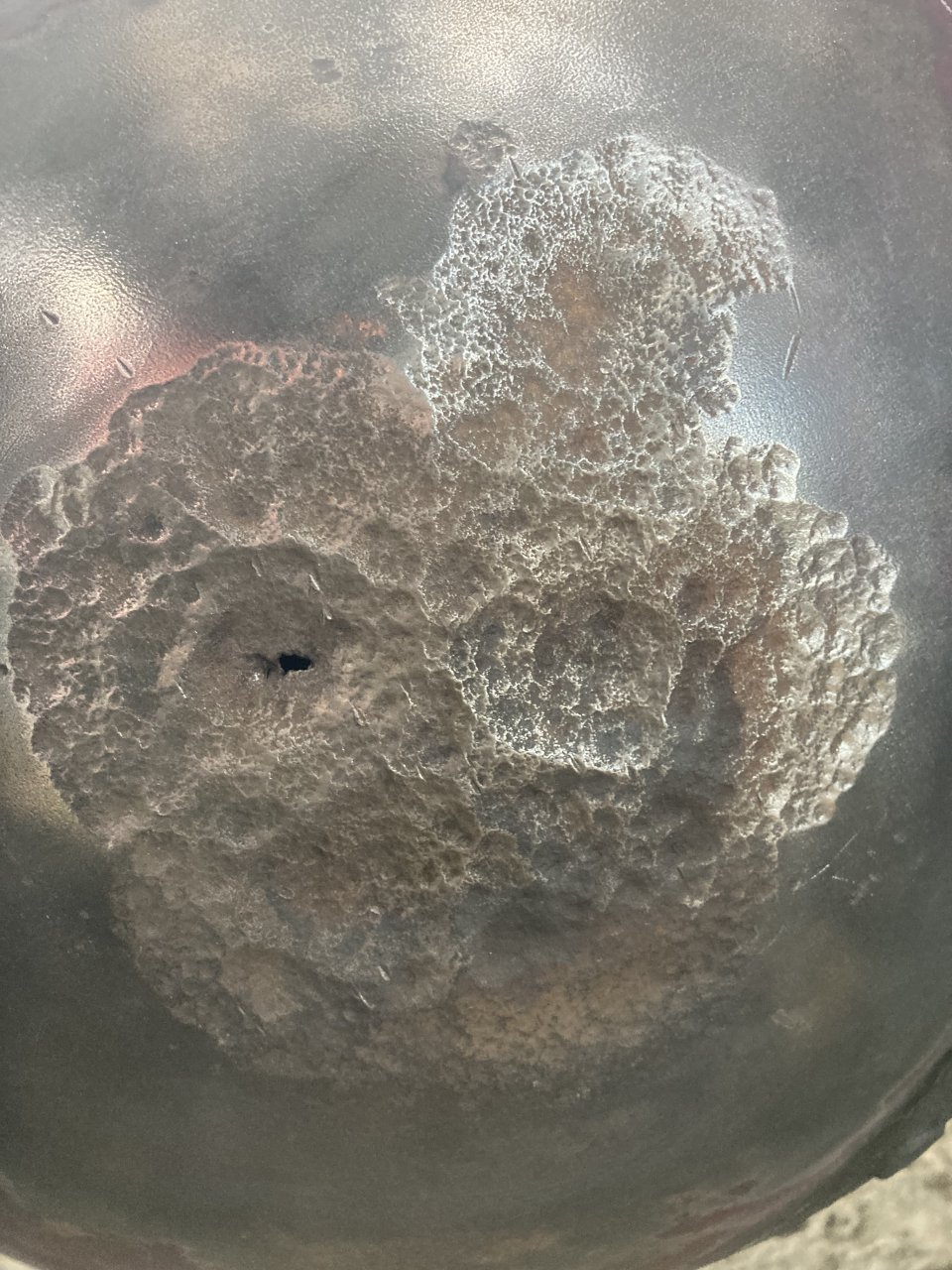

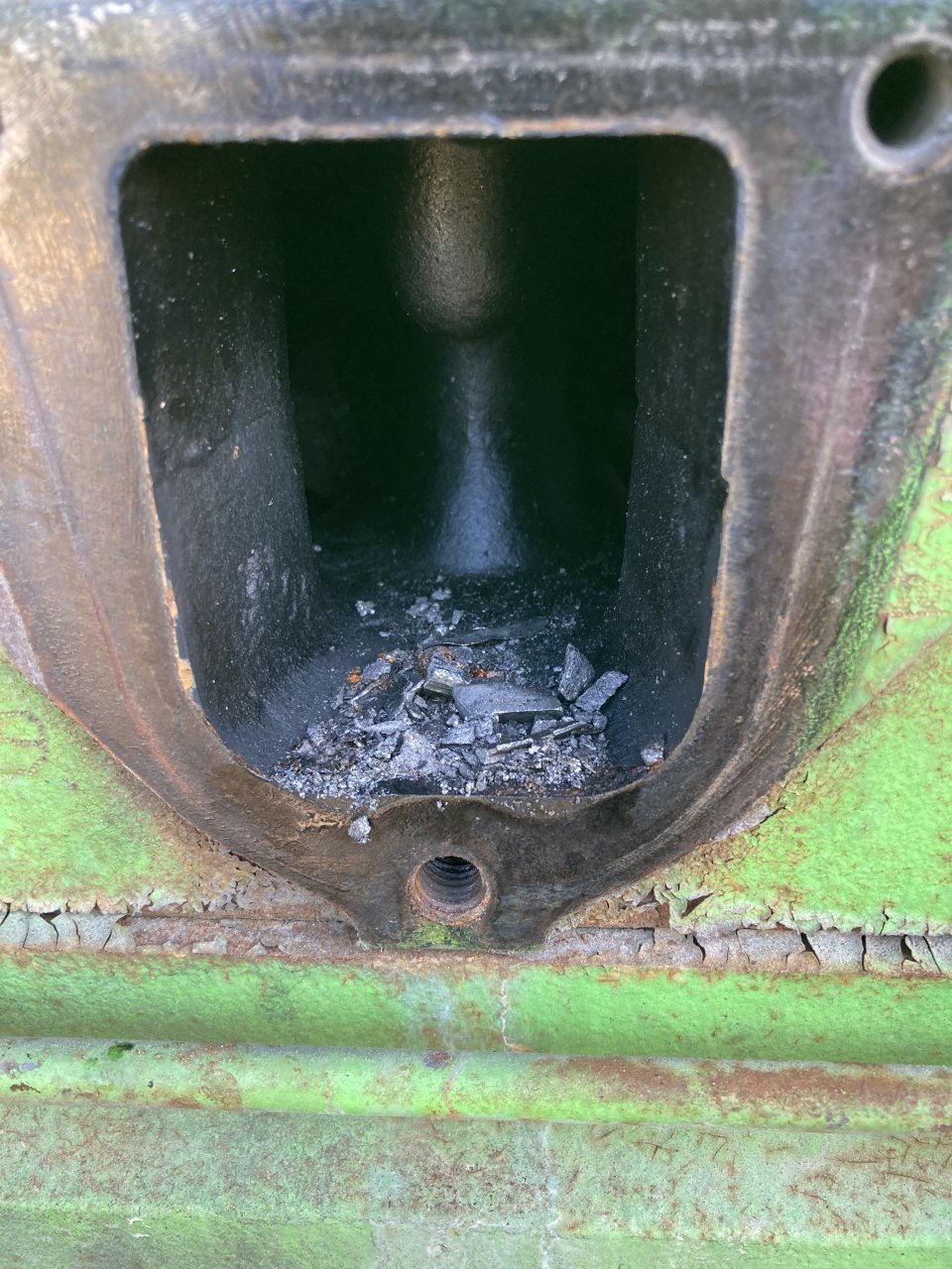

    It’s green….but not the right green
    It’s in an fld 120

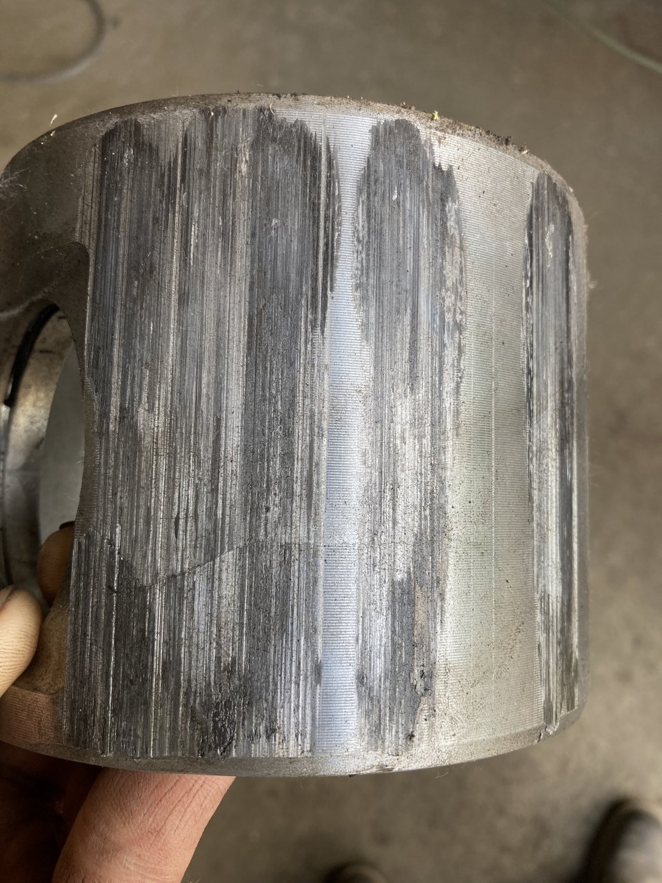

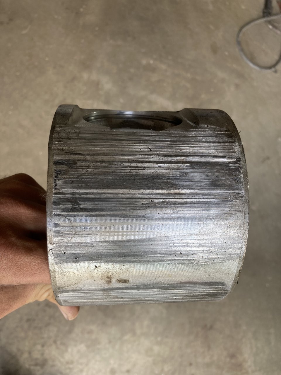

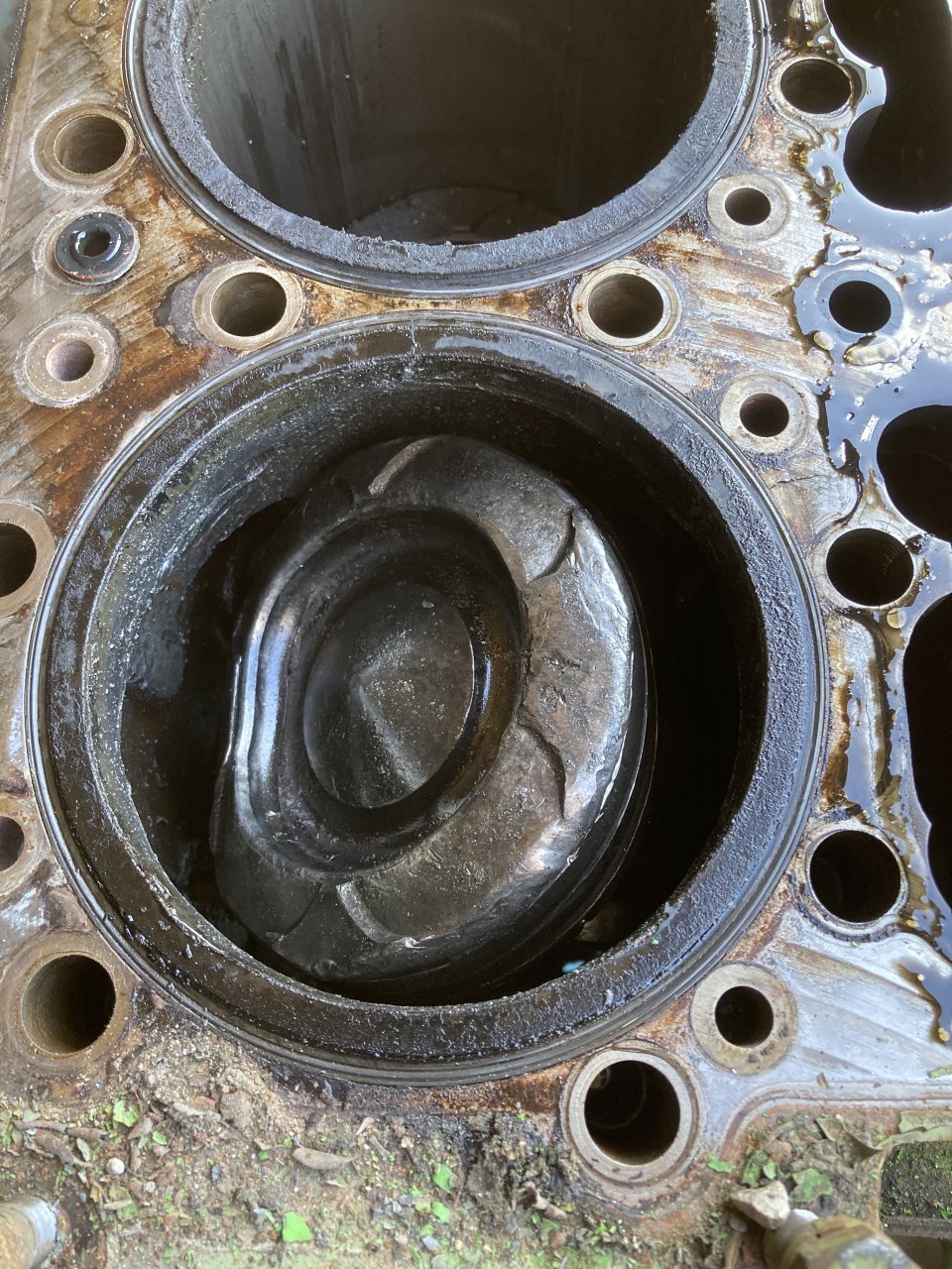

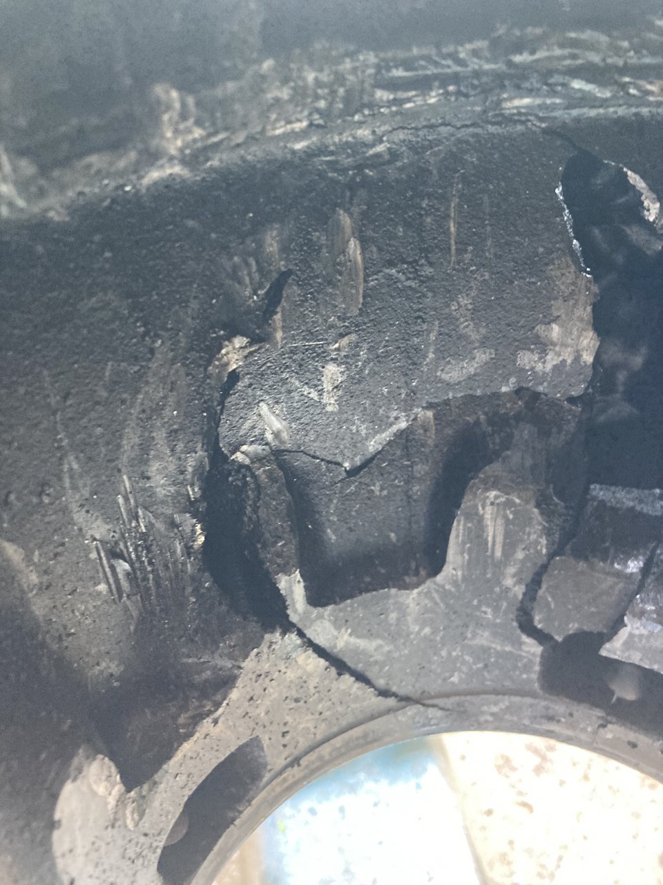

    i forgot to include this one of the number 2 piston skirt….wouldn’t have been much longer till this one had the same problem. The other 4 look practically new although #6 was replaced at some point recently

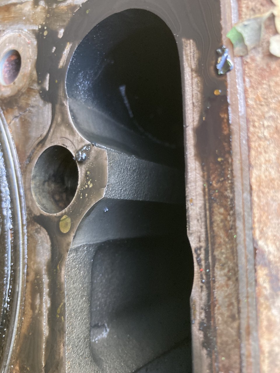

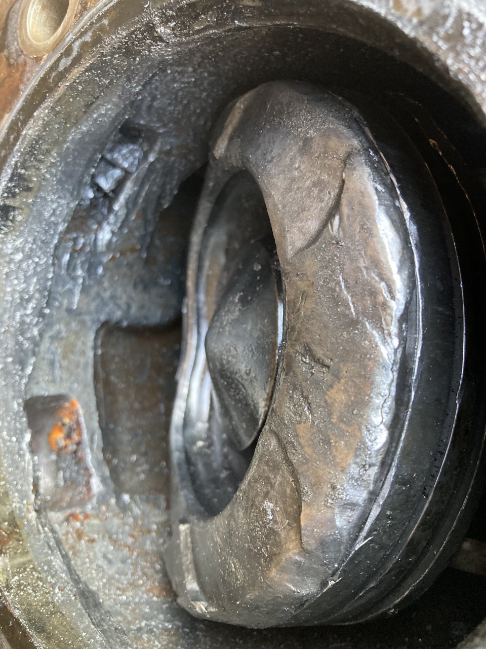

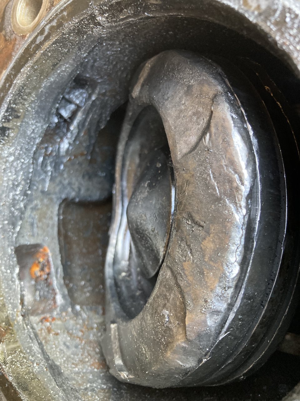

    Sorry guys I failed you on the boom part but just use your imagination as to what happens when all the oil is gone IMG_5603.jpeg IMG_5605.jpeg

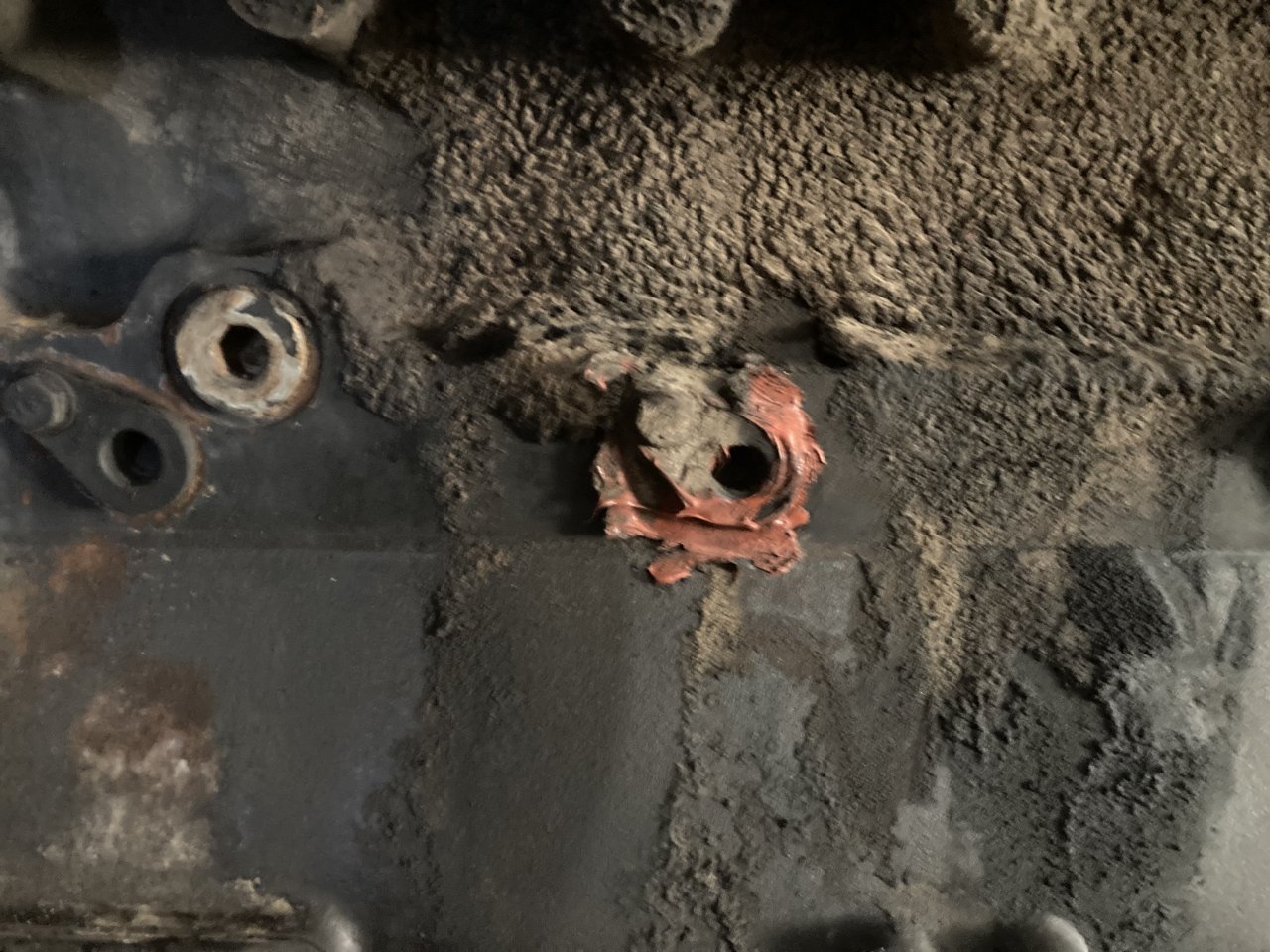

    Ever seen a $10k silicon job… IMG_5895.jpeg Now you have…the squiter broke at the o ring groove and was leaking to the outside so the guy siliconed it and then at some point later it seems like the rest of the oil squirter ended up in the oil pan and the engine lost oil pressure and seized several bearings and the turbo. Might have the pictures in a couple days if they try to fix this one. More likely it’s getting a donor engine
