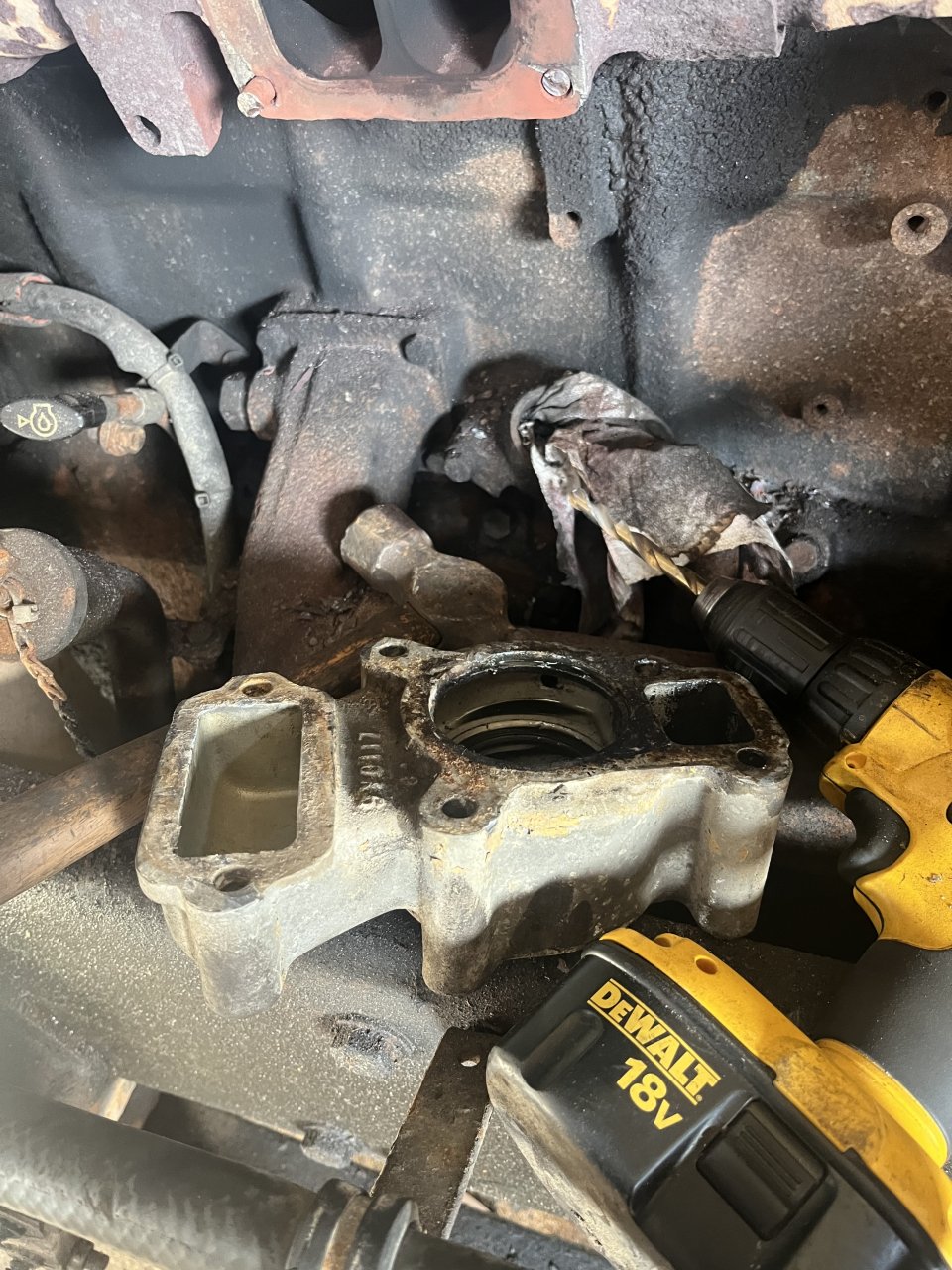

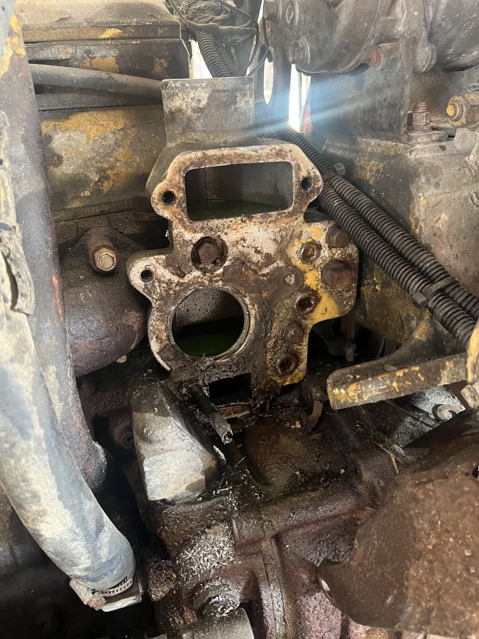

    Worked on this B model today. Boss wanted manifold removed so it can be planed and new gaskets installed.
    Once I got down to the thermostat housing, I’ve been fighting with bolts that refuse to budge. Managed to get 4 out of the 5 out but snapped off the bolt flush at the bolt head.
    I attempted to drill all 3 inches of 3/8 bolt to free the outer housing but only managed 1.25 inches.
    After much pry bar wiggling, wedging, tapping with a hammer, it finally came free.
    Then attempted to get the bolts out of the back housing. Got all out but one. Same thing as before, snapped the bolt head flush.
    This I see is even worse. I can’t take anything apart from that back thermostat housing as it covered the bolts for the water pump plate.
    Pry bar doesn’t move it, chisel doesn’t move it, heat from the torch doesn’t help move it.
    Finally had enough, got the 8 pound sledge.
    After a few blows, the housing separated from the head enough to allow me to get in there with a sawzall and cut the bolt off.
    So now both halves of the thermostat housing is off.
    Tomorrow I’ll get the cut bolt out of the head then remove the manifold.
    All new bolts will be going in with lots of anti-seize.
    And possibly a new turbo. The old one puked oil into the intercooler which I will have to clean out too.
    I probably wouldn’t have to remove the thermostat housing but all the others I’ve removed came off easy and allowed more room to work in there when doing manifolds.

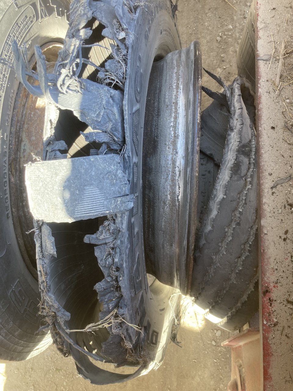

    12.7 Detroit has a miss…sorry bud, your gonna need more than an injector IMG_6211.jpeg fml the tread even managed to get wrapped around the axle and its not a recap IMG_6222.jpeg

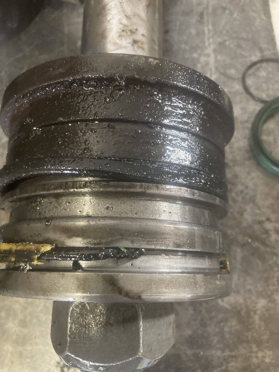

    How the hell does this cylinder stay up when the piston seal looks like this IMG_6223.jpeg
    Oh it leaks a little where the rod comes out

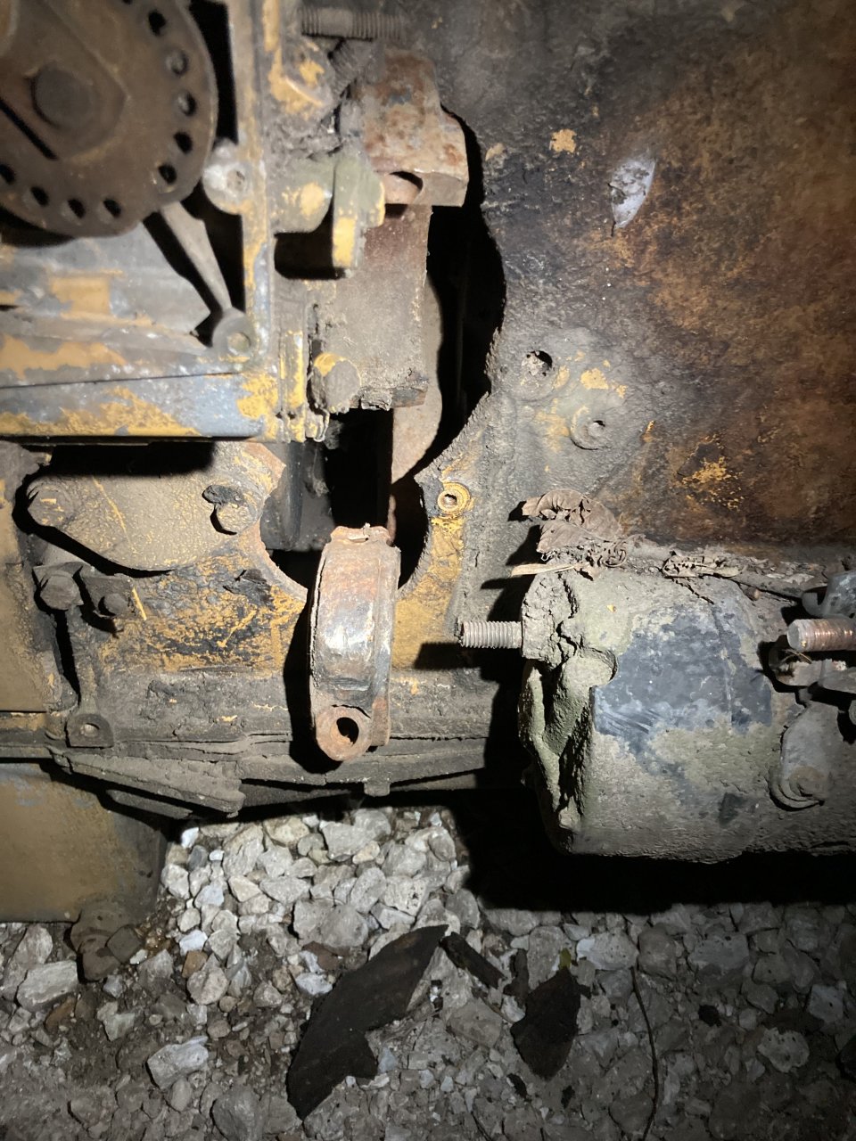

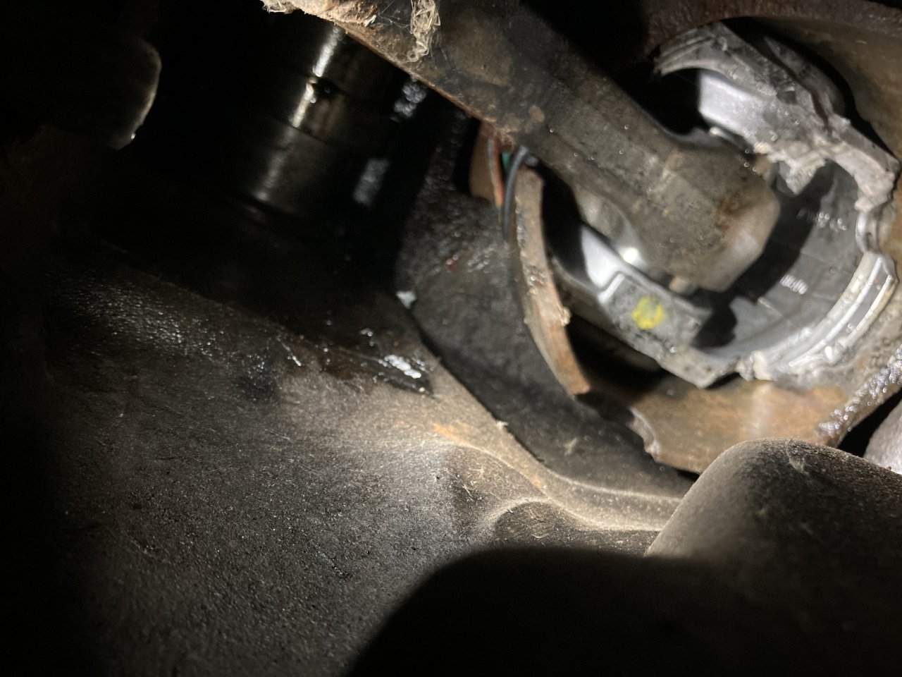

    for your viewing pleasure…
    I know nothing about what happened it’s just a truck I bought for parts. Good thing I only want the rear housing and engine mounts lol

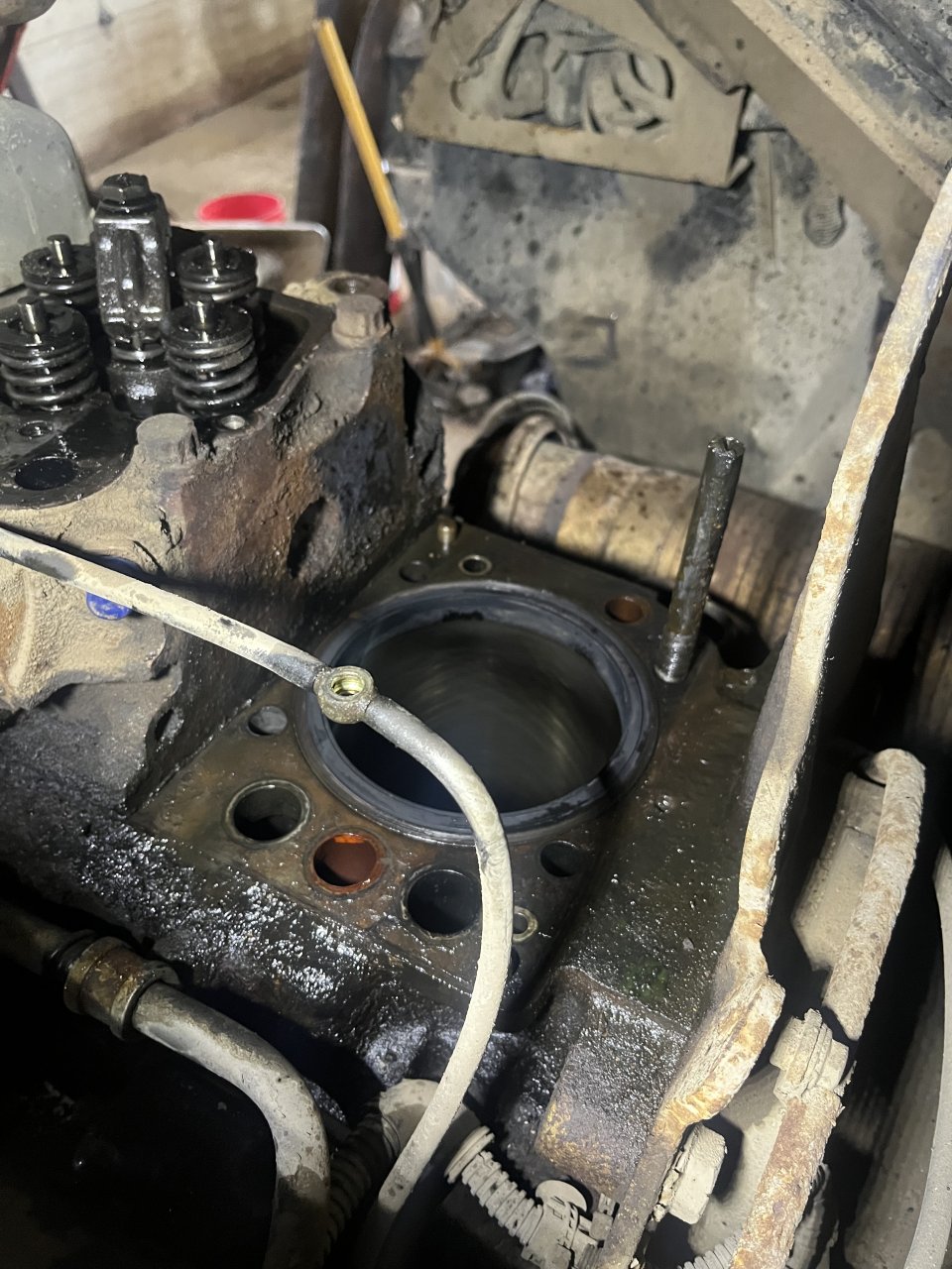

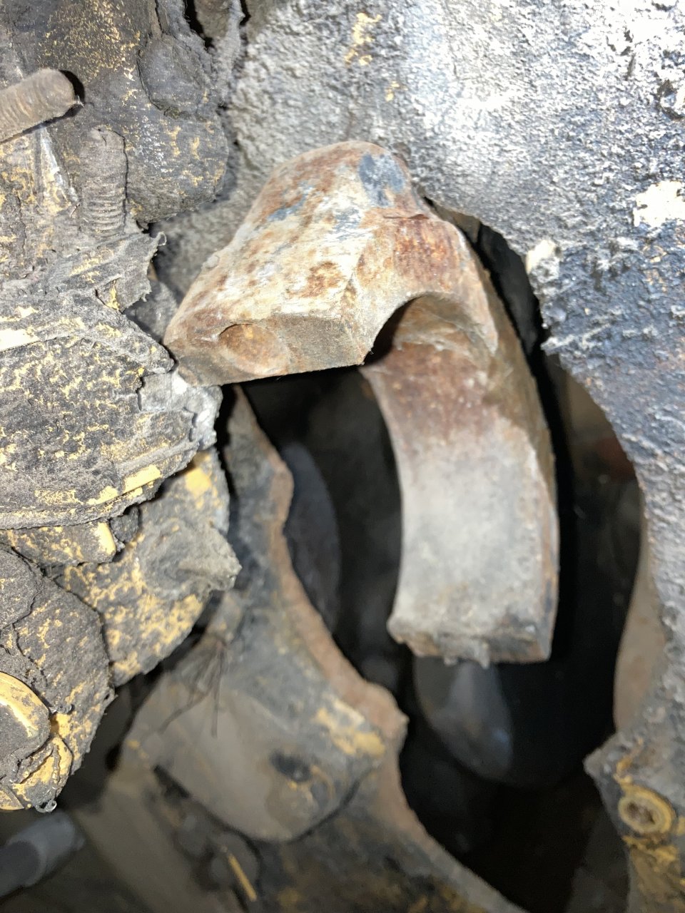

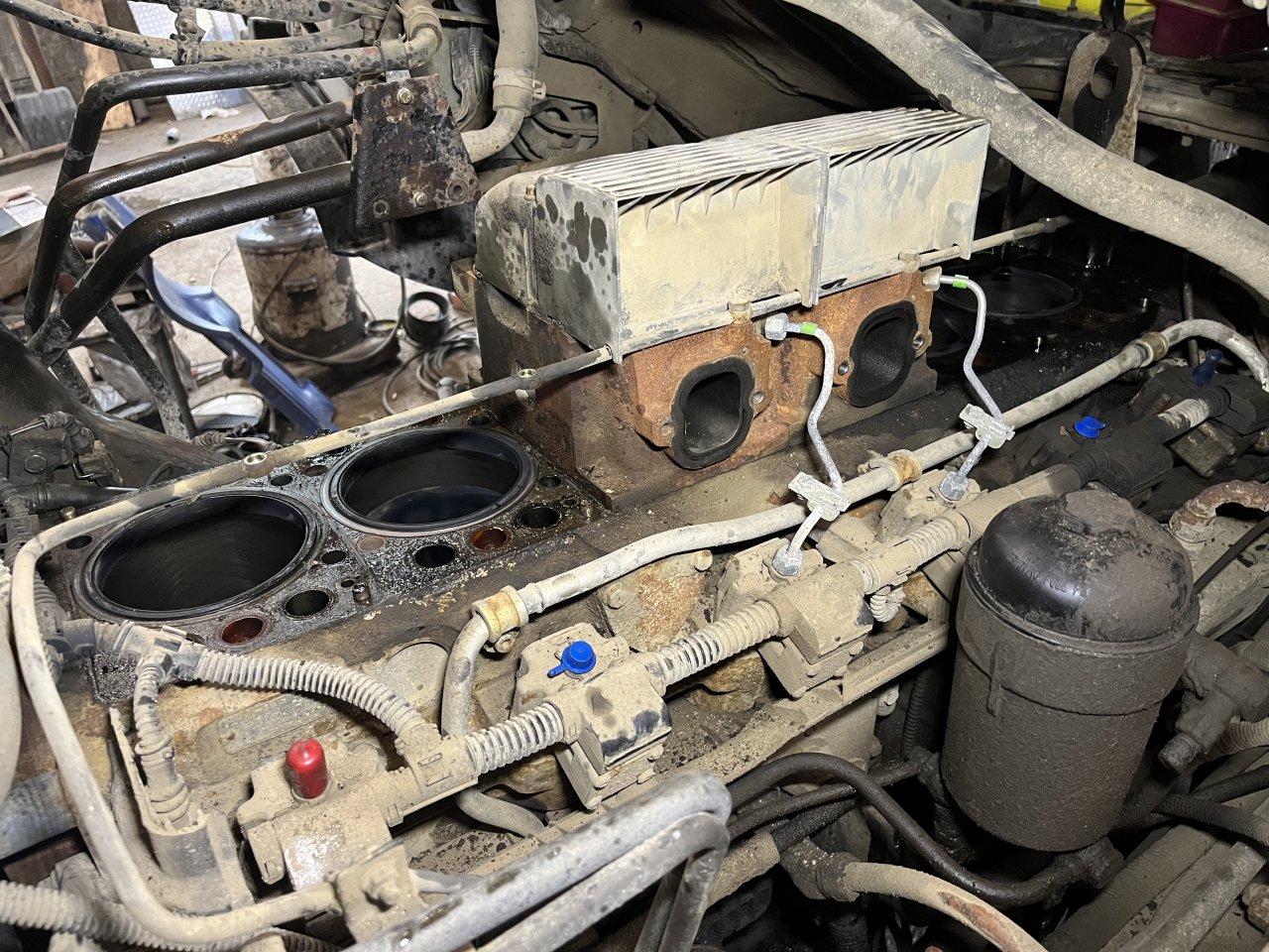

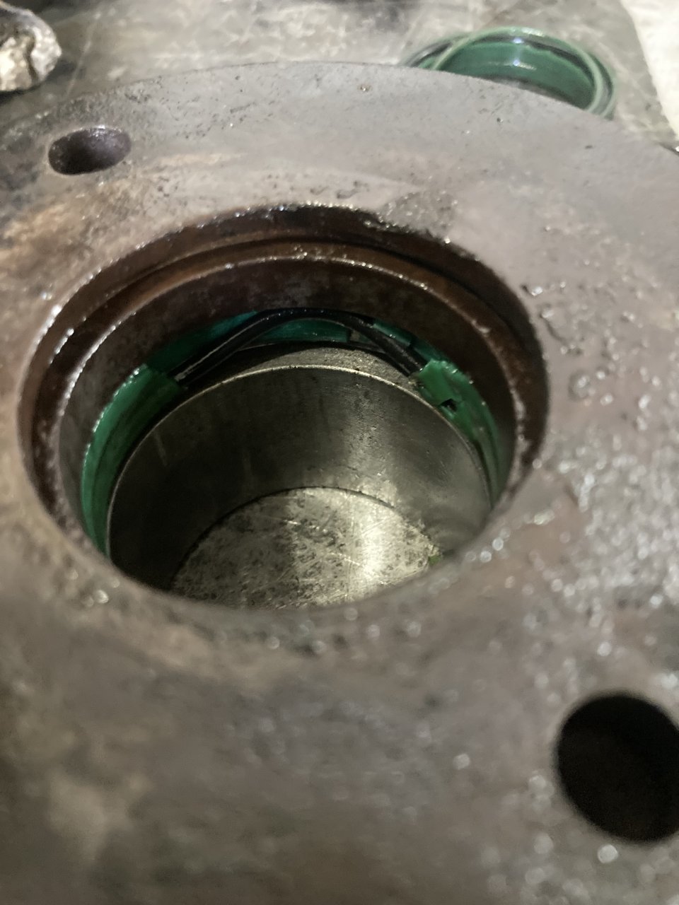

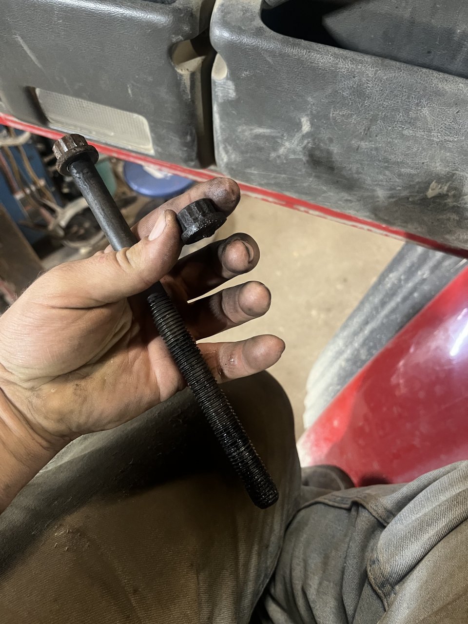

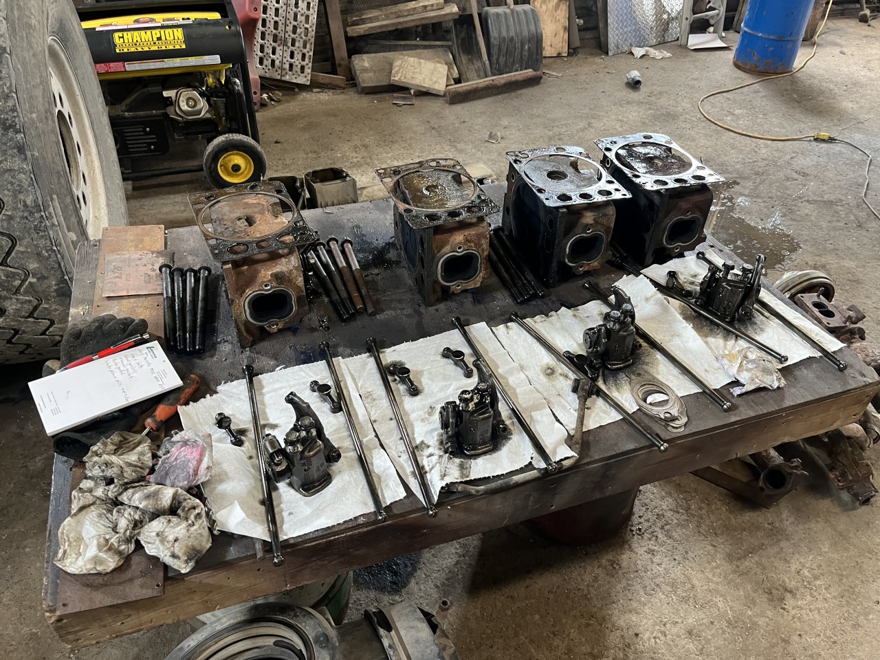

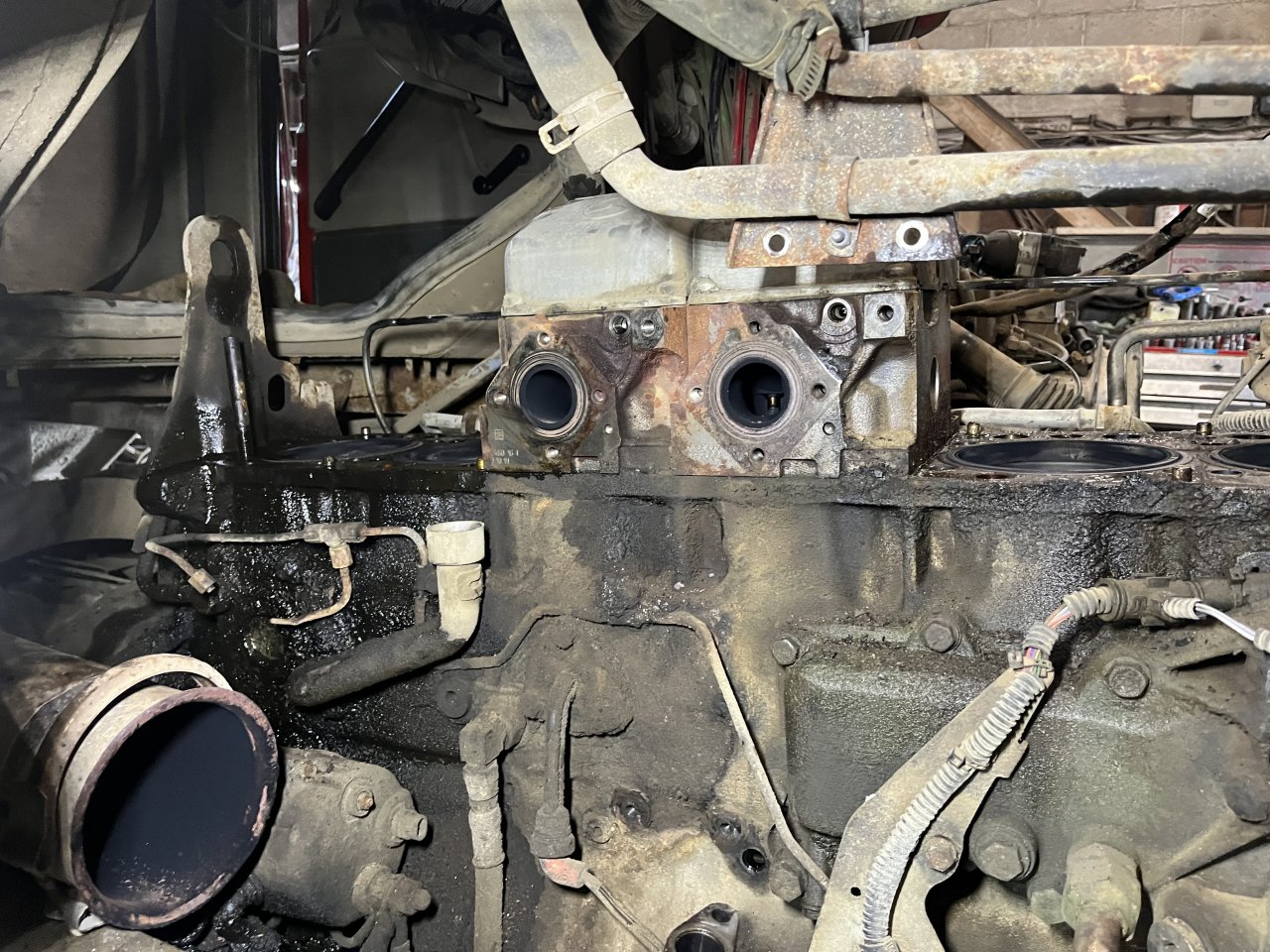

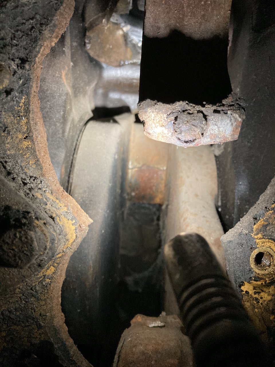

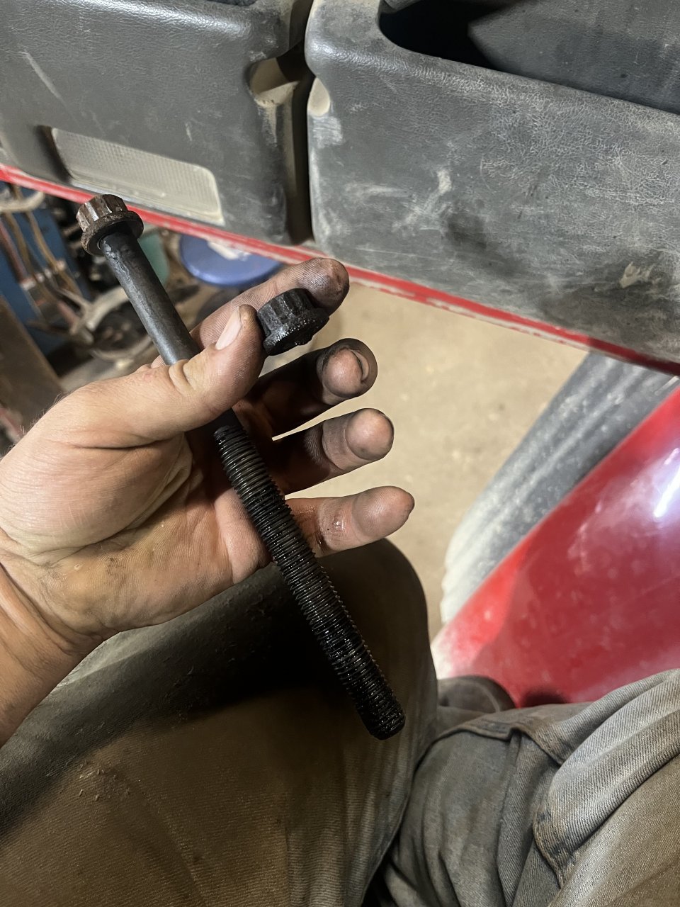

    Currently working on a Mercedes MBE4000 in the shop.
    It makes gun shot sounds when starting up and fumigated the cab with antifreeze mist.
    Upon tear down, the cause of the head gasket failure is the head bolt.
    Of all the diesels I’ve worked on, this one
    Is easy.
    665738A0-5DFA-411C-93E3-F21F23C16740.jpeg FD317ACC-3133-472F-A2C2-8AD718DA624E.jpeg DE5D5A04-15A7-4040-9DC0-E6D03C159B23.jpeg 13091533-8354-4D42-9B3F-EAC26F779A1D.jpeg 90BC6383-2197-4BAD-AB14-3B214CEF3A4D.jpeg

    I’m assuming they are for the Mercedes. I’ve pretty much always re-used the head bolts on every engine I’ve worked on and had no failures.
    After learning from a friend of mine that worked as a trucker on a farm, his truck blew a gasket in the same brand engine and a mobile mechanic replaced them. He re-used the head bolts
    Three days later the new gasket blew. The head bolts broke.
    So for this engine I’m working on, all new bolts for sure. They are smaller diameter than cat bolts if held beside each other.
