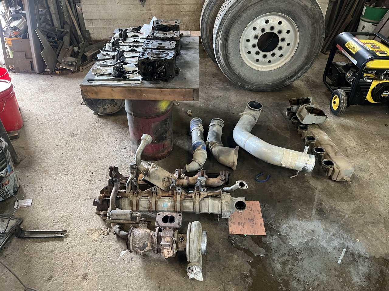

    This is all the parts that came off the Mercedes. Hardly any parts. No over head crane to lift a head.
    Dale thompson and Feedman Thank this.

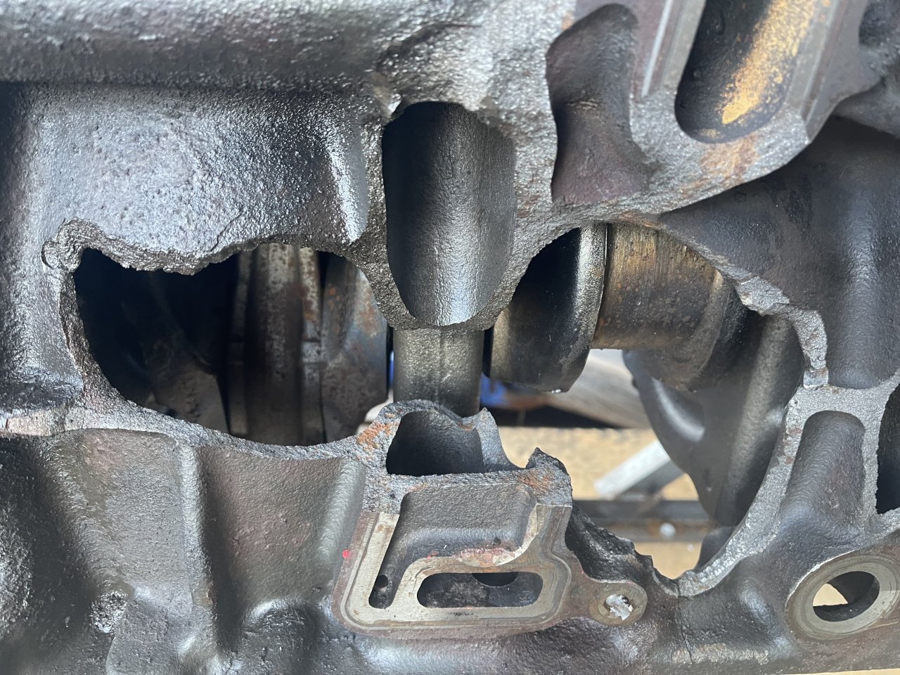

    IMG_3328.jpeg IMG_3327.jpeg Who says mechanics can’t install windows……..?
    Tech spent 1/2 day torching out the connecting rod to get it to bar over enough to access the torque converter bolts to separate the trans.

    In for a slight oil leak?
  10. Goodysnap
    Goodysnap Road Train Member
    3,816
    9,304
    Jul 12, 2017
    Least it was easy to diagnose……
