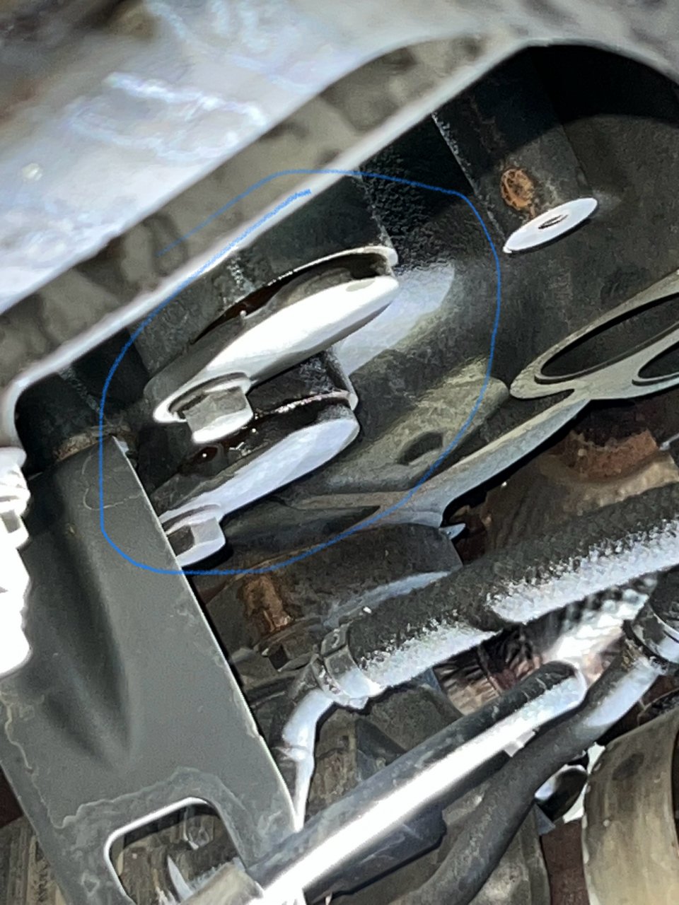

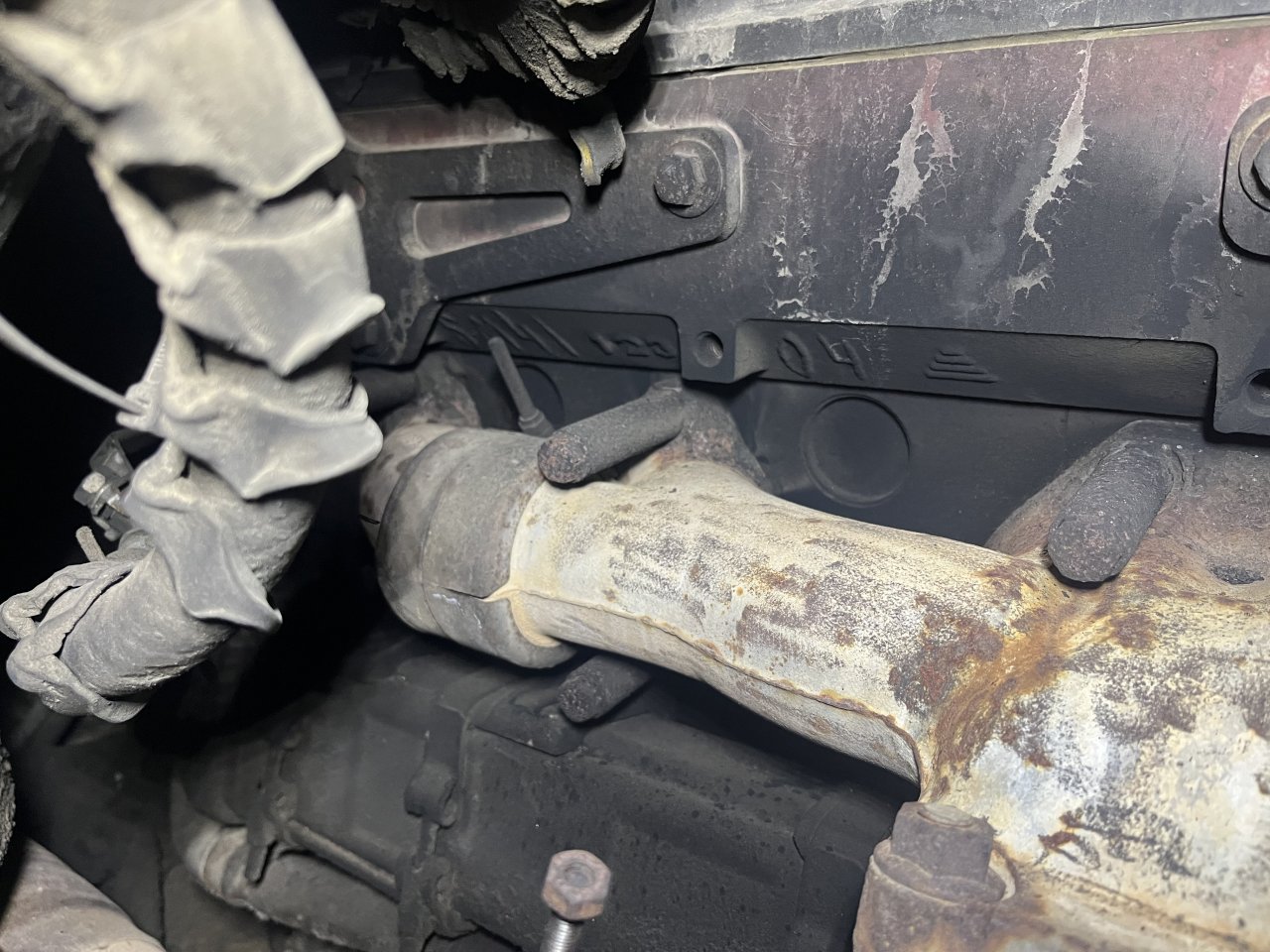

    IMG_2664.jpeg I’m new here can anyone tell me why these are seaping coolant and are there a gasket behind them ? 2020 Pete 579 paccar Mx 13

    Can you take more pics from farther away. Trying to tell where they are on the engine. Then I can help. Last 8?

    I'm guessing there is o-rings on them and could be hard/brittle from heat and seeping.

    I found them.....
    Confirmed coolant seal plug with O-ring. 26mmx2mm
    Plug Part number - 2000736
    O-ring Part number- 1922082
    New o-rings should do the trick- as others stated they can get hard and brittle over time
    Both are the same part number- shows 2

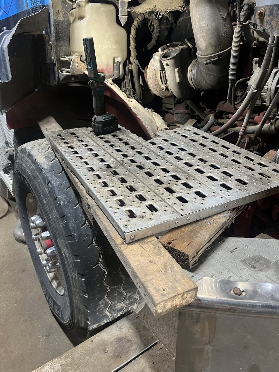

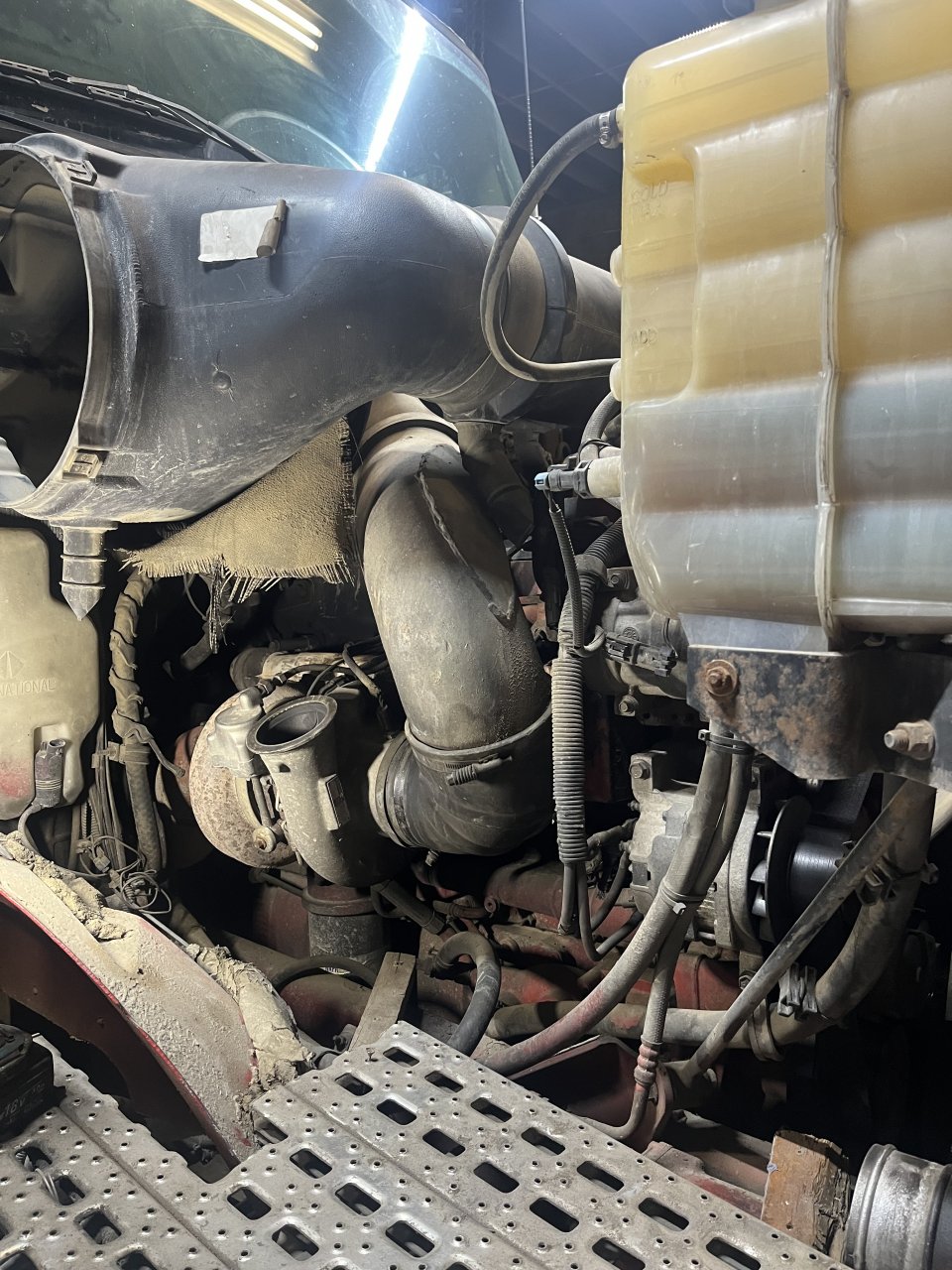

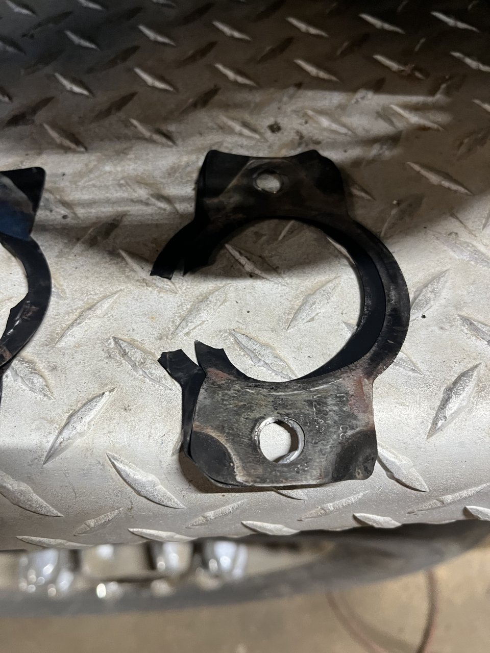

    2005 International 5600 with Cummins isx cm807. Engine was overhauled a few years ago with a PAI kit.
    Recently the cab started filling up with the smell of black smoke and exhaust. Fumigated the driver out of the cab.
    Brought it in for repair. Set up a platform and short ladder due to the height of the truck as it is a twin steer.
    Those VGT turbo’s are not light.
    I’m 6 foot 2 and the engine is almost as high as I am.
    Engine block is black instead of red Cummins paint.

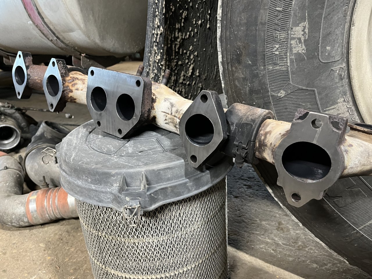

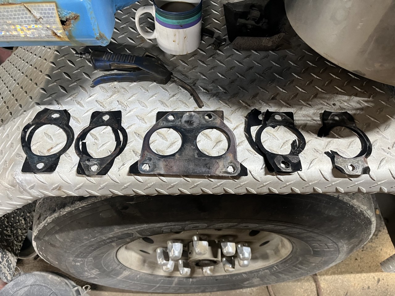

    Got the manifold off.
    I was expecting the rear two exhaust ports to have blown gaskets only to find the front two are blown as well. The center two are fine.
    Sent the manifold away to be planed. The machinist says that’s a common problem and has a fixture just for that. Easy fix.
    looks much better now.
