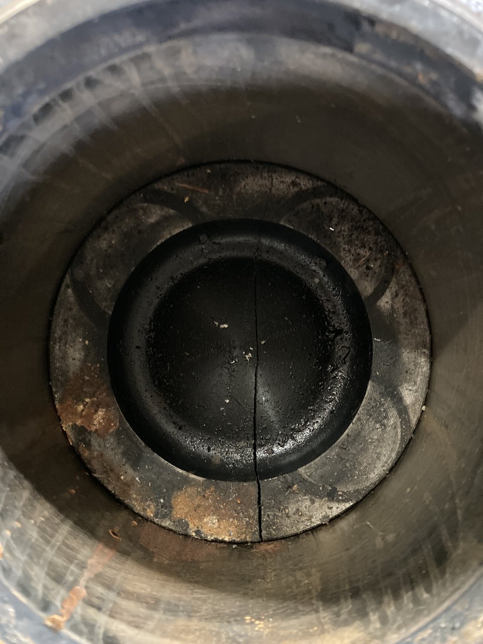

    is this what they call a two piece piston…..

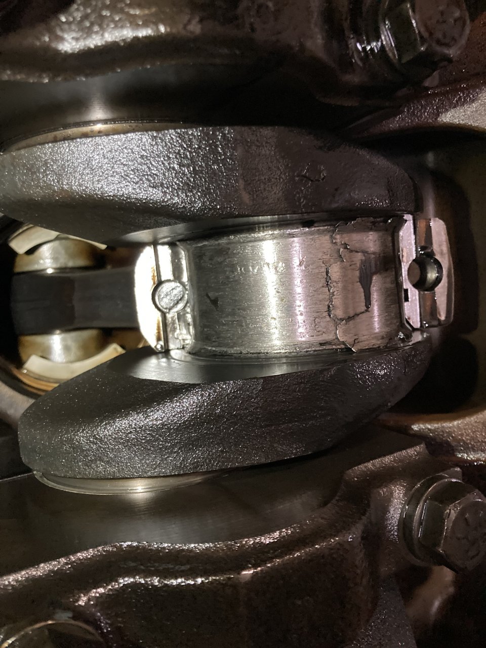

    customer did a rebuild on a 14l 60 series….apparently there were some problems setting the overhead
    Both 1 and 6 were like this on the exhaust only

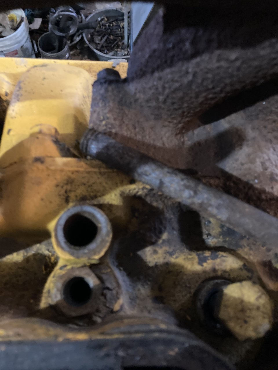

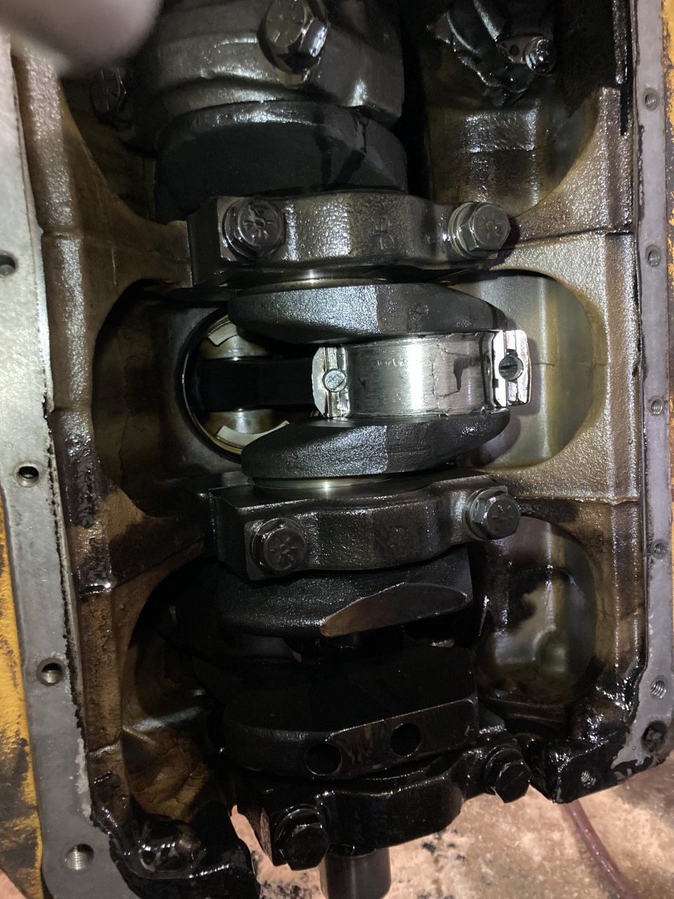

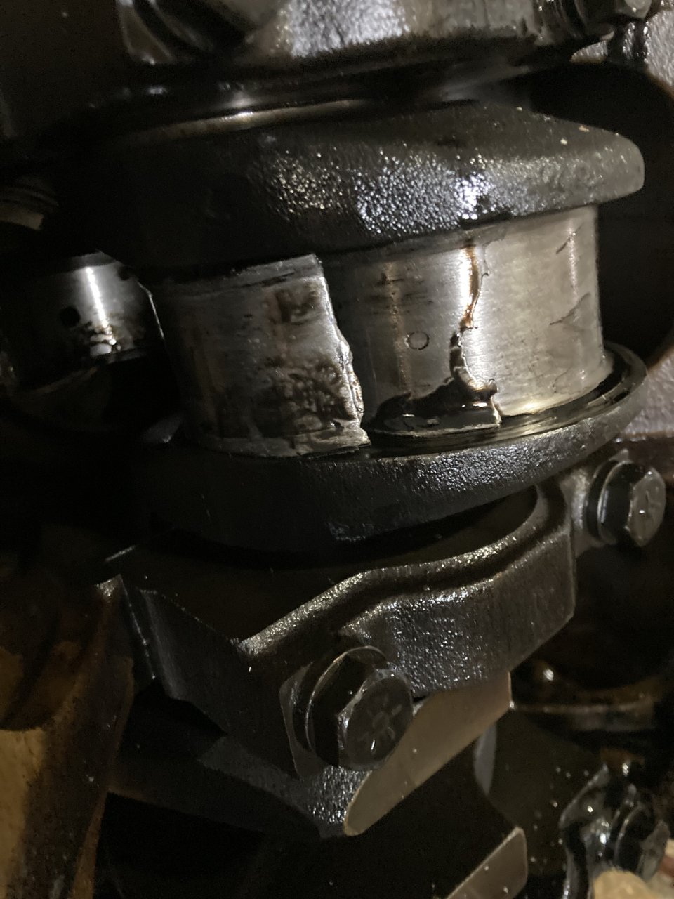

    # 1 does not look too good…the rod problem was #2 and it spun a main bearing on #4
