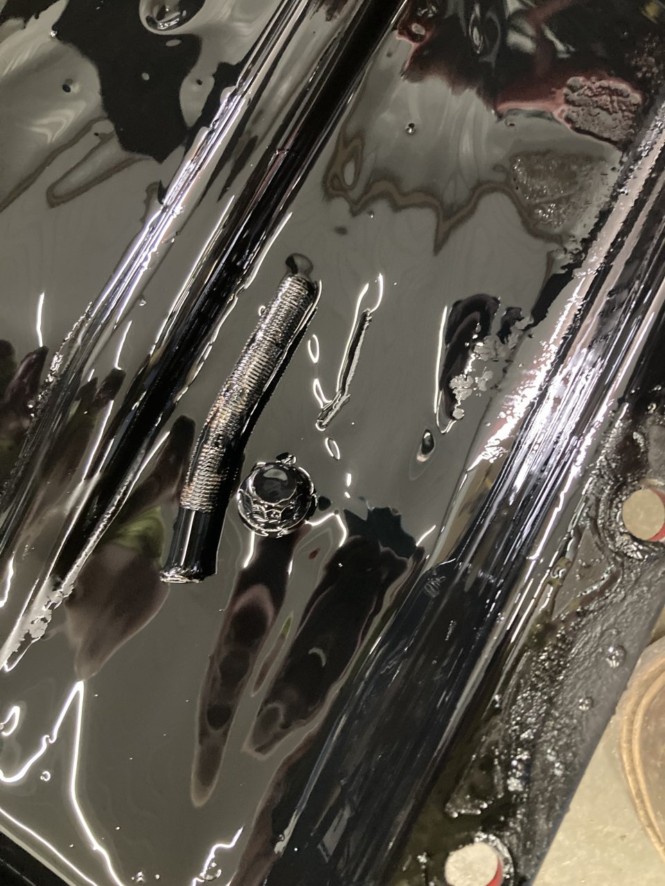

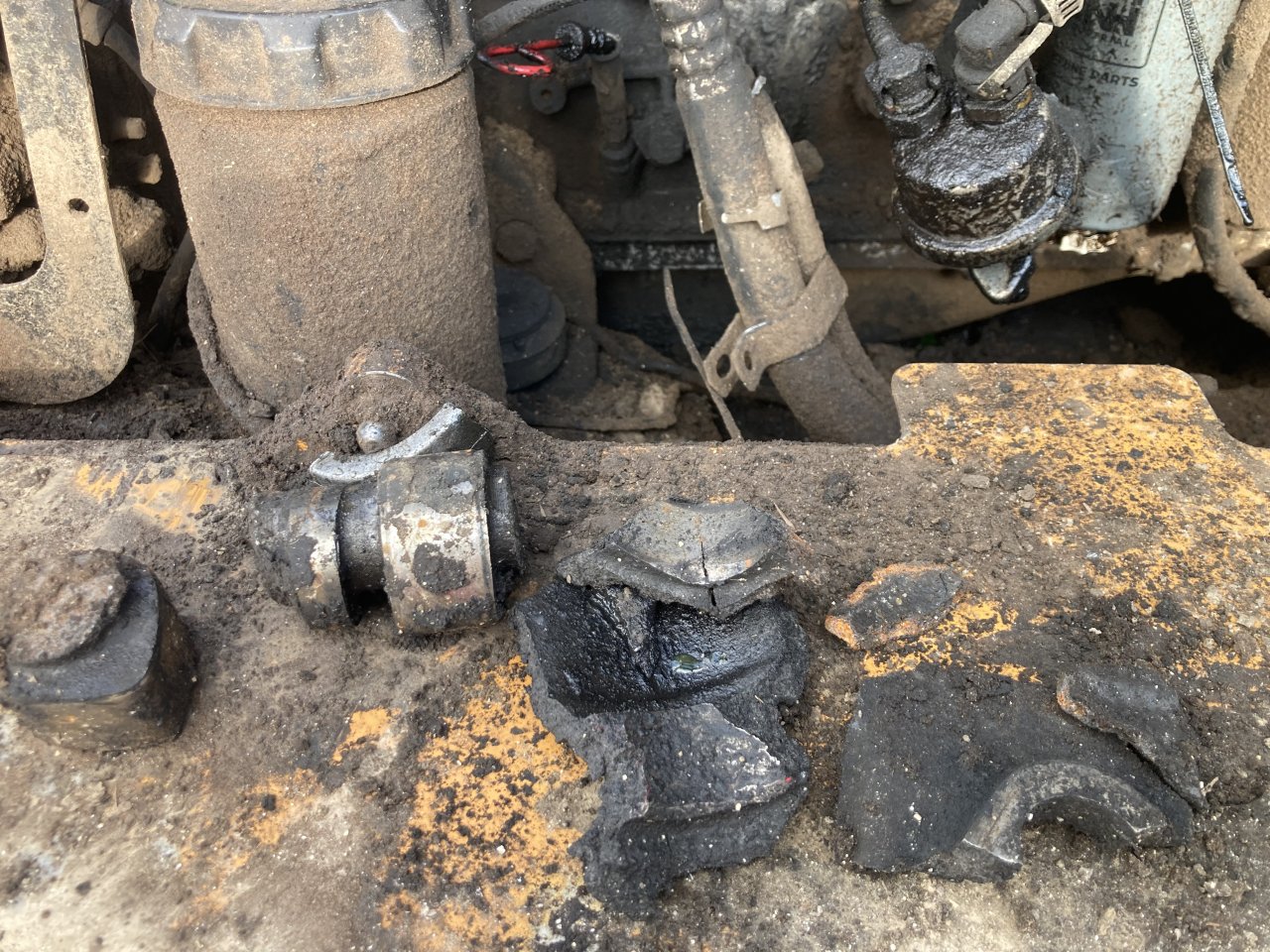

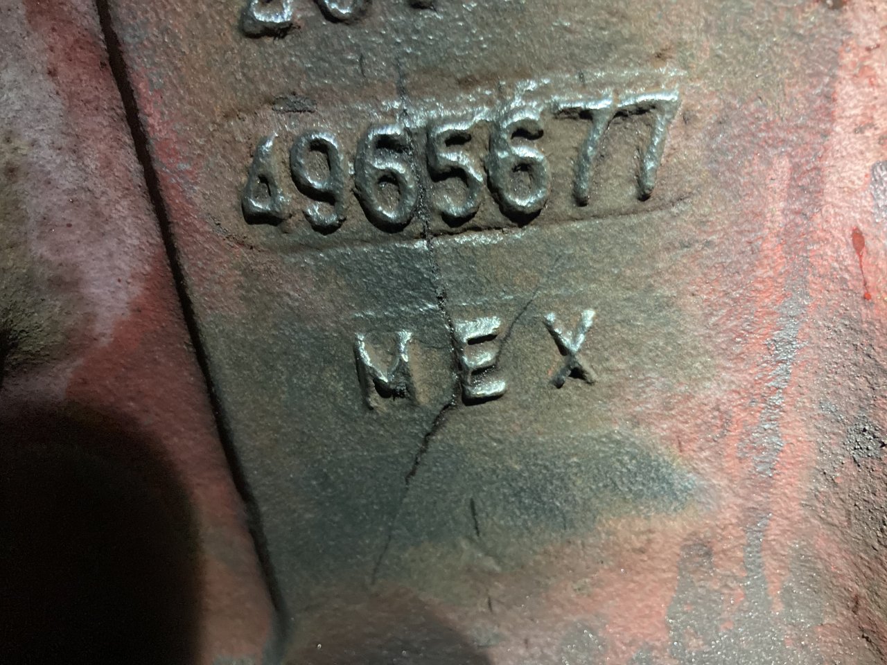

    Dude must be the luckiest guy around because the cap from that rod was in the oil pan and he drove it into my shop….all I can figure is the bearing shell was welded together and enough to the big part of the rod to hold it or the cap literally fell off as we were pulling the engine
    Looks like a crank grind and a new rod and it will probably live another day

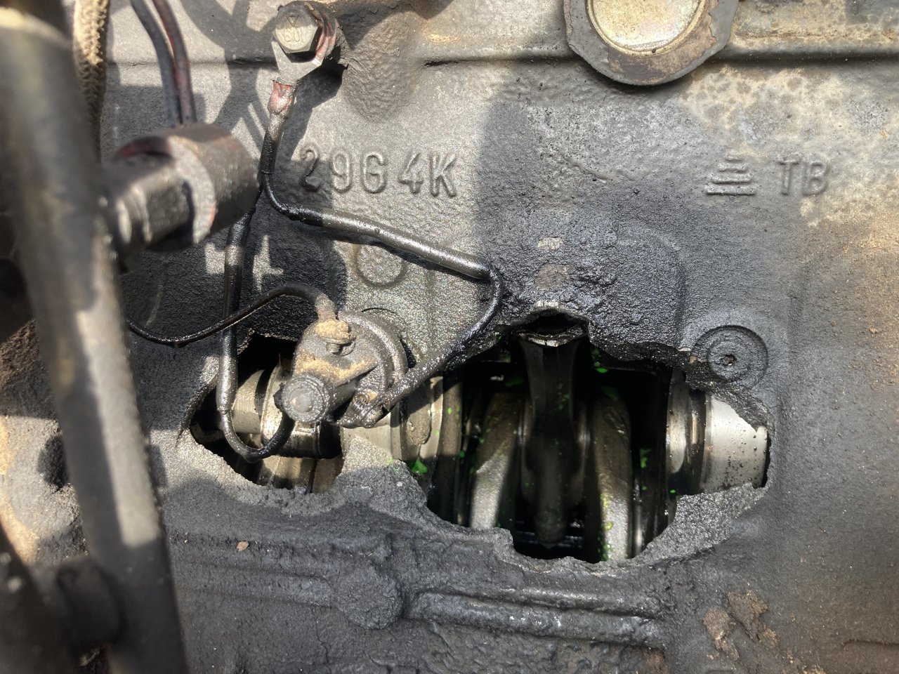

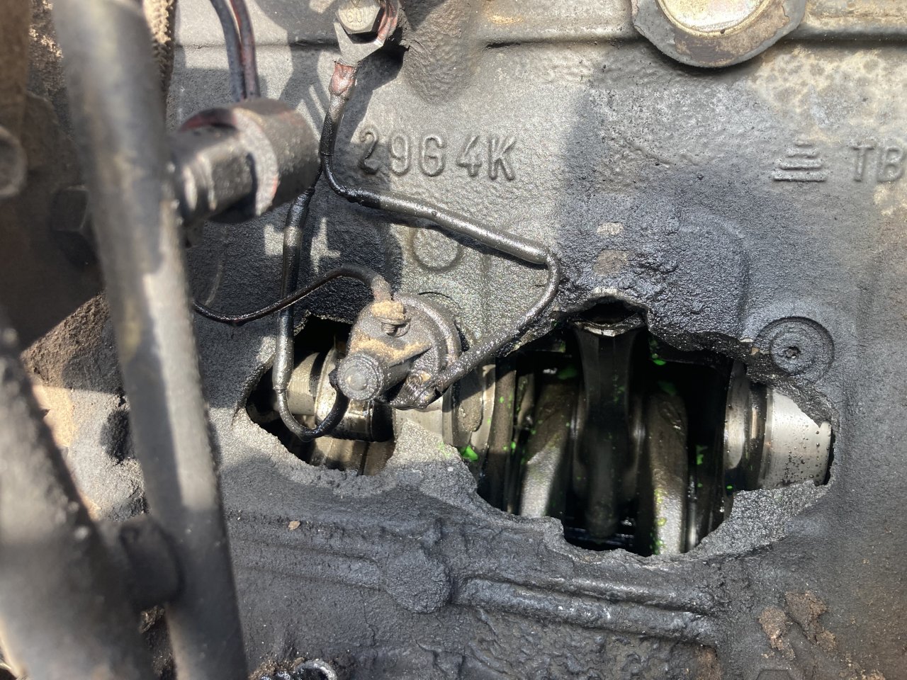

    easy inspection of the cam shaft….
    6.7 iveco in a case payloader supposedly got overheated then developed a knock when they restarted it after it cooled down
    It appears maybe the top broke off the rod
    Anybody know how the wrist pin is lubed on these?

    IMG_2606.jpeg Kinda hard to see, but A26 with a hole big enough to put your fist in.
    rollin coal, W923, Feedman and 5 others Thank this.

    . Yup I had to look for a moment to notice the jagged edge of broken cast is that the rod cap taking a peek outside?
    Isafarmboy, W923, Feedman and 3 others Thank this.

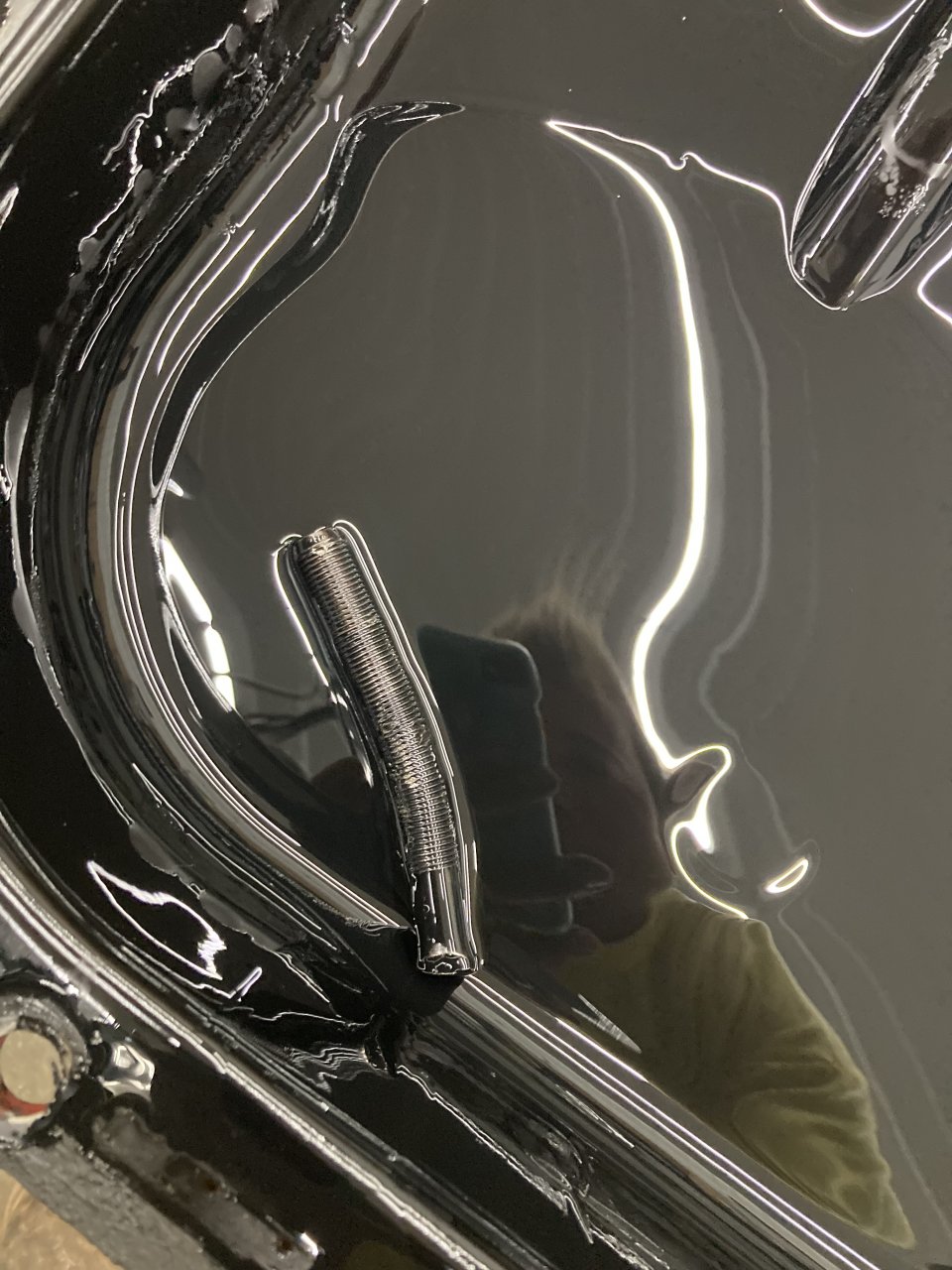

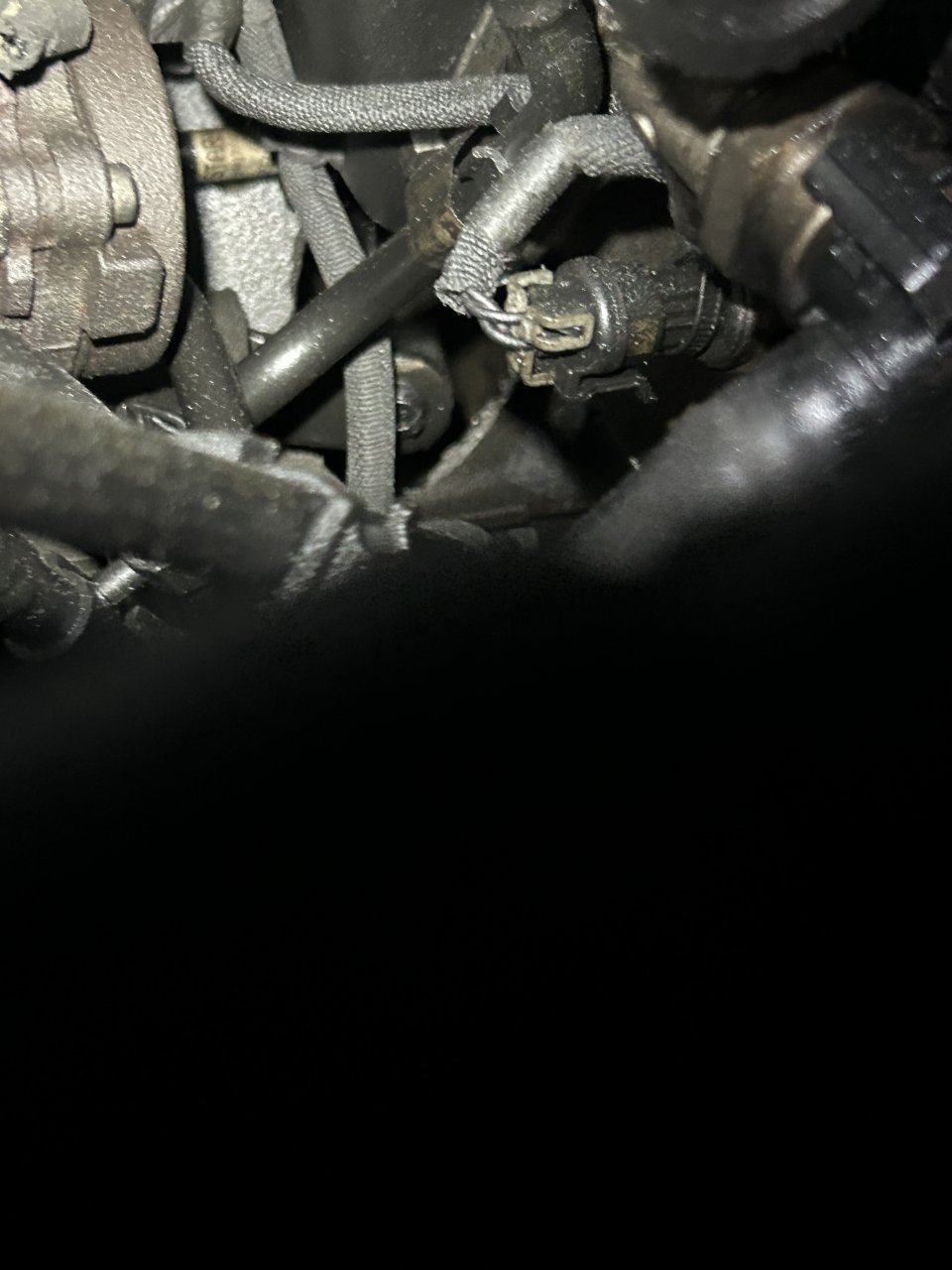

    signature 600 broke a rod bolt and it couldn’t fit between the con rod and the block
    It appears the head popped off and then the rest vibrated out
    Anyone else see this
    Otherwise everything seems fine

    That’s the end of a bracket. No good angle to get a pic. They try to pack 10lbs of crap in a 5lbs bag.
