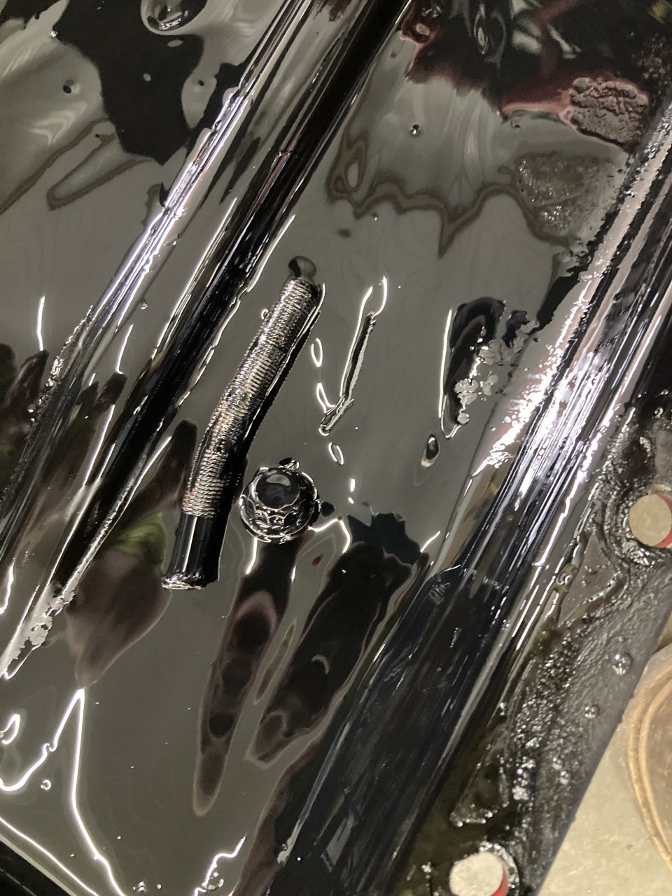

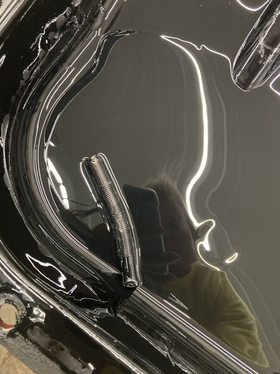

I have seen so many failures after a repair with Cummins connecting rods that I now change all rod cap bolts with new whenever they are apart.
Are all the other bolts on that rod cap tighted to spec? Since this is a signature 600 I’m guessing this is a machined rod and not fractured split?
I would inspect the rod and cap surfaces for fretting. If everything looks ok. Replace all the bolts and torque. Make sure the cap orientation is correct. Both numbers on the same side.
Click Click Boom!!!!!
