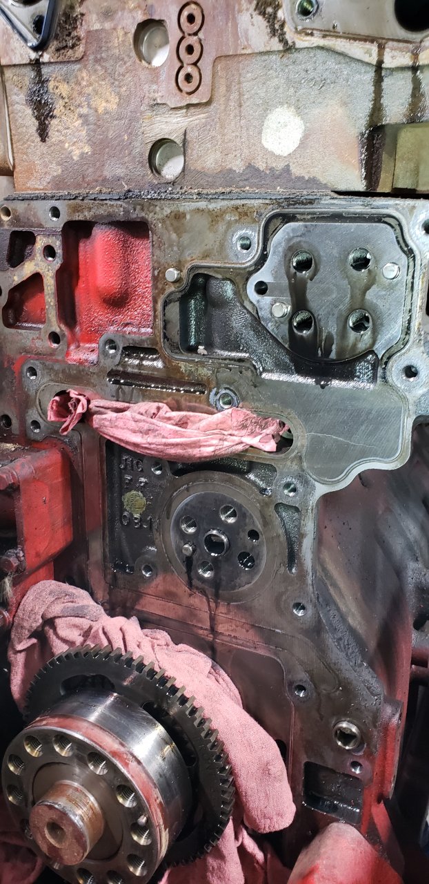

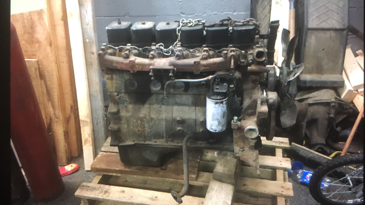

    While these Cummins 12v 5.9’s are legendary for their reliability and strength. They do have some weaknesses.
    This came out of my boss’s pickup.

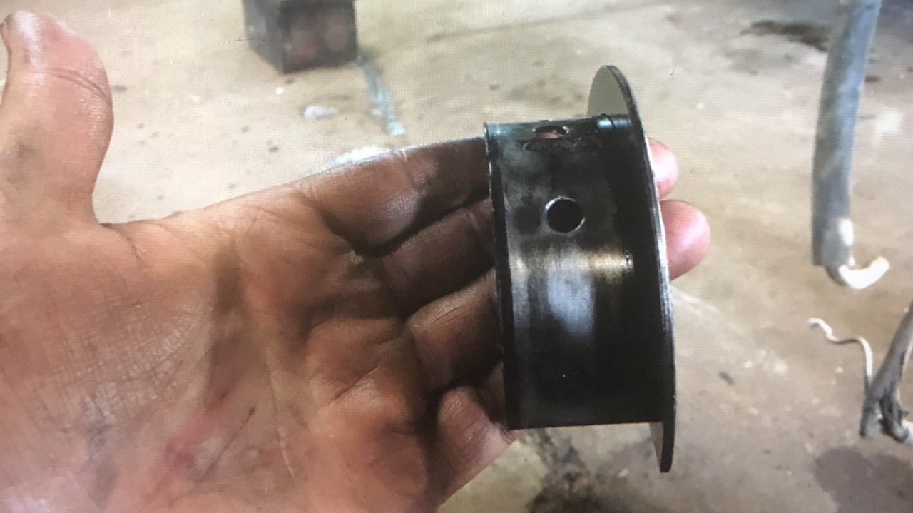

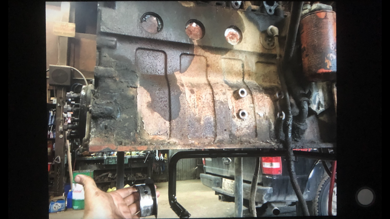

    This is the replacement engine for my boss’s truck. We pulled the pan to inspect the engine before the installation.
    Turns out this engine was on borrowed time too. The 3 piece Thrust bearing broke. A not so common but very serious issue for all Cummins 5.9 to 6.7’s.
    If we had not checked, this engine would’ve had a windowed block at the same spot as the last engine.
    The upgraded part is the one piece thrust bearing either from Cummins or Clevite.
    But Cummins still makes these 3 piece thrust bearings during manufacturing to this day while offering the upgraded one piece bearing as a replacement for years.

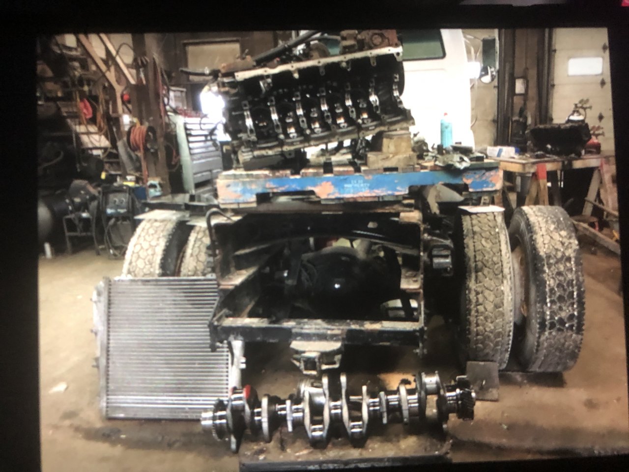

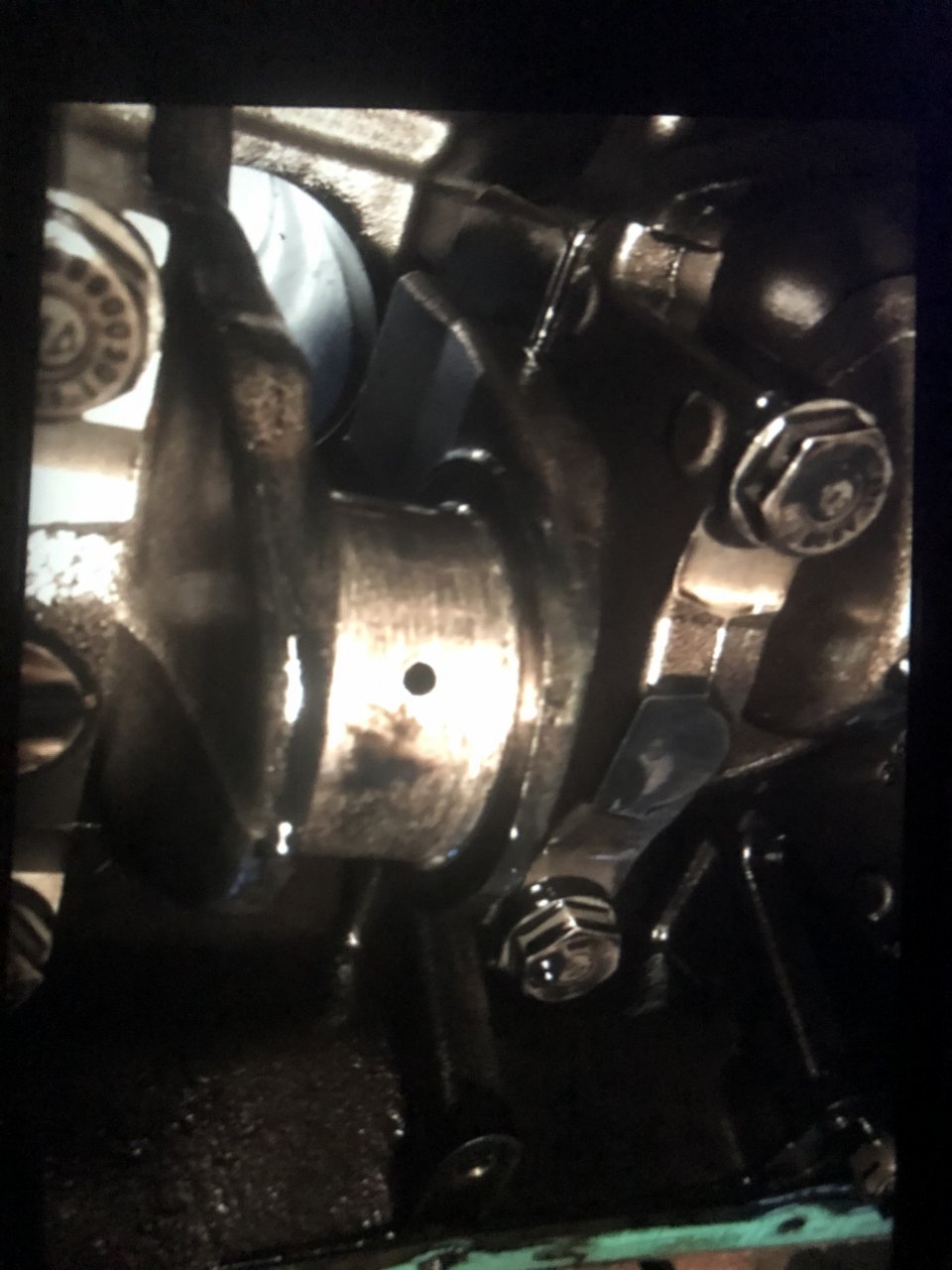

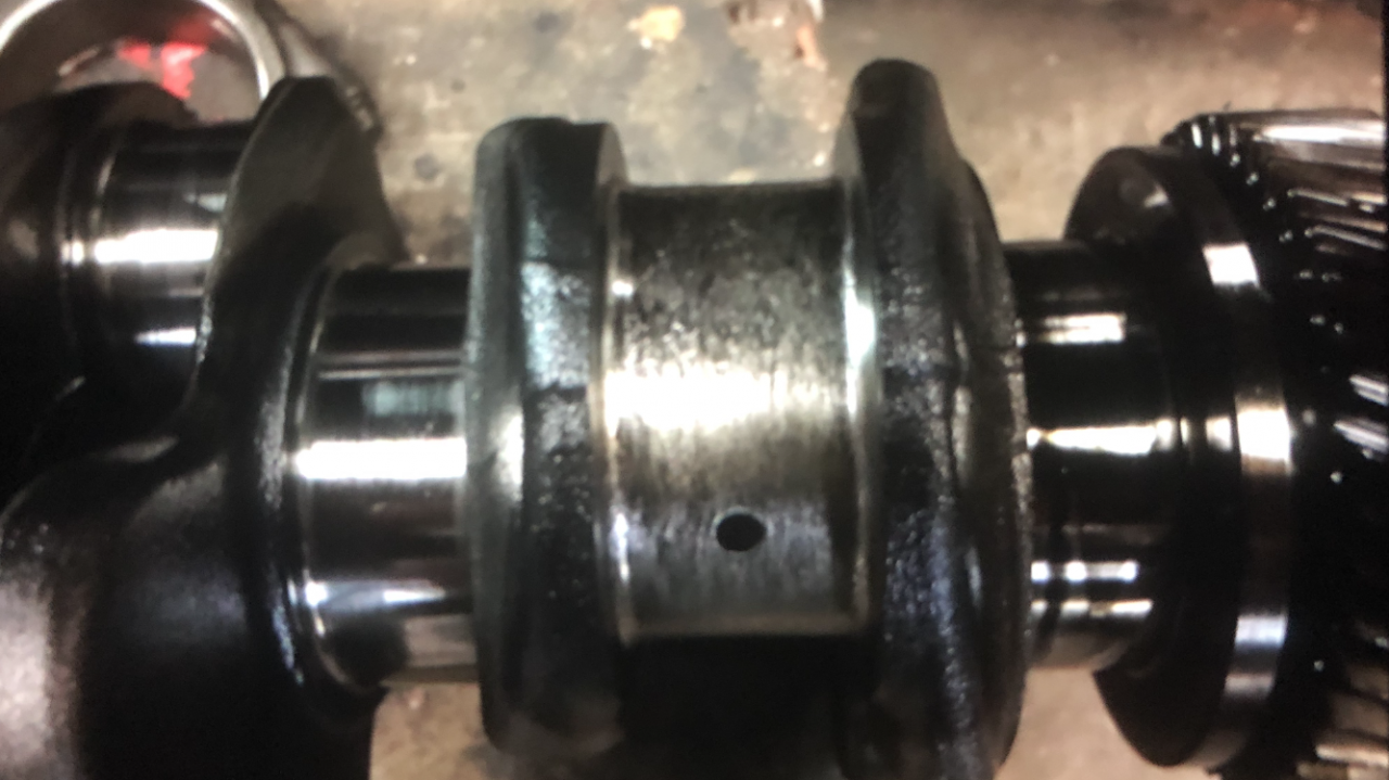

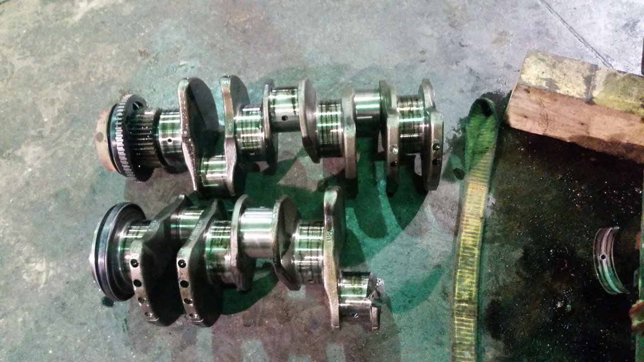

    This is the 2005 Mercedes Benz MBE900.
    My boss bought this truck for really cheap. The engine was noisy.
    #5 rod bearing was gone.
    EF9D8F19-F346-4921-8F0C-FD8B366C339D.jpeg F425820F-052E-4D93-899D-4A282DF472A5.jpeg B6728F47-40C2-4490-9571-40F0F18BED2B.png
    The cost to rebuild this engine was more than the cost to buy a used engine from a truck wrecker so we scrapped this engine.
    The engine we got from the wrecker, we pulled the pan and sure enough, #5 rod bearing was gone too, crank looked like the pictures as well, no need to take more pictures.
    Wrecker gave us another engine free of charge. This one looks perfect inside. So in the truck it went.
