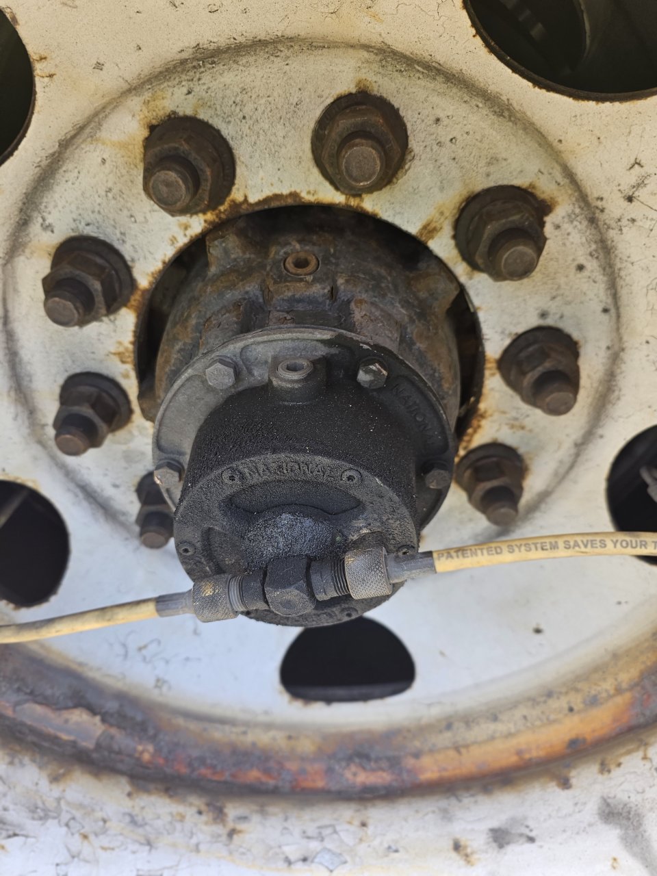

    Maybe I was blaming the drivers too much when a Climate 'mechanic' tells me it's normal for a hub to be seeping oil and to just run it as is. Worst case is the wheels detach themselves and strike a mini van loaded with kids -- no biggie. Line up of brand new trucks on the lot and every other trailer has seeping hubs makes sense, I reckon.

    Tell em to at least make sure ya got hubcaps that are clear enough so ya can visibly check the gear oil level. I always carried a bottle with to be able to top of hubs as needed. Uh yea should it be replaced, well of course it should. That being said though, sometimes ya gotta top some off to feel safe about the operation.

    I carry a bottle -- problem is half of them are so hazy, it's hard to tell. If a hub cap coated in oil isn't enough to motivate a replacement, I don't think me saying 'I can't tell the level' will work

    Well I can tell you are 100% all about checking out an maintaining equipment. That being said, keep an eye on hub an tire temps and be a checking inside the drums for inner seal leaks. If ya do those things and are satisfied that you're not having leaks an excessively hot hubs than that should put your mind at ease. You obviously know the drill, so just make sure you feel comfortable with the safe operation of things.

    It's hard to really see if it's actually oil leaking. Professor alluded to it in his post. I always have a spray bottle wipe it off and look if I'm unsure. Sometimes it's just dirt and grime buildup over not washing the wheels off. It looks like that same grime that you see on the reefer fuel gauge and tank sometimes. Then other times, I'll get a whiff to make sure it isn't oil. I know inhad them fix one not long ago and it was busted completely. The oil spewed everywhere on thay wheel. I'm glad I wasn't loaded all that heavy, because that would have been disastrous.

    They get messy in a hurry when they completely go. I've gotten (probably overly) paranoid about them after that story of the driver getting hit by a set of wheels and passing away in Ohio. Maybe I just need to take a deep breath at some point :D
