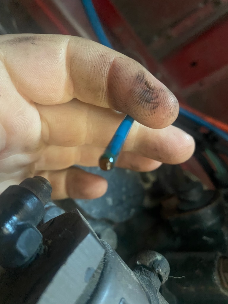

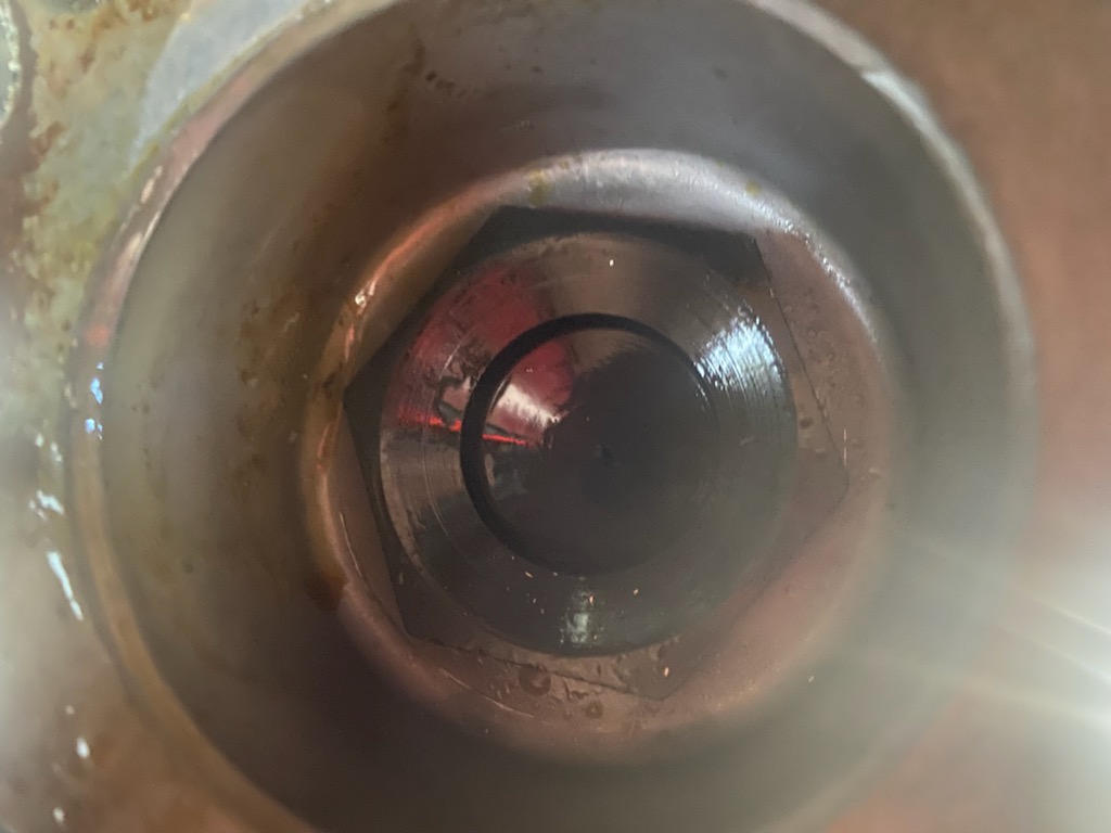

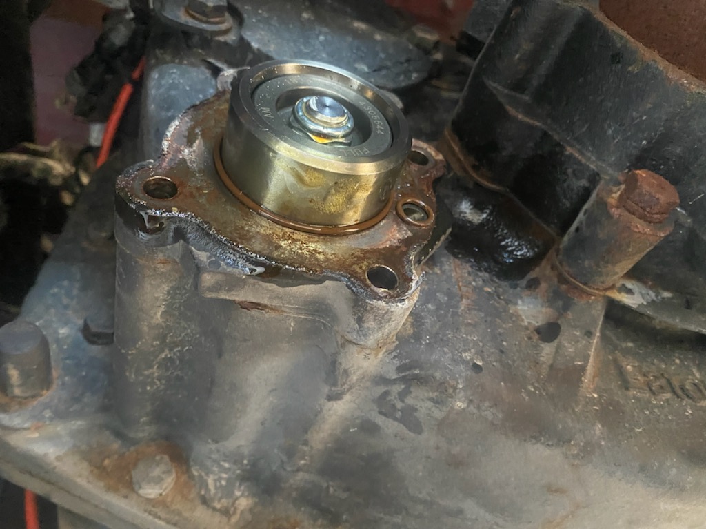

    The grinding noise ended up being an oil leak going into the trans. Replaced the o ring and she’s running well.
    Hopefully we can put this behind us now.

    i think you mean air leak
    Midwest Trucker Thanks this.
  4. Midwest Trucker
    5,917
    21,406
    Aug 31, 2018
    That’s what I would think as well but they called it an oil leak. Y’all prob know more then me.

    Its an oil leak......
    Trans oil leaks by the splitter piston o-ring and makes its way up the shifter air lines and causes delayed shift.
