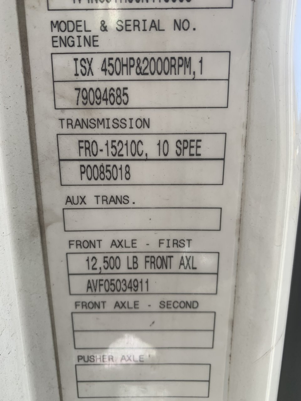

    I have an 06 ISX with a 10 speed Eaton Fuller. Yesterday my clutch started rattling as it was spinning. Almost like it’s rubbing something. It does it in every gear but 9th and you can hear it slightly at idle. No doubt it’s the clutch making the noise but the fact it’s smooth in 9th has me confused. I’m all ears guys. Thanks in advance for yalls help!

    Direct or OD 10 speed?

    I’m not sure I posted image of the door jamb

    FRO I think is an overdrive transmission, making 9th gear direct. Does it do it in 4th as well?

    I'm leaning towards internal transmission issue. 9th is direct, no torque is being put through any of the countershafts in direct. However without being there to listen I can't say for sure.
