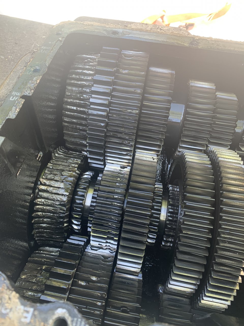

    FE7581EB-CAA7-4744-BE9F-3060A430BA9D.jpeg Mechanic got my transmission out. Here’s the damage.

    Input drive gear's kaput.

    How many miles on that gearbox?

    898k

    Sounds to me the bearing is out of the front of the tranny. 4th and 9th is when the slider is engaged with the gear that the input shaft drives

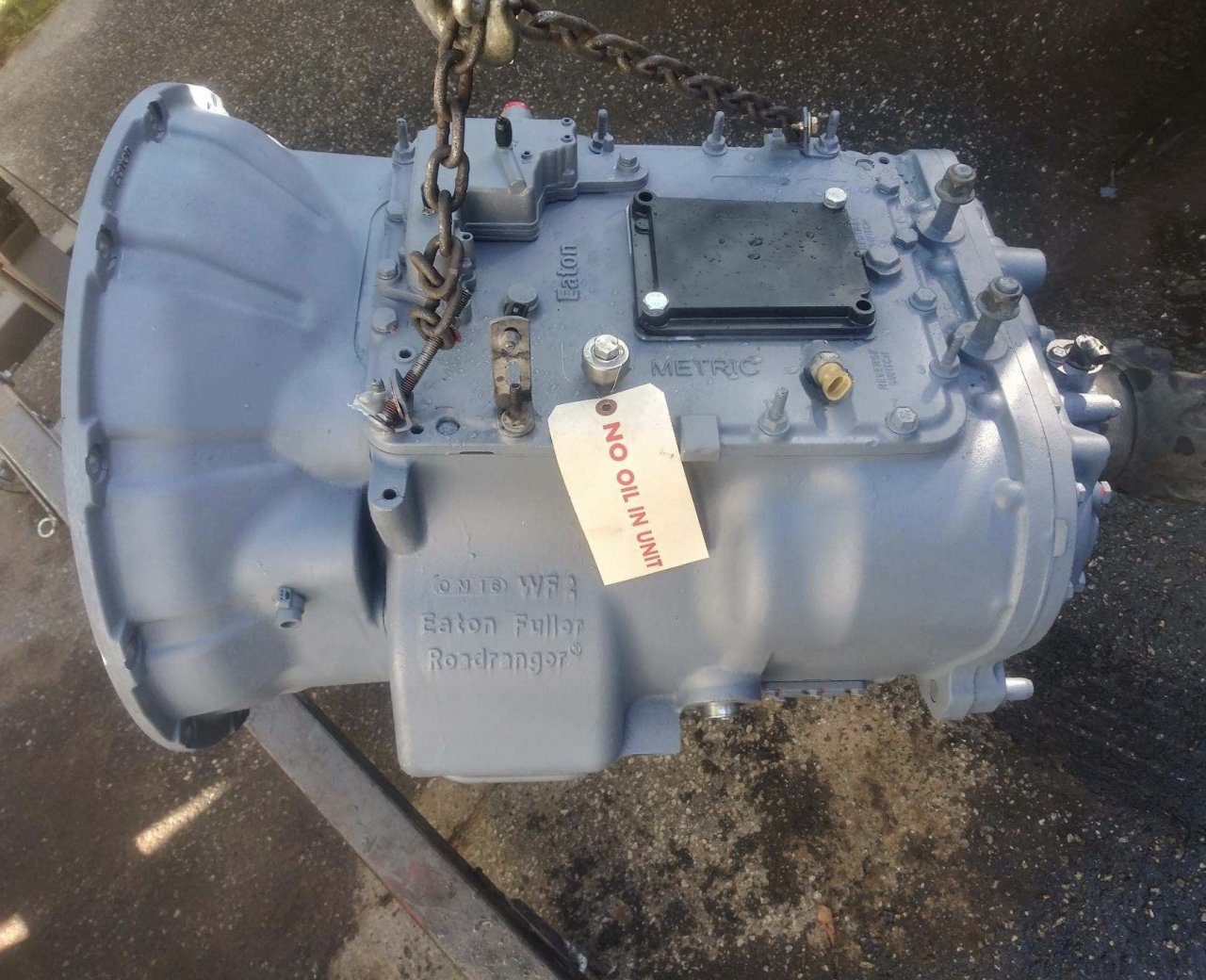

    About to drop a new one in

    Reman unit?

    Yea. Reman from TransAxle. 2 year warranty. I’m also going ahead and doing the clutch too

    Try not to abuse this one eh ;)
