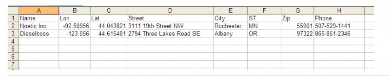

    Can you add a POI database to CoPilot and if you can is it complicated?

    It's not complicated if a guy has a basic understanding of files and drive folders. You need to find the folder where your CoPilot is installed. It will be something like "Alk Technologies/CoPilot/NA/North America/Save." You want to copy your POI file into that "SAVE" folder and if you want a custom icon to show on the map for that POI set, then put it in there too as a 24x24 .bmp or png image file.
    They use TomTom's .OV2 format or a basic .CSV spreadsheet format with headers. I just use a spreadsheet program like Microsoft Excel or Open Office to make them. It should look like this:
    CoPilot will recognize those particular headers (name, long, lat, lat, street, etc) as shown in that image and in that order.
    After you dump that file into the folder I talked about above, the next time you open CoPilot, it will bring up a POI import wizard that will let you name that set and assign it an icon for usage in the maps going forward. So again, you can use the OV2 or CSV sets widely available on POI Factory and lots of other sites as long as they meet those rules and dump them into the "NA/North America/Save" folder.

    I think a lot of us use a phone or tablet based version Dieselboss. Looks like those instructions are for the PC version which while useful not so much to most of us.
