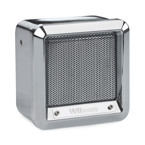

    Which external speaker? Cheap ones usually sound bad. This speaker sounds just fine.

    Cobra S500
