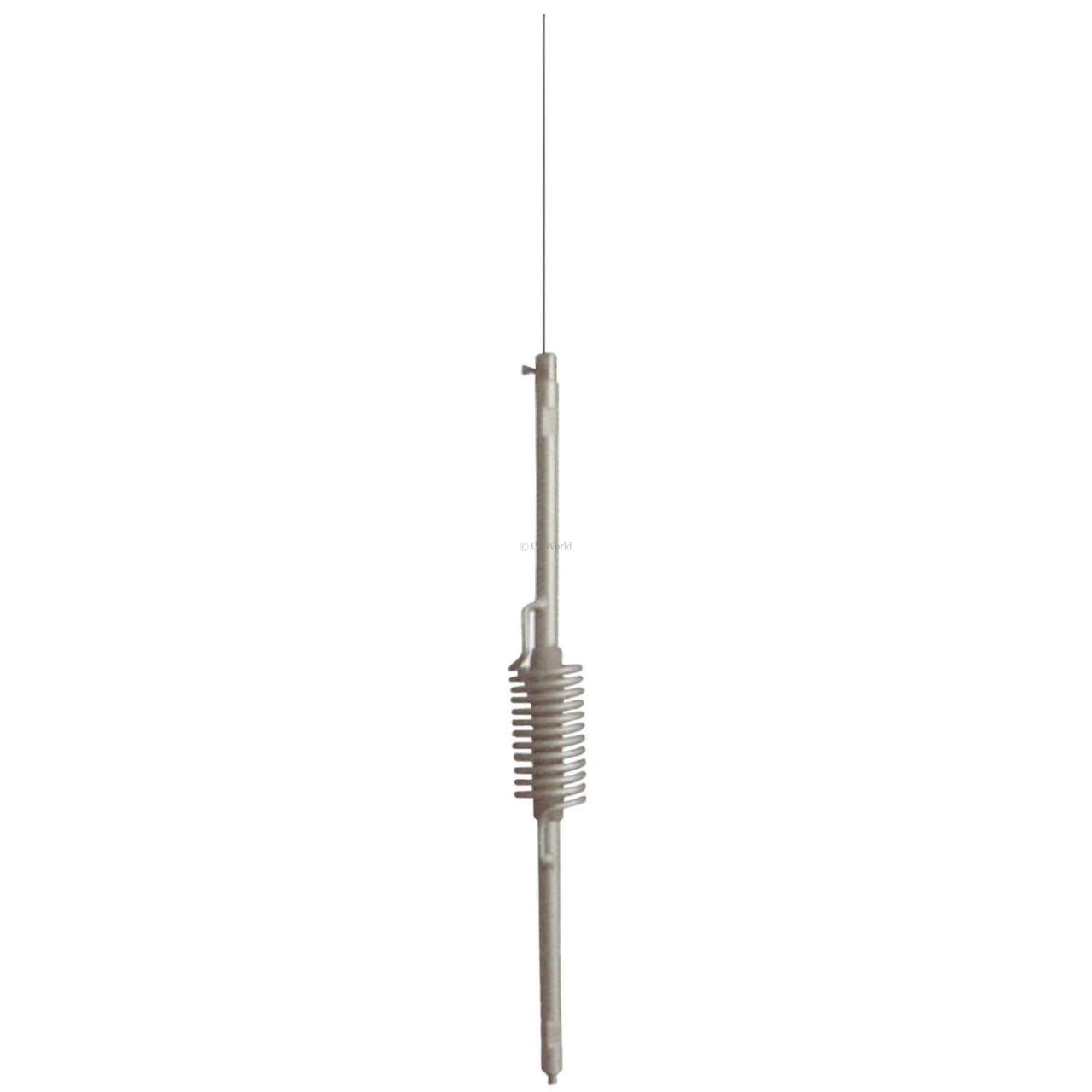

    Its not the factory antenna or coax. Its mounted to a grab handle on the back of the cab between a headache rack with maybe 2 feet above the cab probably 5 feet overall. It's one of those with the coil around it about halfway up and then drops to what looks like a stereo antenna. It was already on the truck when I got it.

    i wonder if that is a HAM radio antenna..???
    or, it must have been tuned for a higher powered (linear) cb radio set up?

    Ok inverter off took care of the noise. How do I get rid of said noise? Better coax?

    that antenna, is for a high tuned, amped up cb radio.....
    some will say it can broadcast/receive better than an ordinary cb antenna......even if the cb is not amped up.
    you "can try" one of a few radio interference filters and install it inline to the power cord of the cb....some work, some don't.
