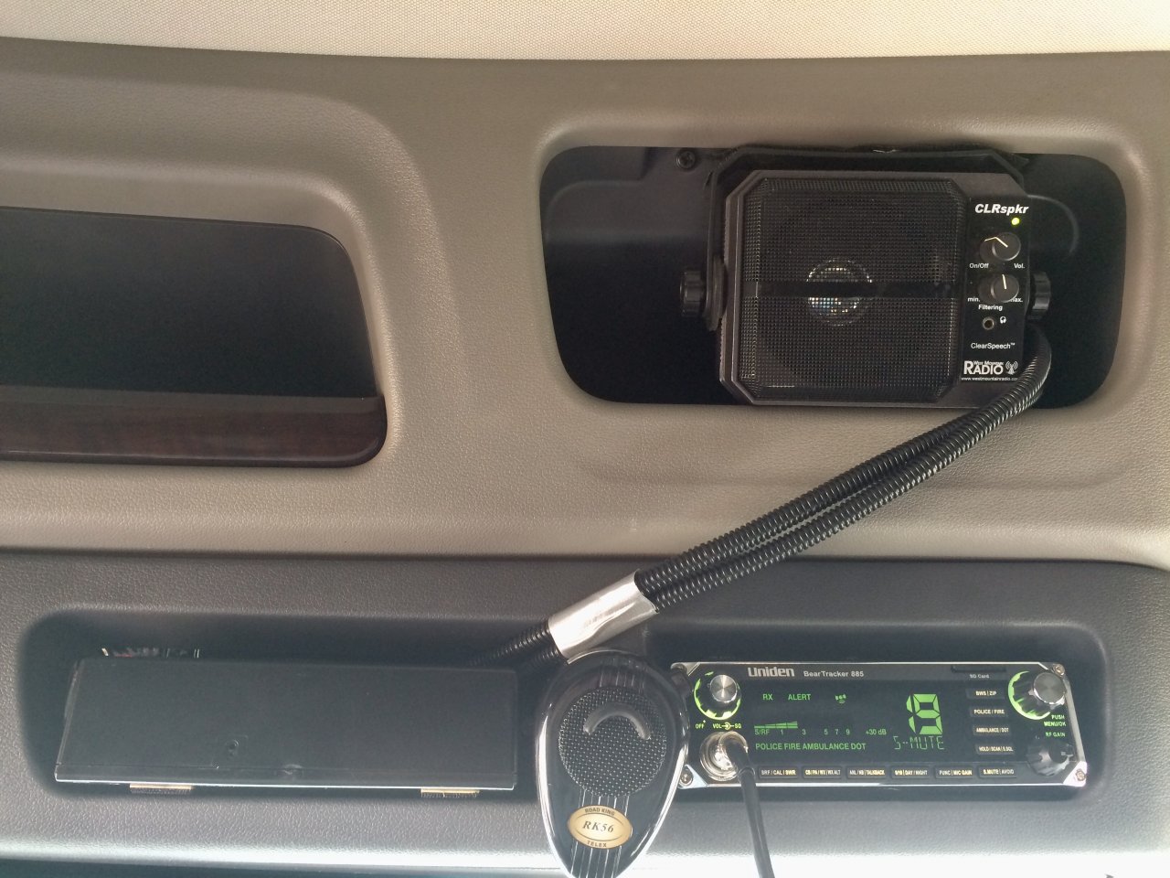

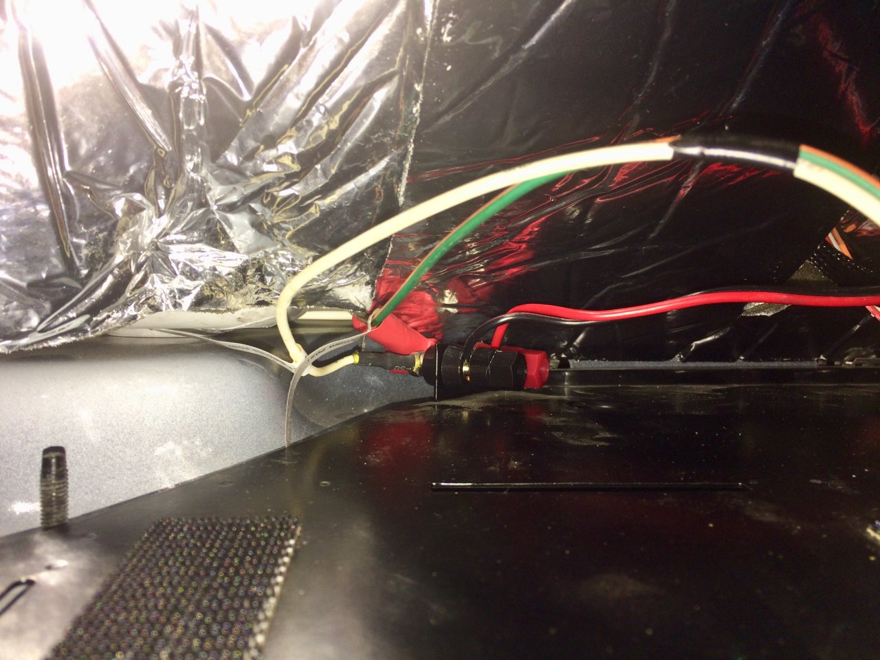

    2B7D004B-2AC5-422A-AC0D-D2AD94339CBB.jpeg 4E469BD5-E00A-4931-AB5B-ACCCE38C2A02.jpeg I’m also in a 579. 2016.
    Top pic is of factory binding posts.
    Those posts in left cubby rear in second photo.
    x1Heavy and Lysdexis Thank this.

    This is as it stands currently:
    1). UNIDEN Hybrid CB/Scanner
    2). RM ITALY KL203 amp (70W)
    3). West Mountain Radio ClrSpkr
    (Digital Signal Processing) External Speaker.
    Everything runs off of those binding posts. A 15A circuit.
    Is there electrical noise from the truck? Yes.

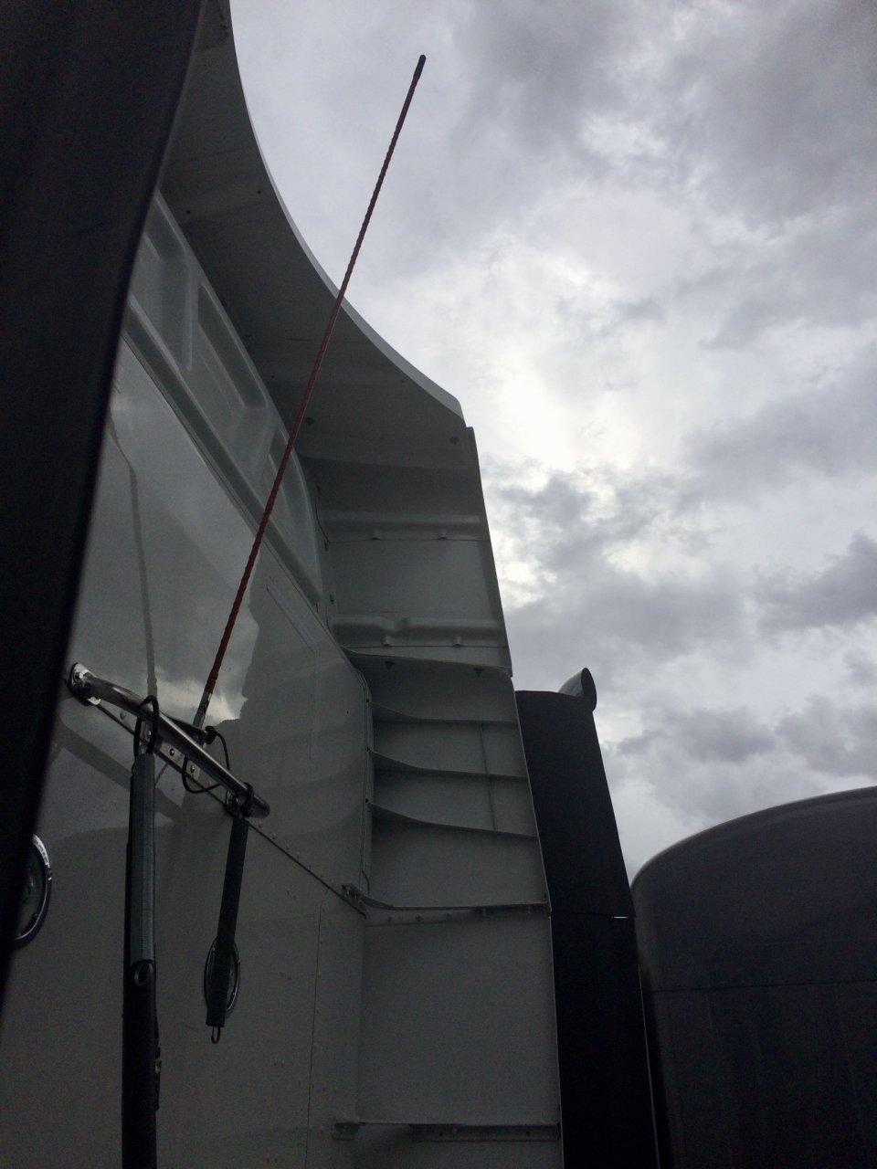

    Have had 5.5’ Francis, 5’ Fitestick and now a 5’ Skipshooter on a 5” spring (not shown). Factory tab mount.
    Coax end bad, maybe it’ll get fixed (was waiting to find out how long I’ll be in this truck).
    The amp will get you heard, and the speaker will let you hear.
    It’ll clean up a tremendous amount of noise. You’ll listen to signals you couldn’t distinguish before.
    Was eastbound out of ATL today (NE) on IH85. Near the SC line had a guy 14-miles ahead reporting a problem. An impressive radio rig, sure.
    And the clarity was all anyone could ask for.
    Keep on, OP with checking basics. Just remember that a DSP Speaker helps tremendously.
