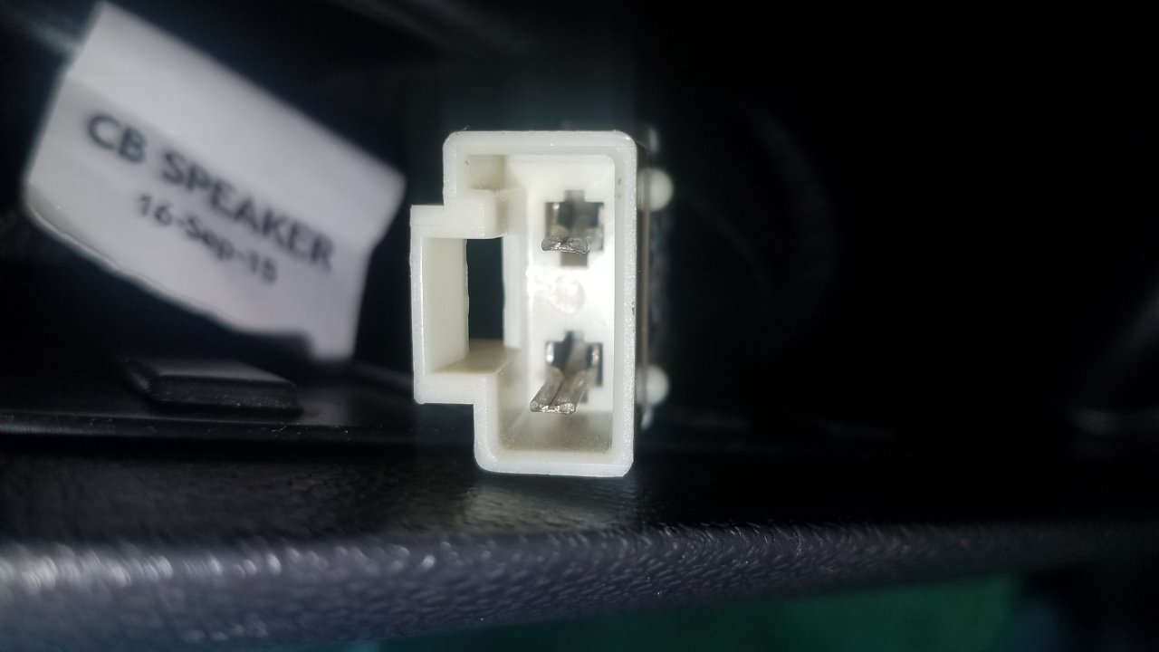

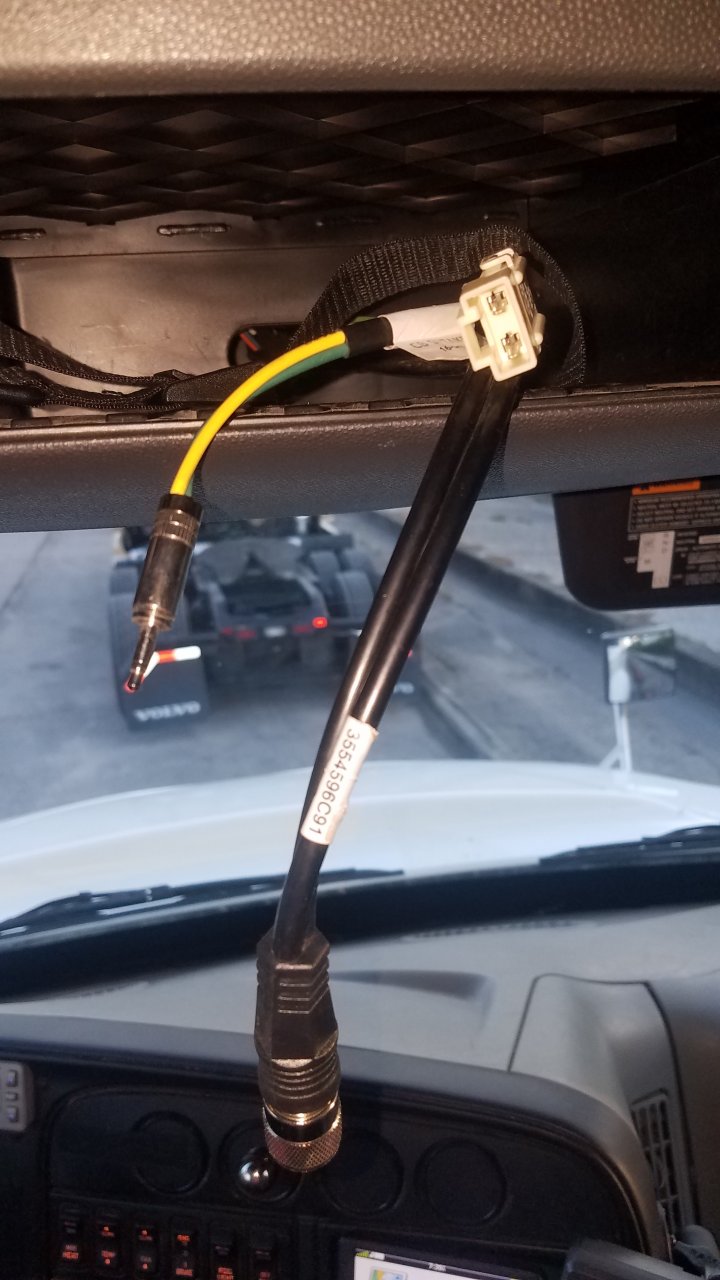

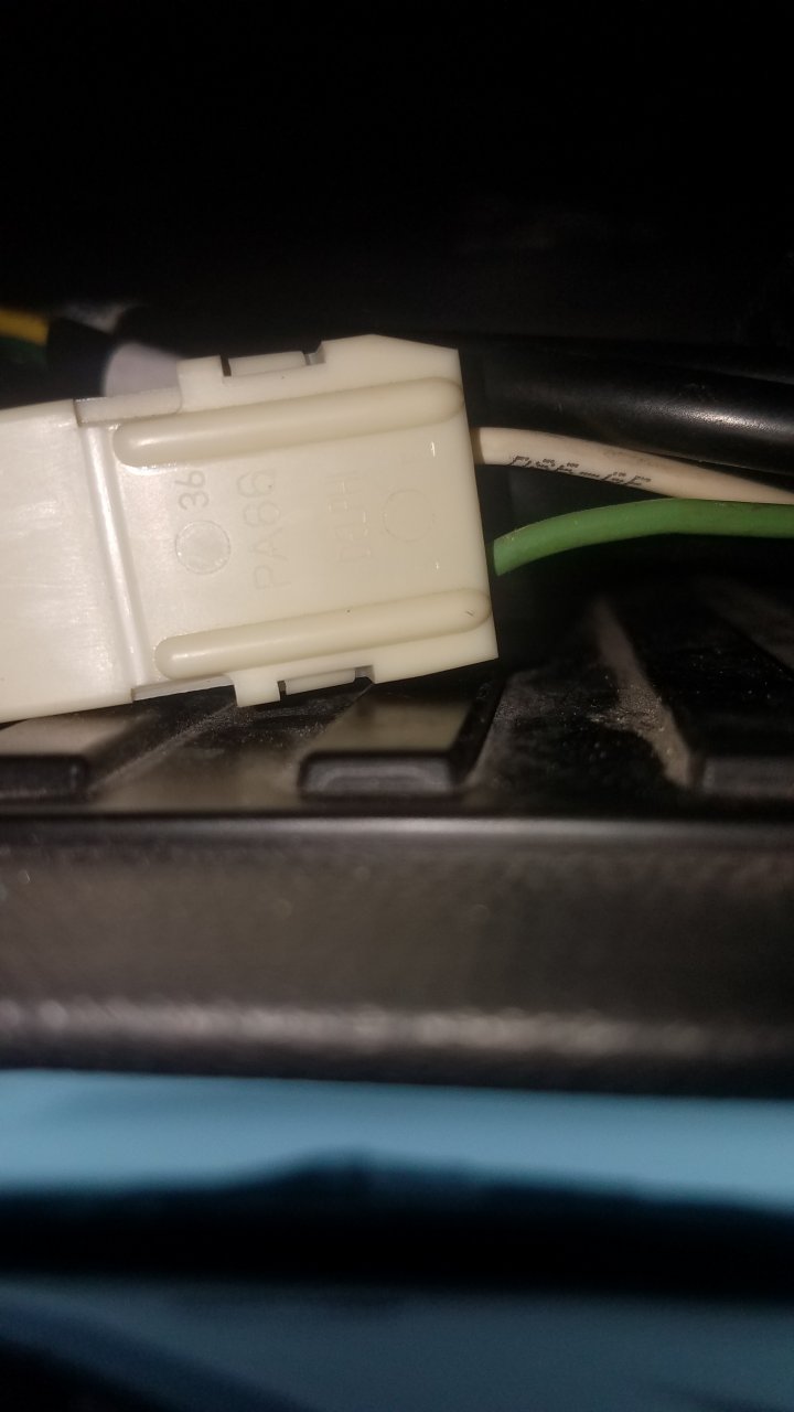

    20180806_193927.jpg 20180810_163752.jpg 20180810_163844.jpg I Have a Cobra CB. Three prong is needed on the CB end obviously. I have an International semi. It has a power sources available but I cannot find a plug with this end.

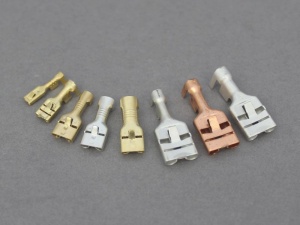

    The truck should have come with the other end where you plug it in and just splice your power wires to it, feel around up in there and double check. It will have labels for power and ground. It may be something you have to source from International unless you can solder or crimp terminal ends onto your power wire and put them into that plug. Simple fix.

    Cheapest quickest fix is to go to Home Depot, Walmart, etc and put the right size ends on your red and black wires from your power cord. Just make sure you put positive and negative to the right terminals so you don’t reverse polarity and blow the fuse in the radio power cord.

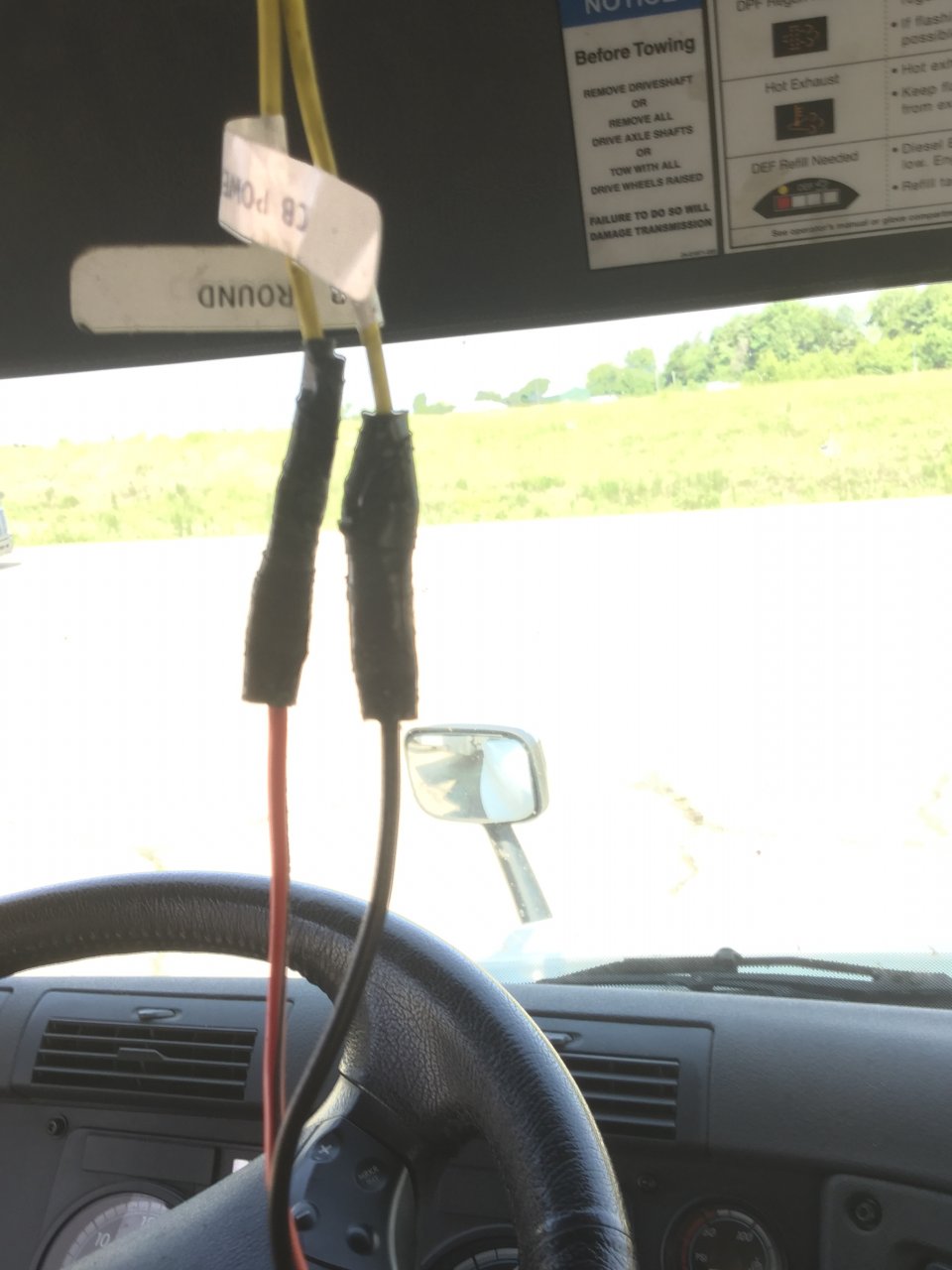

    My 2018 & 2019 Freightlinerboth have that white plug. Connected to it is a compatible plastic plug that ends with a red and a black wires, approximately 1-2 inches long.
    I would use a voltmeter to determine which of the wires going into the white plastic plug are positive and which negative. I'd cut off the plastic plug and use twist-on wire connectors to connect the wires from the truck to the wires to your CB.
    If you cut off the plastic plug, cut one wire at a time. If you try to cut both wires at once you will short out the fuse. Mark at least one of the wires "positive" or "negative" before you cut either wire. If you connect power wires to your CB negative to positive, or vice versa, you will cause minor damage. I think when I did it I blew a fuse. It was easy for the radio shop or me to fix whatever I damaged.
