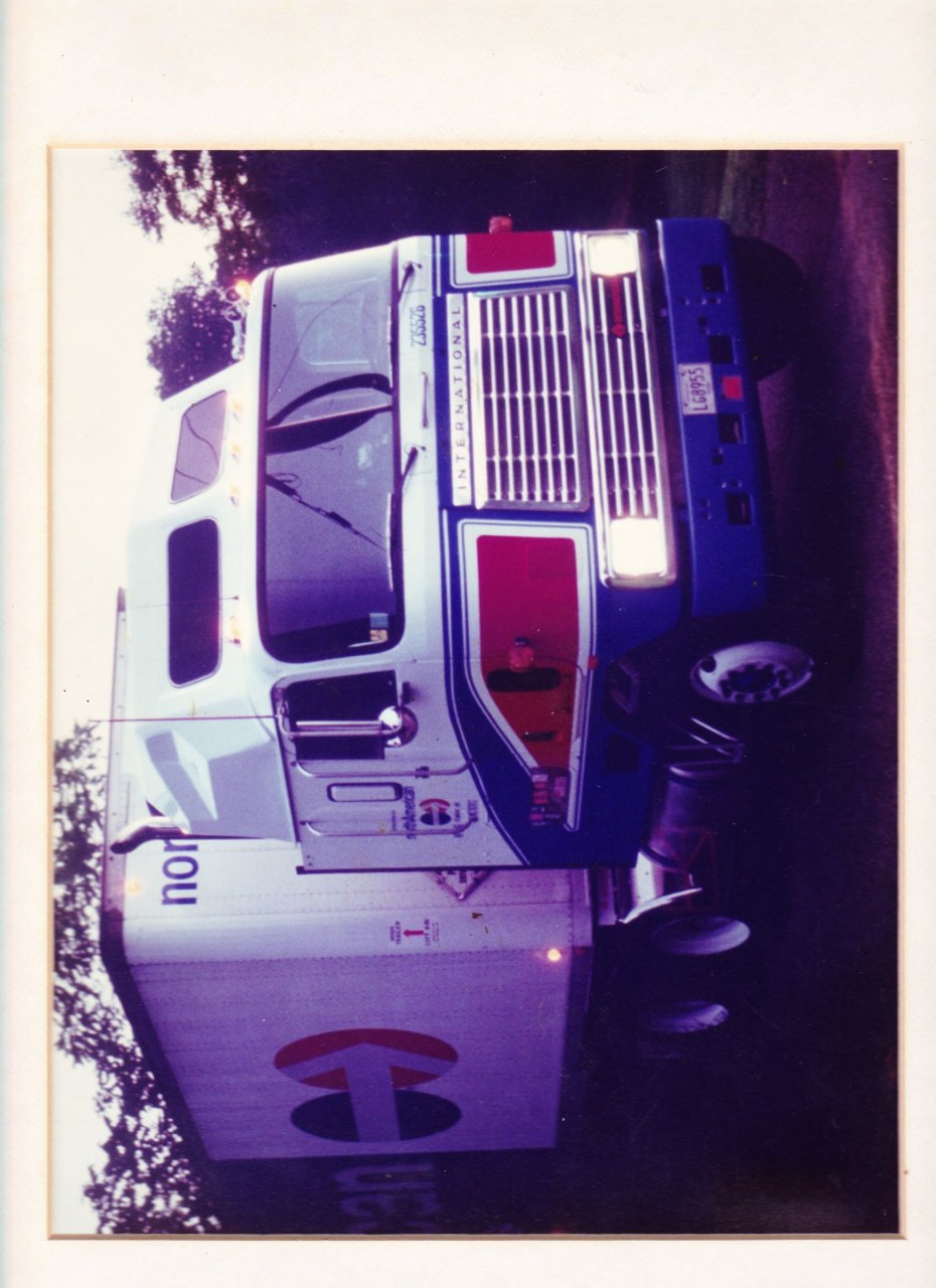

    My 9600 with Remora Topper rz.jpg I had a 1984 IHC flat top which I bought new, and had this top put on it in 1986:
    Of course this sort of thing is simply not done now. You would never be able to find a roof section to fit. You didn't specify if your tractor was an 88" cab or a 110" cab.
    All of the high roof cabovers made were 110" cabs both for IHC and Freightliner after about 1990, so grafting a new roof is difficult, finding one nearly impossible. You could have a shop cut your roof panel off, add a 12" extension, but if you remove the bracing the cab will fall apart.
    And this modification leaked like a sieve. I traded the truck off because of it.

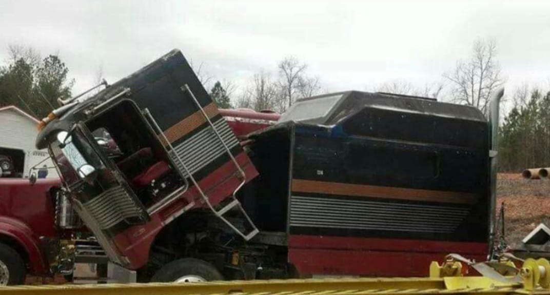

    All the COE's I owned, the entire cable jacked up to expose the motor. That would take some engineering to get 90" more to rise.
    Or do you keep the sleeper on the frame and have a leaky boot after a few months?
    I'm asking, because I don't know.
    Oxbow Thanks this.

    I'd like something like the pics included.
    Oxbow Thanks this.

    Good luck. Plenty room there to spread out.
