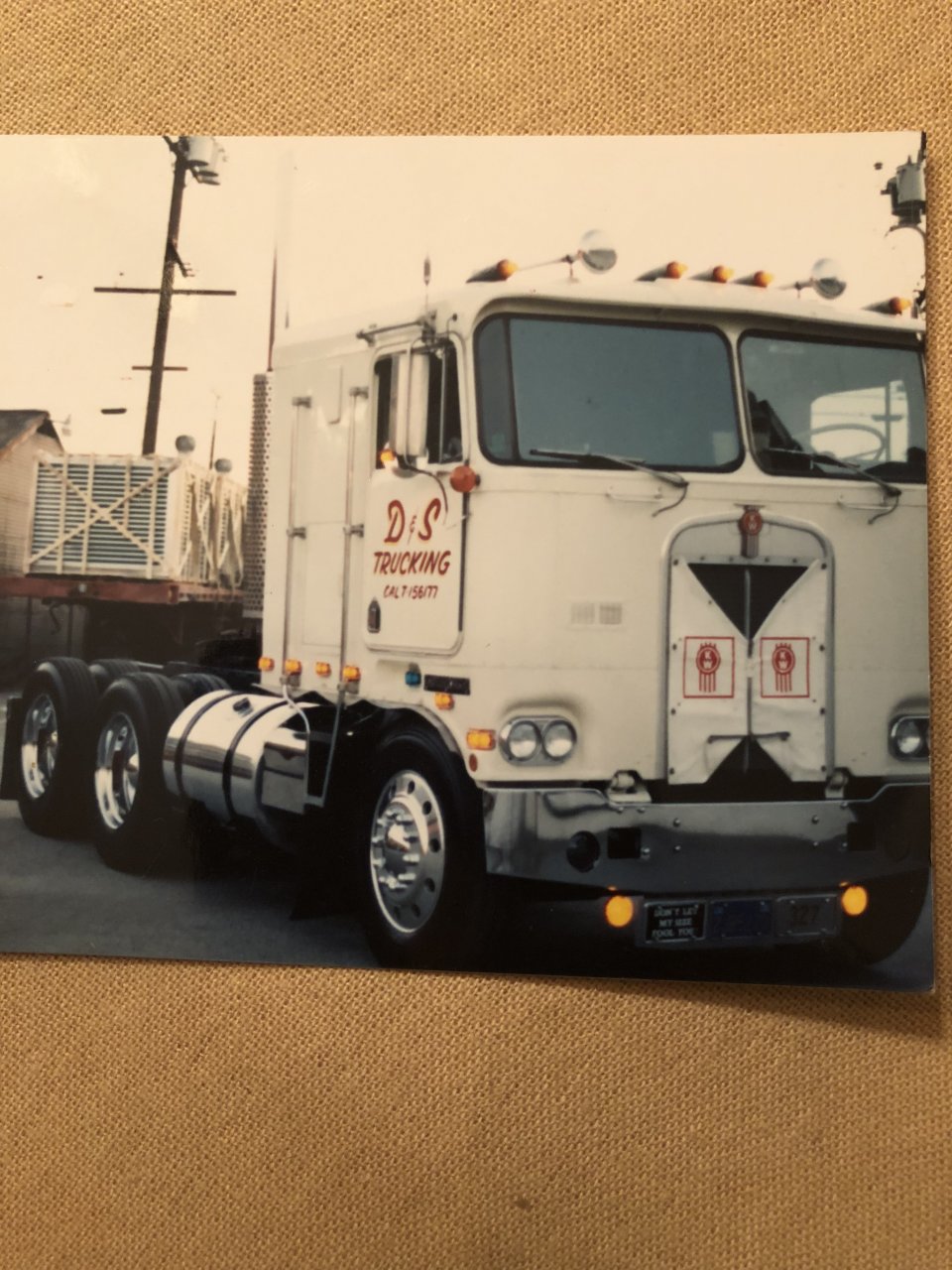

    A816734E-D72E-446E-AD45-60E02FBABE71.jpeg Are old COE’s really worth that much ? My son told me they where. I have a 1979 KW K100. All complete. I parked it when I bought my 379 11 years ago.

    Great looking 79 you got there... what engine?

    Cummins 350 BC1. CPL 369. It’s not stock either.
