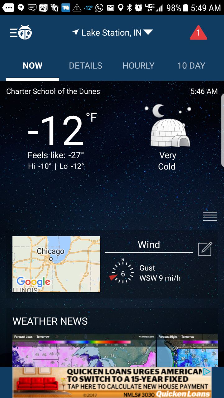

    I started the truck on Christmas cause I was planning to leave on Tuesday. It was around 17°, but Tuesday was around 9° and it wouldn't start. I rented a generator and plugged it in for a few hours, but I wasn't sure if the block heater was working, so at -2° I said forget it or some other word that began with same letter. Friday was supposed to be low of 11 and a high of 14. I figured it would start then, and it did. Running since then except for a 7 hour break on Sunday when it was back in the teens. This is it starting on Sunday and apologies for the poor video quality.
