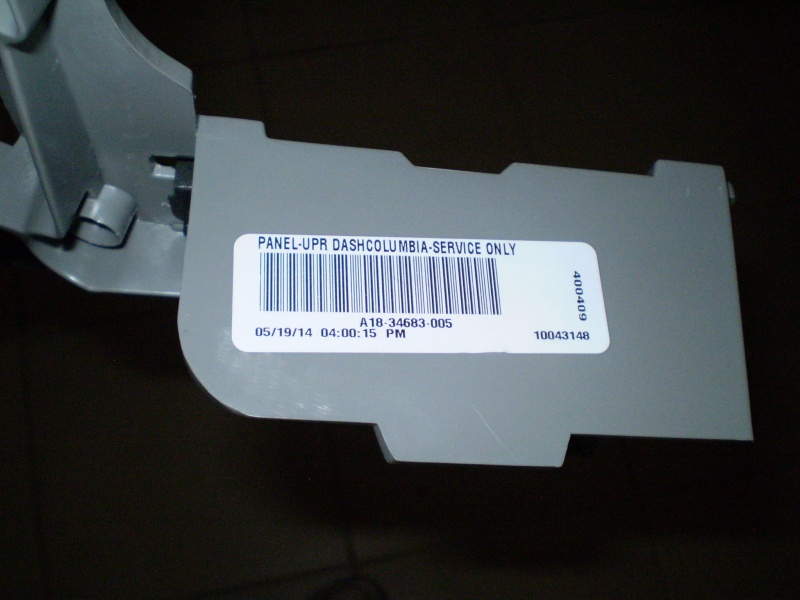

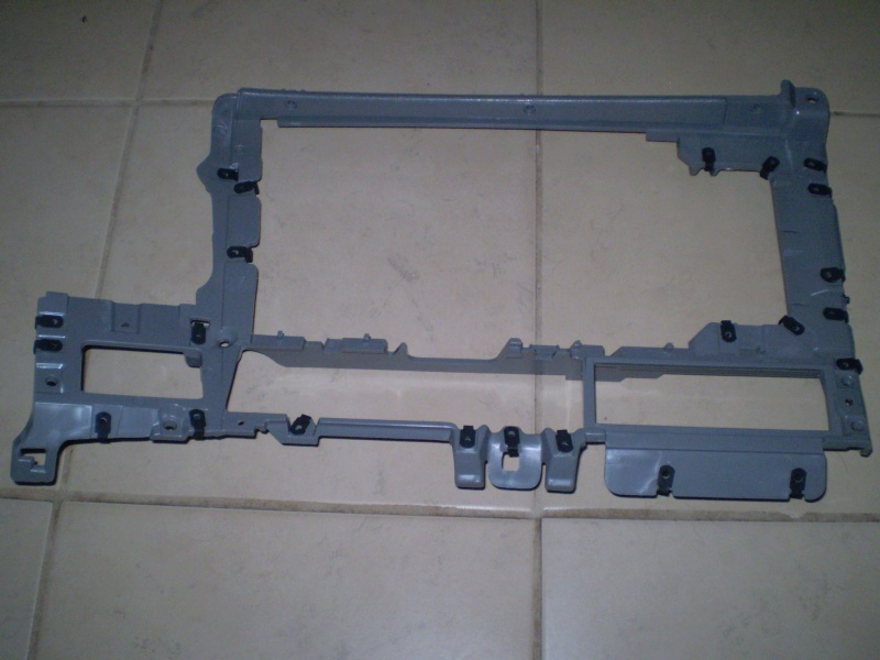

    The dash frame was $100.00 I got mine from FL, the frame in my mine was all busted up into about 20 pieces. I think the all the brake setting from the PO had done most of the damage, but when the radio fell in, had to do something quick. The dash frame replacement was pretty basic, but the outer dash panels had to come off around the bottom of the cup holders and around to the glove box, as there a few hidden screws in there. So much nicer now! Nice and solid now. And I always hold the dash with my thumb when I pull the brakes
