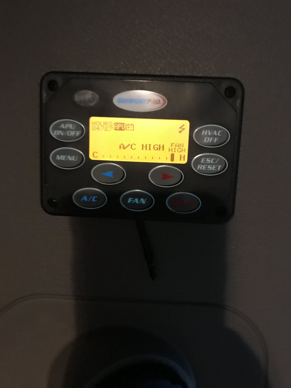

    So I moved into a new truck...never had an APU I know nuthin about them. What I do know is this one doesn't get cool lol. Question is how do u stop it from starting up. It starts about 5 mins after I kill the engine. But past few nights it been cool. Widows cracked ,vents open and little fan is fine. But APU always kicks on. What do I do?

    Push the blue arrow and turn that temp to cold for starters. If you want to shut it off, just push the apu off button on the top left.

    Some apus have a battery minder which will kick on to keep batteties charged. The main menu options should allow you to shut of battery charging. If it isnt sending cold air out of vents, it needs servicing. You can prob download operating manual online, just search for carrier model number operating manual.

    Sounds like you have the battery monitor set to on. When the truck's batteries drop below a set voltage point (which you can adjust by the way), the APU is kicking on to recharge the batteries. You can either turn the monitor off altogether, or set the threshold lower so the APU isn't kicking on as much.

    I also have a ComfortPro apu and yes the manual is available online. Also that little battery symbol up by your hours meter means batter monitor is on. These guys have good advice. Either shut that off or lower the setting. Mine is at 11.8. Also I couldn't help but notice you have your AC on high but the marker pin is all the way to the right. That H is for Hot. Drop that sucker down to the left on C for cool and that might be your fix.

    @Treputt @motocross25 i think u guys were rite I put the battery monitor On off I think it stopped. Lmao I know c was for cold I was messing with it when I took the pic. I think it may need service tho it's not too cold. I just wanted it to stop goin on all the time.
