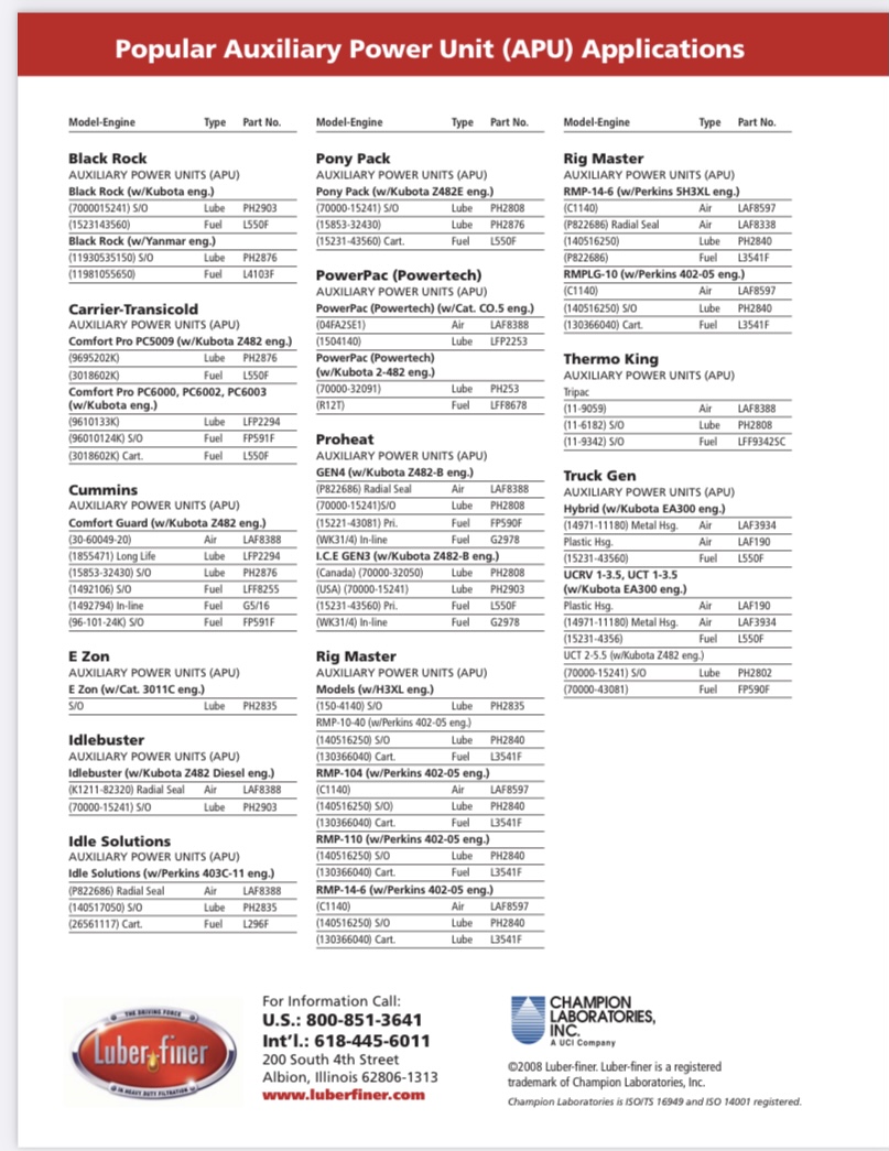

    Question about the oil filter on a Comfort Pro. My unit is now out of warranty so I'm going to start doing my own maintenance. The problem is I can't find the oil filter. I'm trying to find the part # for an easily accessible brand I can pick up at my local auto parts store. Does anyone know which AC Delco, Fram or other brand like that would fit my unit? It's a 2016 model with 14 hp Kubota.

    You can buy the whole service kit
    Oil, both fuel and air filter for like $40.00
    I am not aware of a cross reference for oil filters
    I but the service kits in bulk as my apu gets serviced every 500 hours, comfort pro

    the fleet I'm leased to uses the Luberfiner finer filters on our carriers and they get them from the kenworth dealer in omaha .

    Fleetpride will cross
