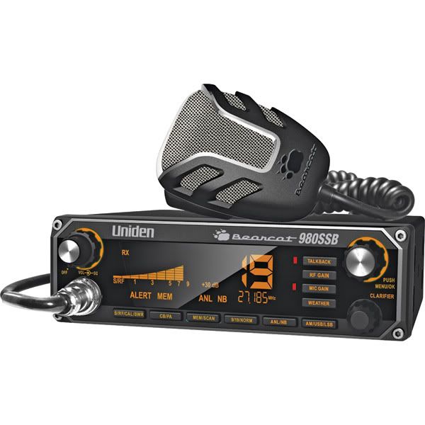

Nice looking radio .....
Product Features
- Stay connected on the road with this CB radio
- Great for people with long drives ahead of them
- Orange display for easy reading
Technical Details
- Brand Name: Uniden
- Model: BEARCAT980SSB
- Item Package Quantity: 1
![[IMG]](proxy.php?image=http%3A%2F%2Fi1230.photobucket.com%2Falbums%2Fee495%2Fold_school1%2Fbearcat980ssb.jpg&hash=1a5a364db878072de02b3fa7b7deb5a8)
According to the product features it come in orange only.... Can you please show me where the day/night button is on there??Last edited: Apr 26, 2012
What i ment to say was you loose the RF gain in the sense of a knob control
More then likely on the menu knob.
I assure you the 980 will have the same display color options as the 880.
