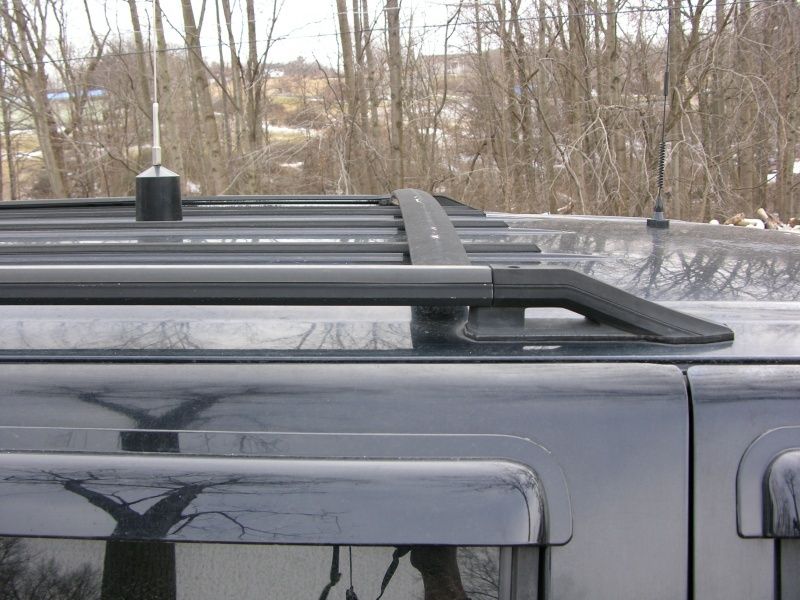

  9. rabbiporkchop
    9,678
    6,545
    Feb 9, 2012
    Wapwallopen, Pa
    This antenna made this possible. Any other mounting method won't come close performane-wise, except for the ball mount, maybe in a single direction towards the drivers front fender. Nothing beats the roof.
    Everything else is drastically reduced performance.

  11. RockinChair
    RockinChair Road Train Member
    5,352
    14,273
    Feb 19, 2012
    Lubbock, TX & thereabouts
    What kind of mount is that? I'd like to get one for my pickup.
