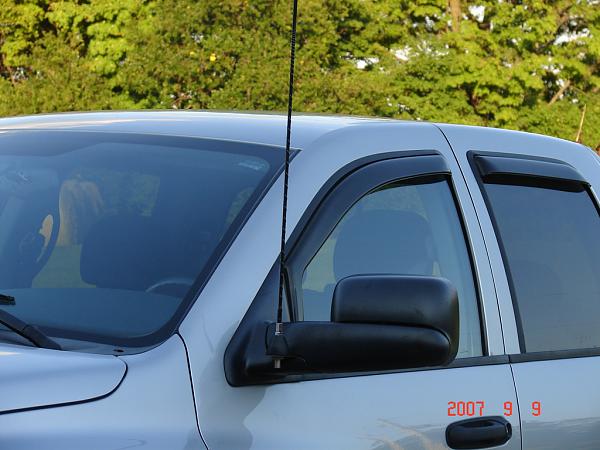

    So with what has been said i guess i will go for the mirror mounts instead of behind the cab. When the flatbed finally happens I will move them to there so they will be higher up. I know I have said that wilson antennas would be my choice because of local a local source and being able to get them same day so to speak, however since i have to order the custom mirror mounts anyhow Im not opposed to other options like ordering from amazon. Earlier in this thread Sirio antennas were spoken highly of , has anyone else got any other suggestions to look into?

    The larger the metal surface under the antenna the better it will work.
    My roof being 7 feet long and 6 feet wide, will talk much further than a bed rail 1.5 inches wide by 5 feet across, or a mounting bracket 2 inches across.
    Larger mounting surface determines performance.

    Now that makes sense to me now. Thanks for the explanation. This is what i had in mind

    If you could get 2 of them and separate them 102 inches from each other then you wouldn't really need a flat metal surface underneath them in order for them to work very well but accomplishing that on a pickup truck is very difficult since the body is so narrow.
