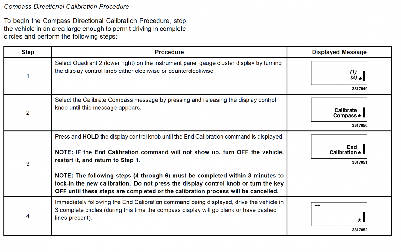

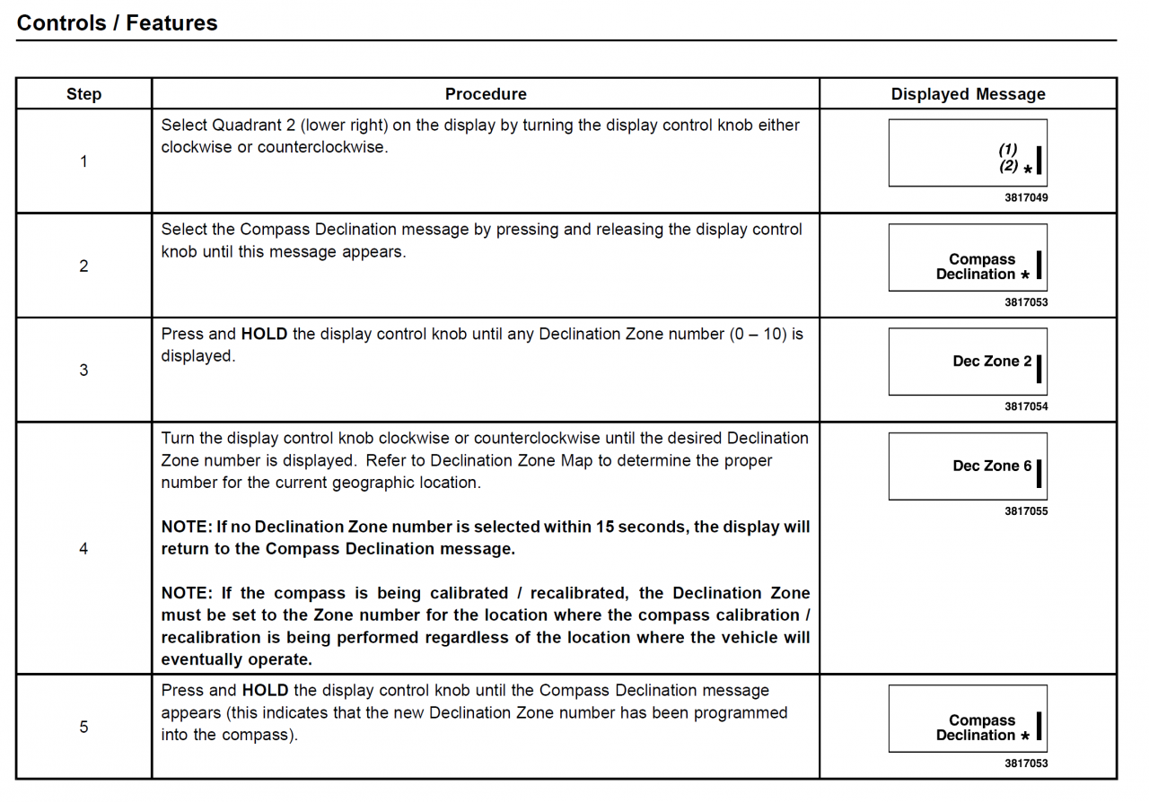

    This is from the owners manual.

    Try driving around in circles in an open lot, that's how you used to calibrate them. I know it sounds crazy.

    Yup, that did the trick. I followed the directions then drove in a circle lol
