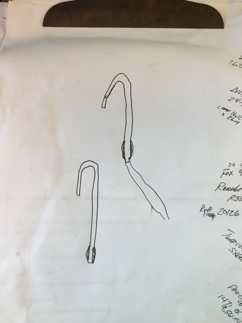

    Depending on what system you get, the setup will be a little bit different as far as the latching and roller mechanism goes. We have 4 different systems by Conestoga and they change things (for the better) every couple of years. The newer ones take 1/2 the time and effort to open/close than the older models.
    As far as a tip- if you use the 4" straps with the flat hooks, crush them down -it makes them easier to pass thru the bottom rubber weatherstripping without getting jammed up all the time image.jpeg

    True- passing those hooks thru can be a pain in the dick, especially if the rubber is cold and brittle. Just doesn't want to spread open.
