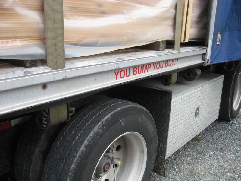

    Maintenance is minimal on them. Just keep rollers lubed and like you said, keep people off the rail w hth en getting unloaded and loaded and you will be fine. Once you have one you will never go back to regular flat again.

    The maintenance isn't bad. keep in mind you cant haul tall loads like lumber or insulation. You also can haul over dimensional or i beams that need to stick off the front. You may even not be able to haul sheet steel that is 102 wide. The biggest maintenance i'v seen is replacing the tarp pieces and arms when they are backed into. They get damaged a lot easier then the rubrail on your flatbed.

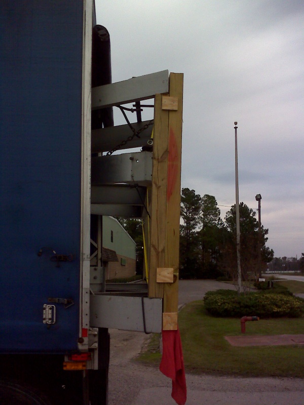

    Ruthless,have you taught about a way to use the Roll Tide open?
    It would mean you being more flexible in the loads you can do.
    And it is not as difficult to realise as you might think.:biggrin_255:
