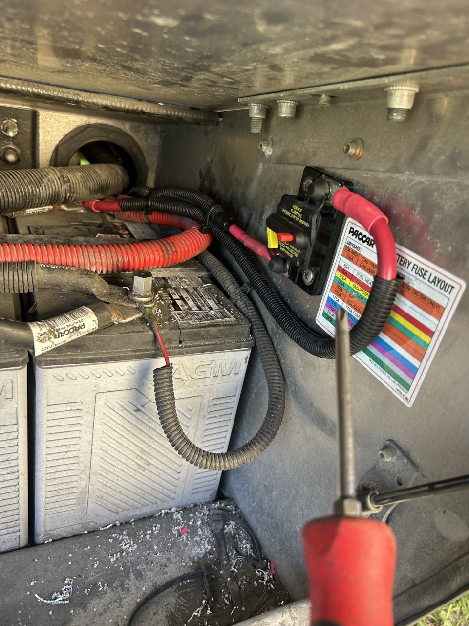

    IMG_4607.jpeg IMG_4600.jpeg IMG_4603.jpeg IMG_4608.jpeg All my radios do well I can pick up skip heck I even did a little skipping with my Lincoln 2+
    I just like the sound of the big radios I run two Wilson 2000 antennas I have low SWR on channel 20 I have 1.2 SWR I also ran the bigger power wires up someone had suggested some time ago that I should do a voltage drop test. And IMG_4600.jpeg with the small radios and would drop 1.2 volts when keyed up so I ran #6 wire to the top.
