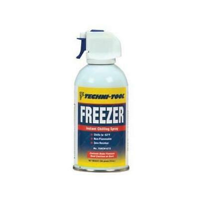

    Get 'er warmed up and then use freeze spray in different areas of the board. You might get lucky

    Techs have to be clueless.
    Get some of this and go through section by section with it,
    Timin770 Thanks this.

    Its a tool for sure, but so is a heat gun, and a BFH. tap tap..
