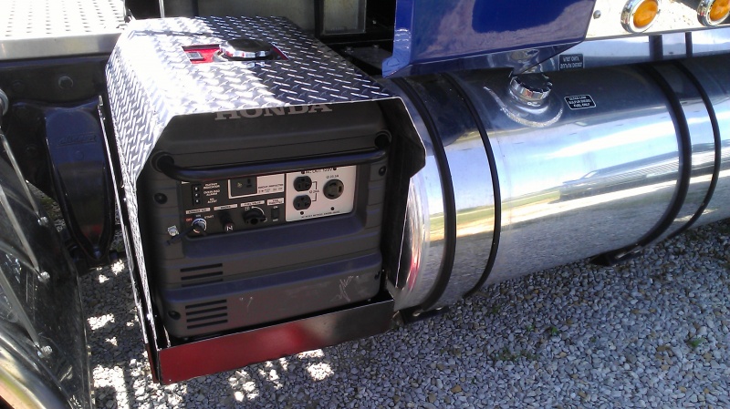

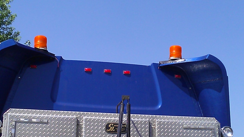

    Got the strobes all mounted today, on brackets that slide between the fairings and the sleeper wall at the top corner, then come around the top and into the rear face of the fairings. Those tall strobes look mighty small up there though!
    Also got a few other jobs done.
    Generator L brackets made and painted, tray for the generator also all done.
    Flag brackets mounted behind the front bumper
    Extending mirrors mounted to the main mirrors. No way of those looking "good" so to speak, but a legally required, so not a lot of choice.
    Let my 16yr old weld on some side bracing today, made me proud! Non too shabby for a 16yr old in my book.

    Still need to make a door for the generator, but the only off cut of diamond plate aluminum they had just did the cover, so it will wait I guess. Stuff is NOT cheap! Brackets are 1/4"x4x4 on the rear side, where the cutouts are for the suspension, other side is 3/16x3x3. Tray that the generator sits on is 1/8" steel with a brake for the front,rear and sides. Will get slides again when time permits, as well as the diamond plate door and a gas cap cover.
