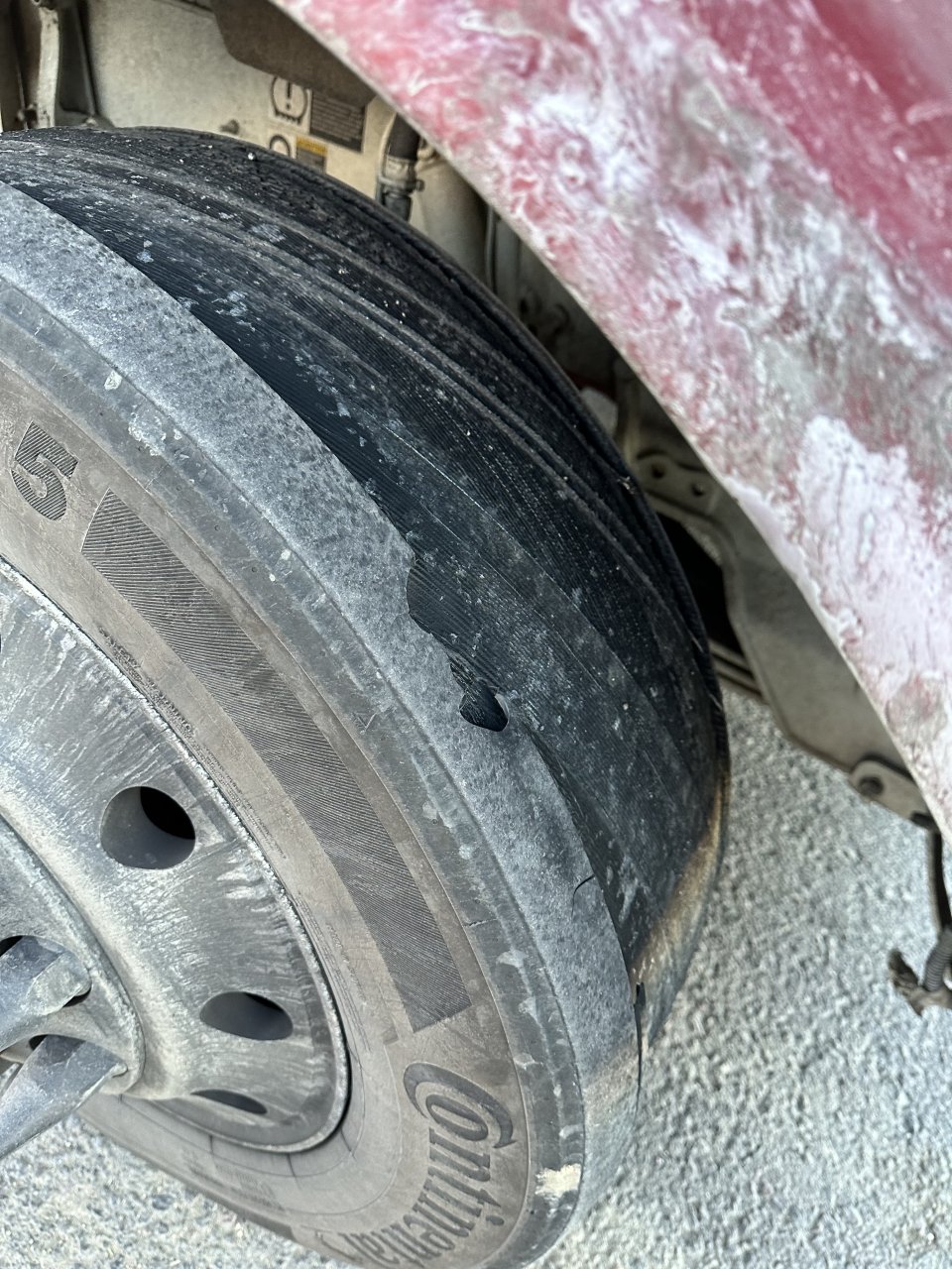

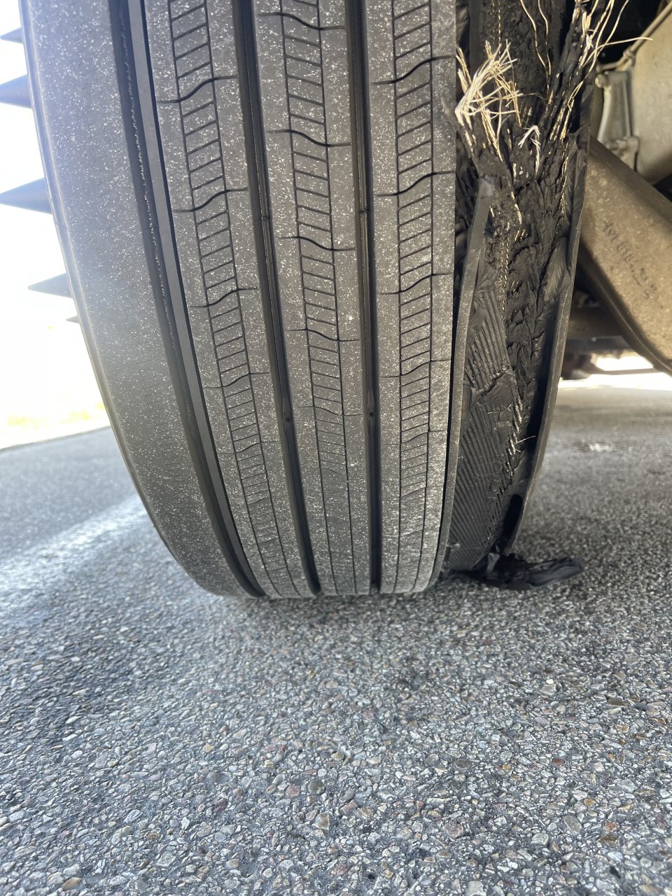

    [​IMG] [​IMG] I would stay away from that tire. My 23 Pete high rail, came with these tires from the factory, and they lasted roughly 100k. Thinking, this is really good, I decided to get same set. 27k later, my passenger steer did this. Purchased another set, same Continentals, because they were the only tires available where I was in WY. 17k later, same passenger tire, that I got in WY did exactly same thing, damaging my hood.Only Michelins now. They were HS3

    That is why I quit using Michelin on my steers. Blow out at 65MPH empty with the Michelin. I am 5 sets in now on the Continental’s and they are working great for me.

    I think you might have something else going on besides the tires. I'd have everything checked out very thoroughly. I've never seen one Continental steer blowout and you have 3 in that few miles. I'm not saying it couldn't be the tires but what are the odds.

    not the tires fault. You need to get alignment done on new stingers. Don’t trust the factory alignment
