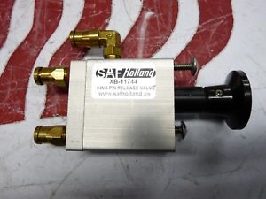

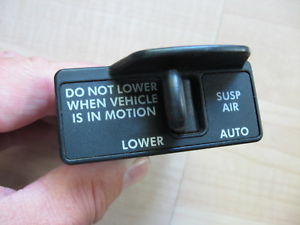

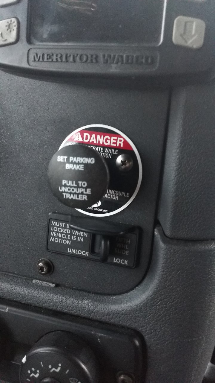

    I have exacted my research I can't seem to find the answer I'm looking to convert my fifth wheel air kingpin release valve in cab to hand pull and use existing pluming to get air bags dump I understand I need level valve with dump and a switch in the truck but as far as fifth wheel do I need to remove air cilinder or leave everything as is and just use the air line connect it to dump and install switch in cab the picture is the one I have installed right now the other pic are the things I need is there anything else I need

    I thank you have to buy a different plate. Call a Holland dealer with the numbers off your plate. Ask them to call you back as it could take awhile.

    The truck has one but I can't pull it cuz it's locked with air cylinder I have to drain the air or pull valve in cab when parking brake is set
